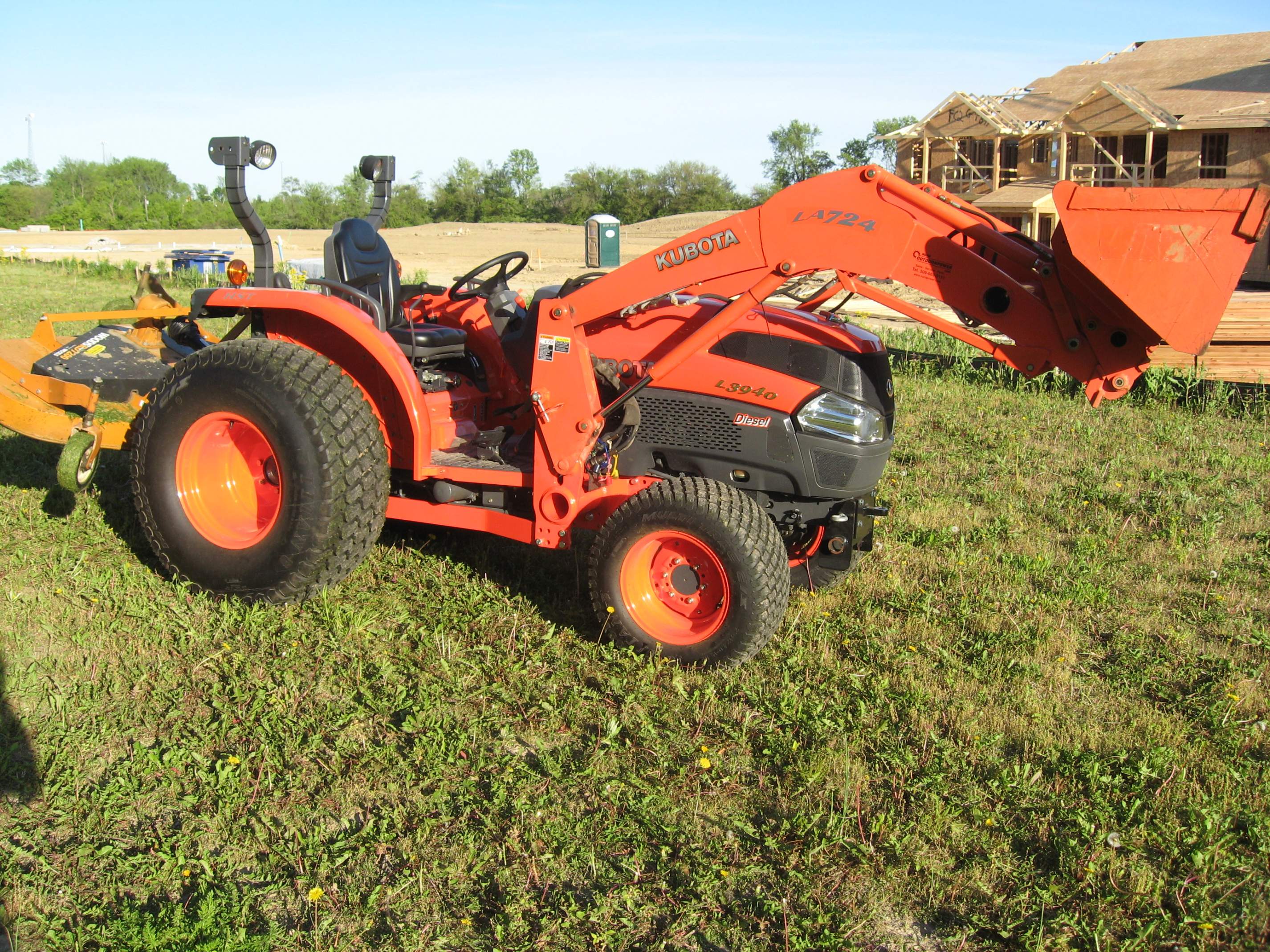

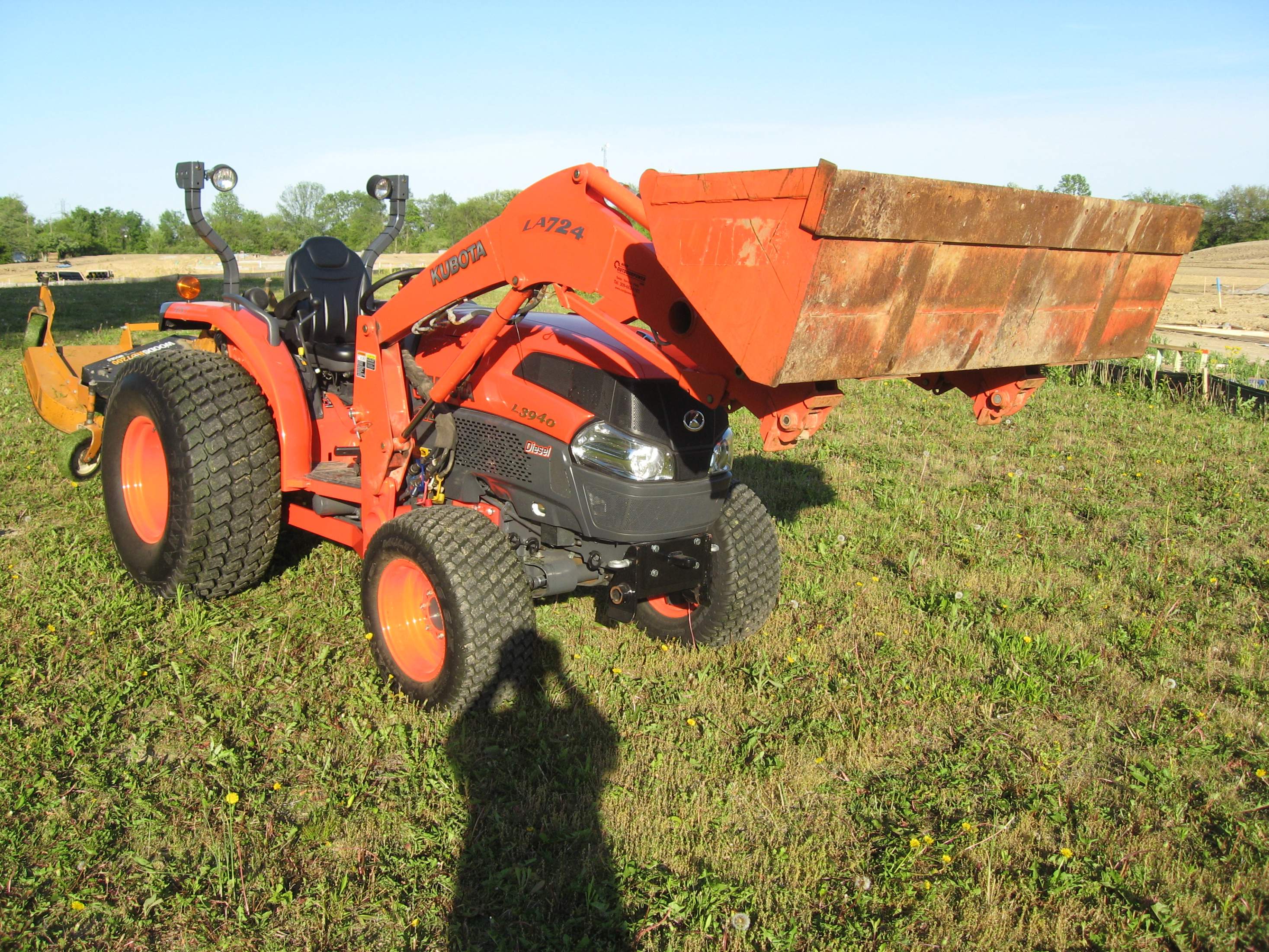

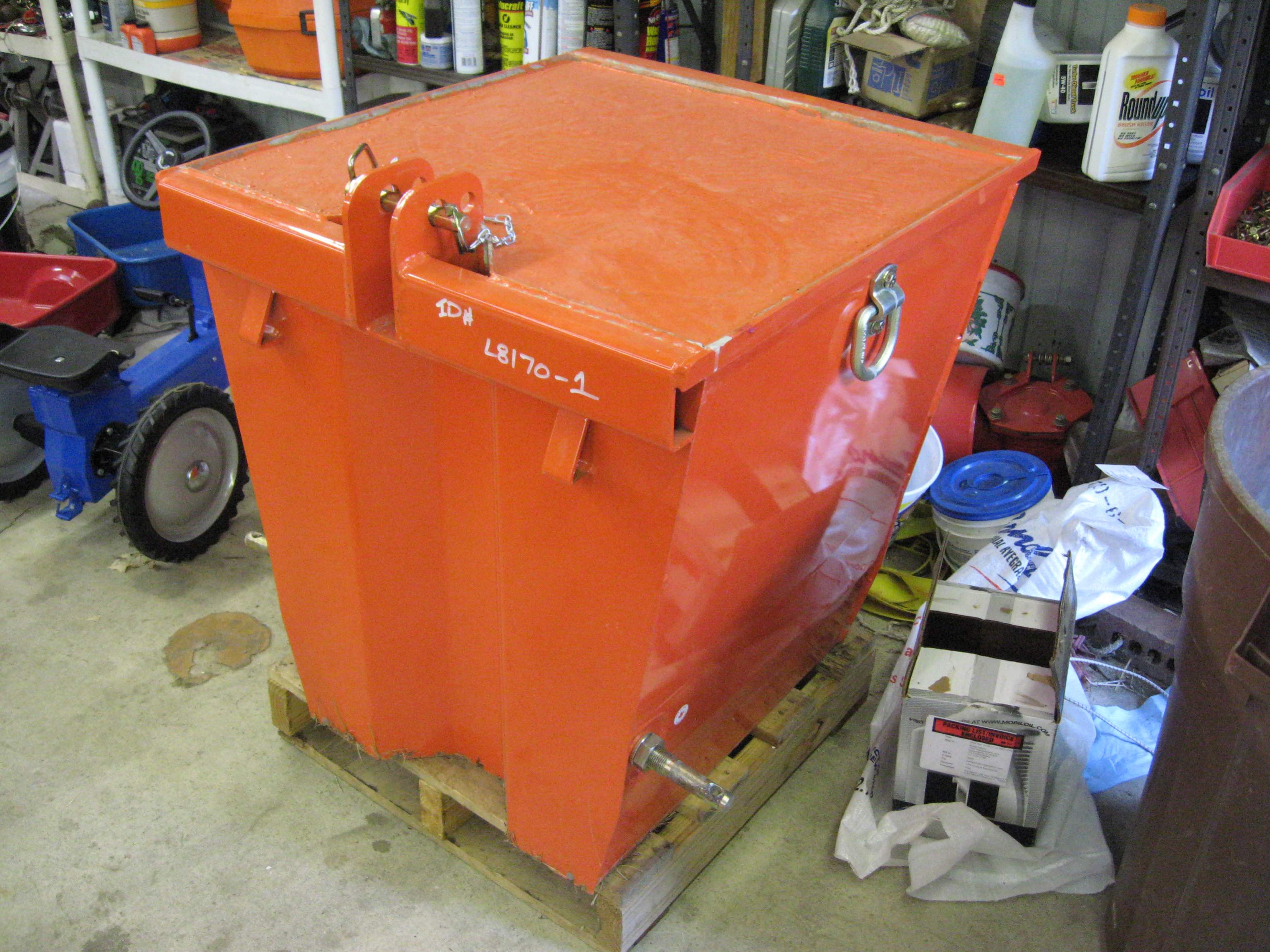

I have moved heaping buckets of dirt, rip rap, and snow with my L3940/LA724/HD bucket, and have never had a problem lifting or transporting. I have always had some sort of counter weight on the back, box blade, pulverizer, or ballast box. I think you would run out of bucket capacity (ft^3) before you ran out of lift power. God bless the old Fords, but the newer CUT's have way more capability than tractors and FEL's of 50 years ago. Do you know what year and model of Ford tractor your friend has? Philip.
