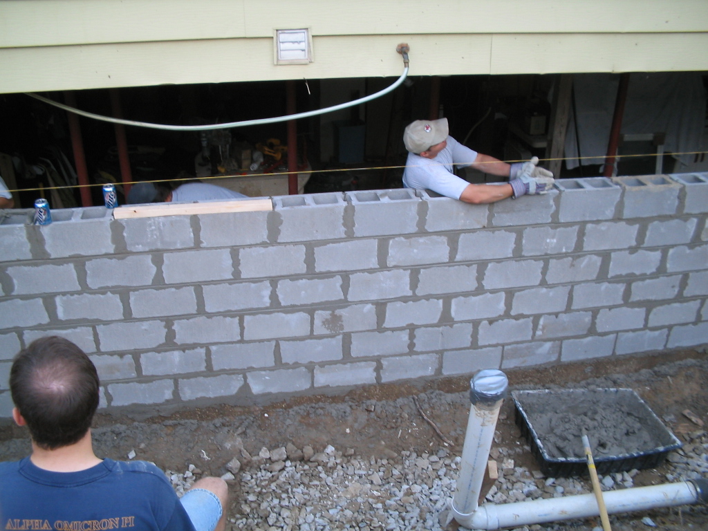

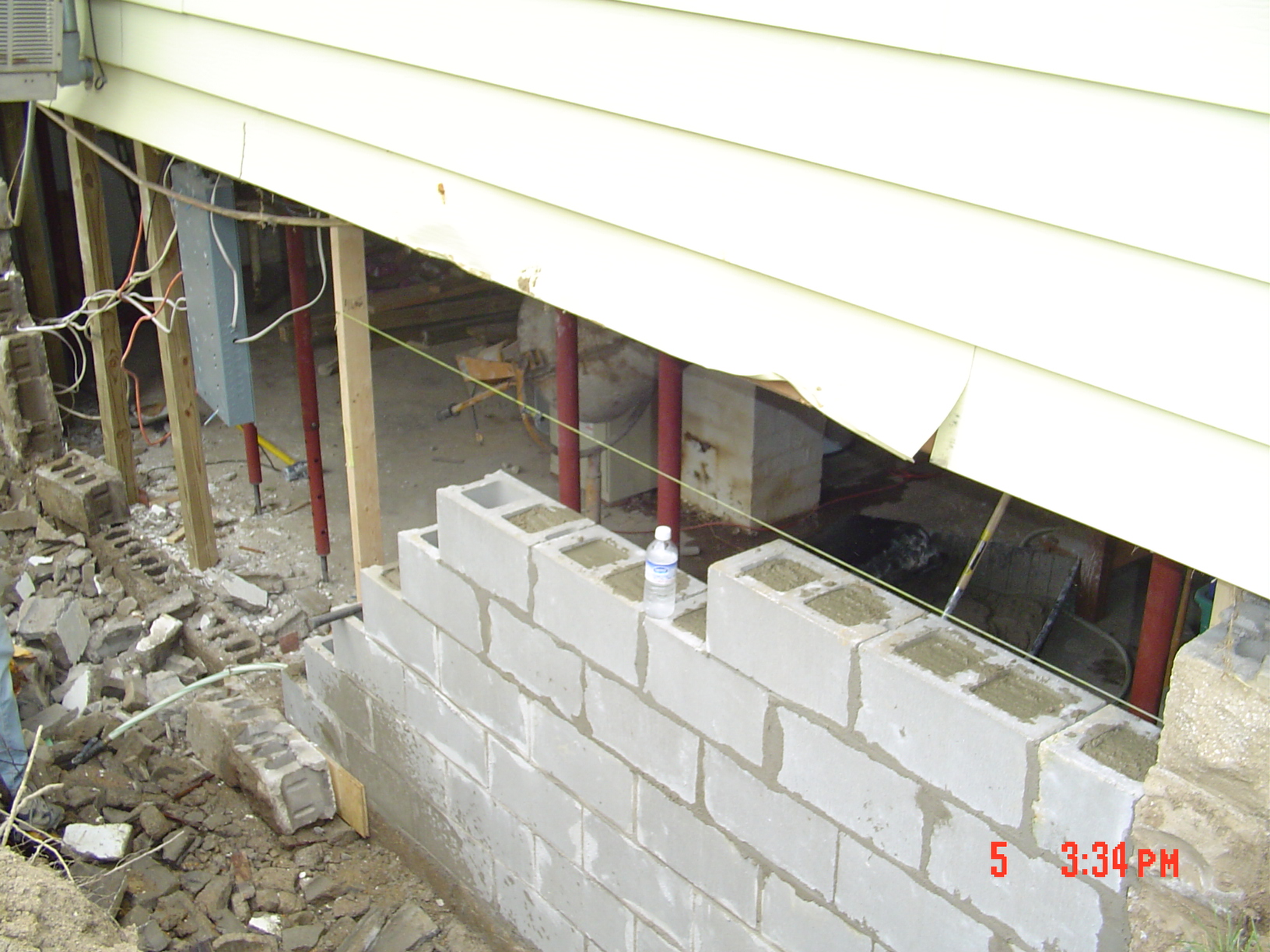

Yes you can do it. I couldn't find anyone to rebuild my basement side walls for a decent price so i did it myself (they were bowed in after back filling-before i owned the house). none of us had ever laid block before. the second wall came out better and was done faster, but the first one turned out pretty good. we didn't clean up the excess mortor since they were below grade.
