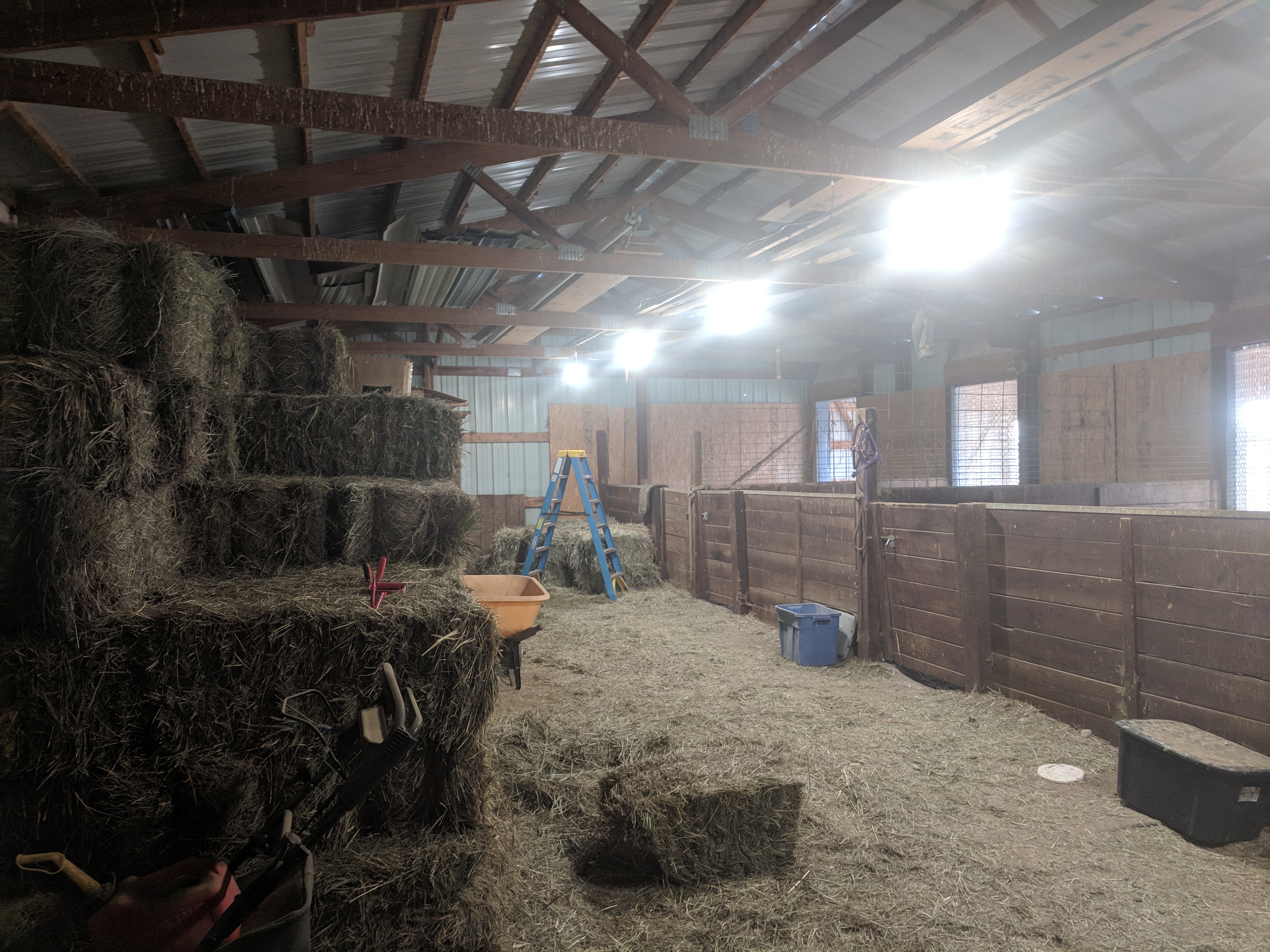

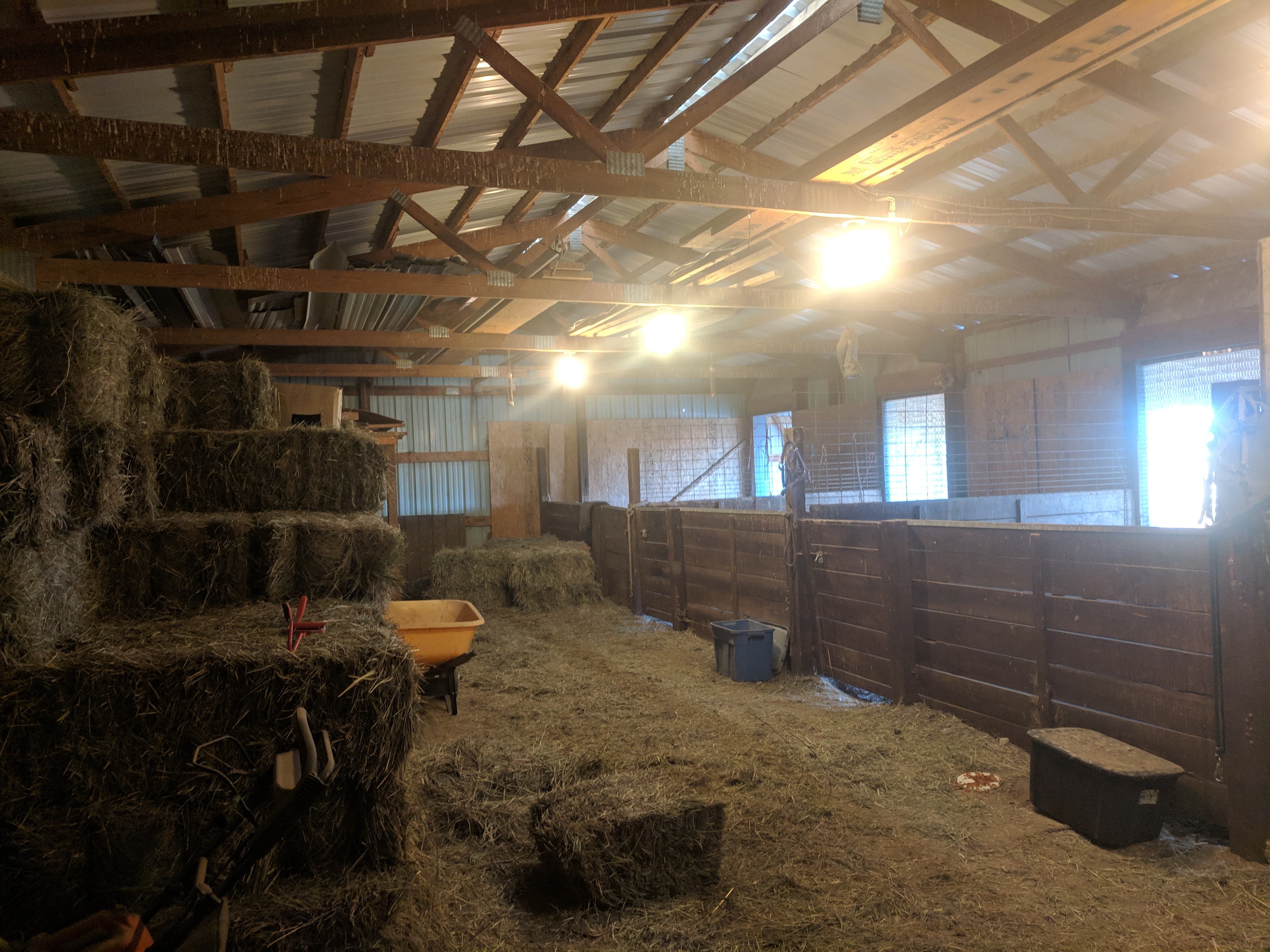

What do I do in the barn where I have twelve 300W incandescents twelve ft up on the rafters?
If they are "standard" base (medium or E26) I would just leave them until they no longer function sufficiently for you (or burn out) and then put in what's is best at the time.
I've about 12 fluorescent fixtures with 8' tubes in one shop at 12' high. They are gradually burning out their ballasts. When I bought the place the best bang for the buck replacing them with 4 foot T5 fixtures. (I've a long thread on it somewhere).
But then I started using 8' LED replacements with ballast removal. Now I think 4' linkable LED may be the way to go. But I can't know what will be coming down the line. Next year mechanical fireflies may be the best.
Right now if I was in your situation and they are E26 bases I would put in 5 way splitters and use either a floodlight shape or just A19. You could put in a splitter with 5 A19 100W equivalents for about $30 or less per fixture. And be cranking out 8,000 lumens using 75 watts.
I've tried corn bulbs but they are expensive per lumen compared to the mass produced A19's
Don't know what a splitter is. The bases I put in a barn-shop built 20 years ago are the ceramic ones that I think say 600W max on them. The bulbs I use are standard base like for a lamp, 300W, except with a bigger glass bulb. Florescent fixtures is more than I want to fool with in a pole barn. I'm just going to use the ceramic fixtures already up there.

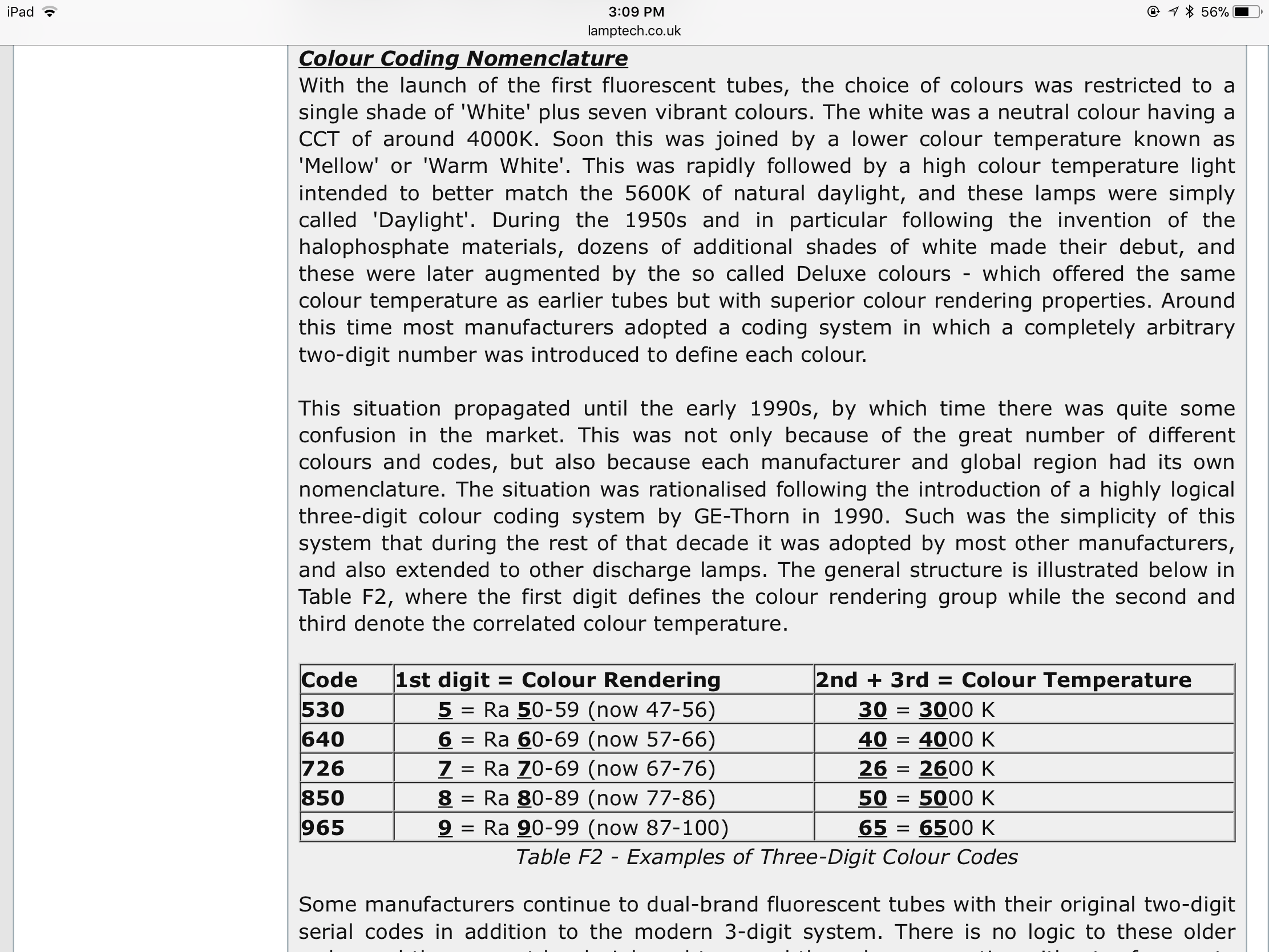

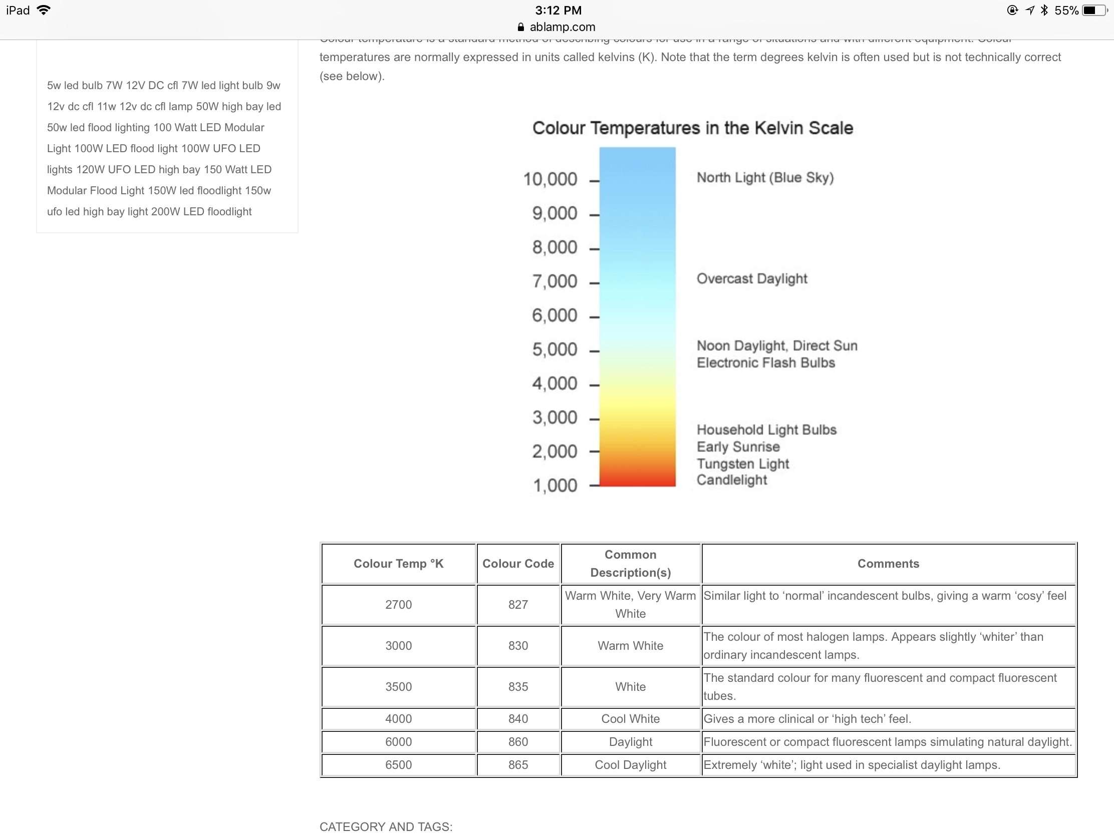

Here's some handy charts I use at my job sometimes when we're figuring out what to use when replacing incandescent and CFL bulbs with LEDs. We have specific colors we have to adhere to in public and private areas and we have to consider lumens as well. Also, diffusers and lamp shades, distances from walls, ceilings, windows, colors of walls and furniture, etc.... it all makes a difference.
The first one shows examples of color temperature in the 8 color code. (we use 8 in all our facilities).
attachment.php

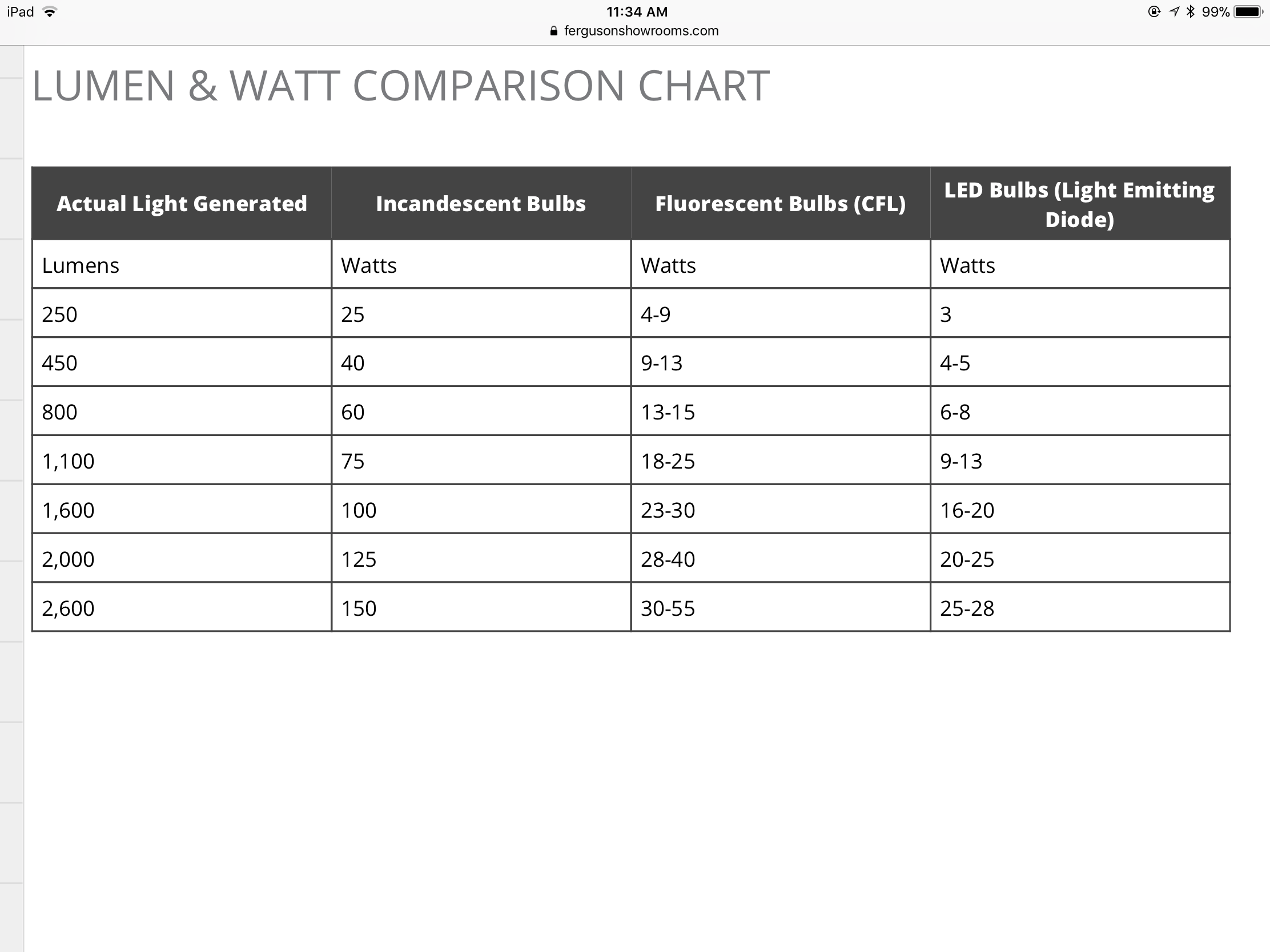

This one shows a watts and lumens comparison between the three bulb types. I find this one the most helpful when replacing bulbs of different types.
attachment.php

It shows the different color codes. There was one white and several vibrant colors.
attachment.php
For my own use at home, I like to stay with 2700k in the living areas, as it's a nice yellow glow. In the kitchen over the sink, I use 4000K, as it's more like a bright white. It's HARSH! But it shows the dirt on the dishes very well.
You can up the brightness in lumens by increasing the wattage while still sticking with the same temperature range of, say, 2700K, and the same color range.
So if you like the color of the lights, stay with that K number, then play with different wattages of that same K number to get the lumens (brightness) that you need in that area.
