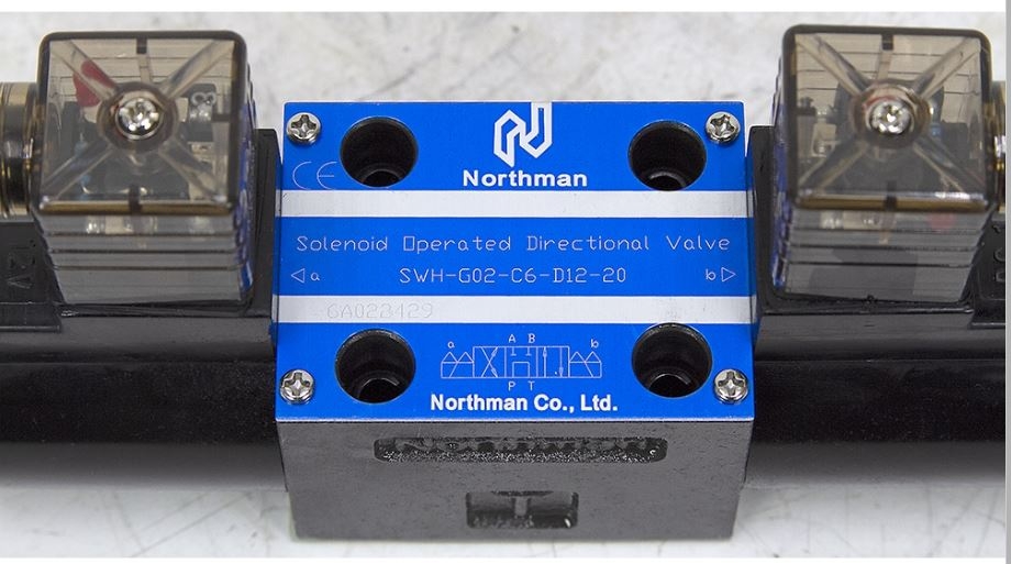

I'm sorry to say, you have raised more questions in my mind than you answered. You talk about "loader valves." I am using this subplate and this valve to run a grapple. I'm not sure I would call it a "loader valve." Are we talking about the same thing?

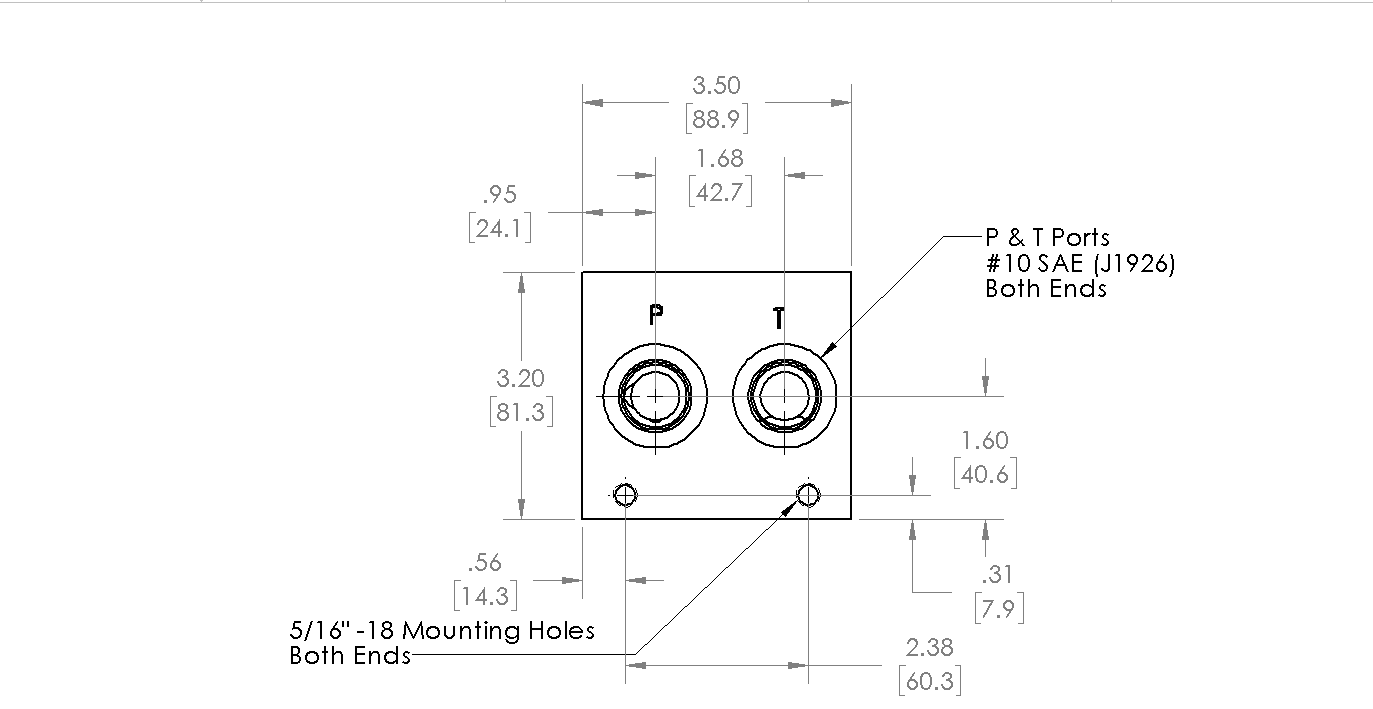

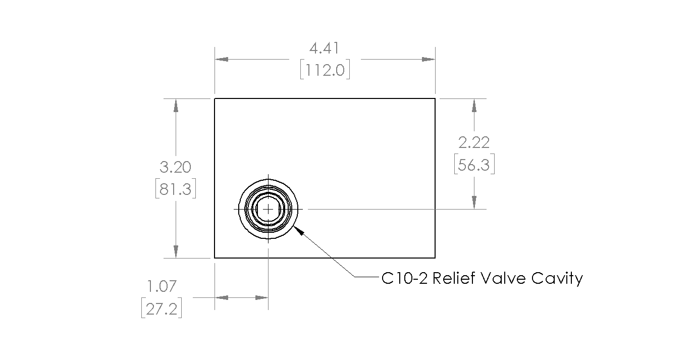

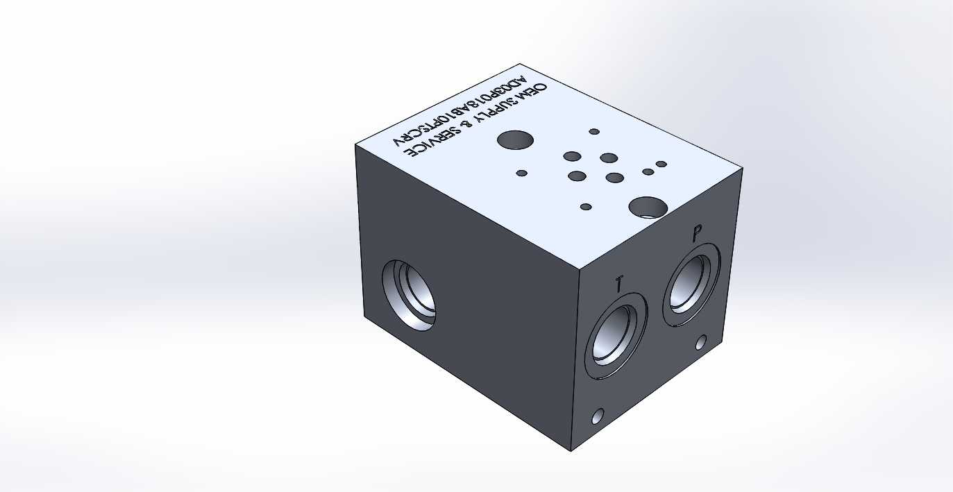

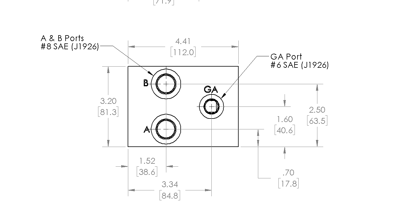

   / Can I tee into PB and return for extra valve? #19

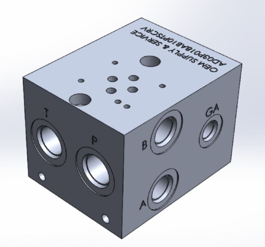

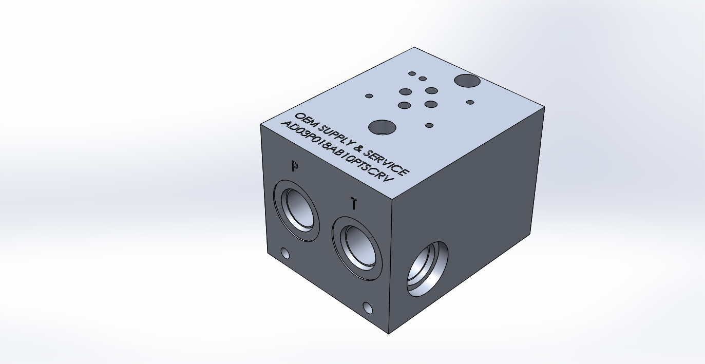

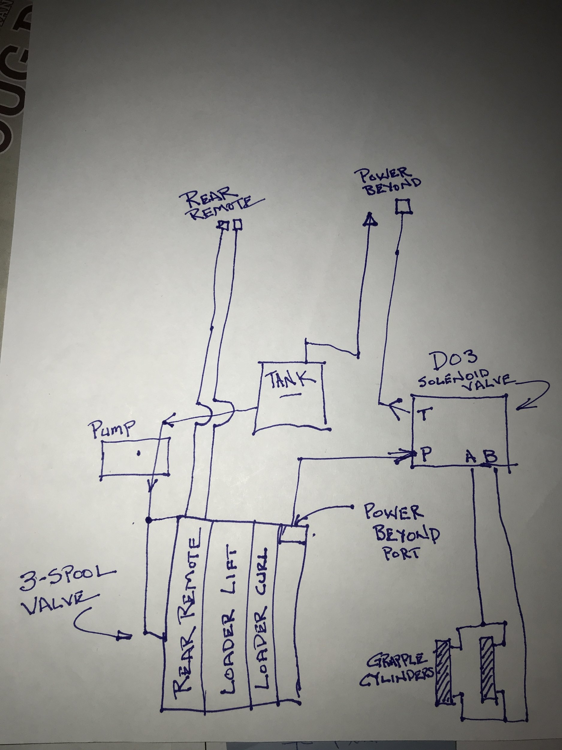

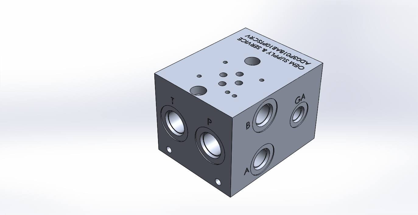

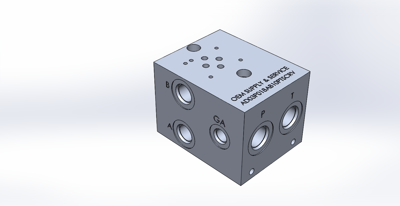

I don't find a flow drawing anywhere, but the subplate is at
Attached are images of it from all sides.
I chose this subplate specifically because it had the A & B ports on the same side, and it had the T & P ports that go through (so by using plugs in the non-used side, you can choose the valve's orientation). Most D03 subplates I found had A & B ports on opposite sides, and T & P ports on opposite sides (typically requiring 90-degree connections all around).
For my application, I wanted the A & B ports on the right side and the T & P ports on the same side, with the T port to the left of the P port. That way my hoses don't have to cross each other and I don't have to use any 90 degree connectors on the T or P lines.
Other than the fact that it is "taller" than most D03 subplates I have seen, and the fact that it has a gauge port and a common cavity pressure relief valve port, both of which are plugged off, I was told it is a pretty standard D03 subplate, which will work on any D03 solenoid control valve. The valve I had fit perfectly onto it.
I don't know how to draw internal flows, but I have drawn the layout to the best of my ability. Sorry for the kindergarten drawing technique.
The tractor has a rear remote which comes off of the third spool of the 3-spool loader valve. The rear remote has two female 1/2-inch AG quick disconnects.
The tractor also has the Power Beyond kit installed. That kit currently has a line that comes off of the Power Beyond port of the loader valve, a male and a female 1/2-inch AG quick disconnect at the rear, and a line back to the tank. That is where the log splitter will eventually tie in.
I am cutting into the Power Beyond line and adding the D03 subplate and solenoid valve for the grapple.
Does this make sense?

   / Can I tee into PB and return for extra valve? #20
I think your drawing is fine. Not knowing what is going on inside the DO3 is a bit of a problem. But the schematics are probably available. It may be that they are so simple that everyone but me already knows how they work.
A few questions.
1, What feeds flow to the rear remotes? Is there some sort of push/pull valve? Why does the drawing show two lines?
2. You label your loader control valve as 3 spools. Does it have three levers that move those three spools? Most loader controls have only two.
When you move the spool control lever off of center - say to lift the loader arms - several things happen. The tubular spool moves, and as it moves some some of the lands and grooves on the spool line up with various ports on the inside of the bore. One set of lands line up to block flow to the tank. A set of grooves line up to send the flow that was going to the tank to the extension side of the lift cylinde. At the same time, another set of lands was blocking the other side of the lift cylinder so that the arms would stay up in the air when the lever was centered. These lands that were not allowing oil to leave back side of the cylinder now are moved aside and grooves take their position to allow oil being expelled by the movement of the cylinder piston to go to the tank.
So a simple one-way movement of the lift spool lever actually does a number of things. It does so with very close tolerances which is why they cost so much to make. And that leads to my question 3...
3. What do you think is happening inside the DO3 when the solenoid is activated? Does it do all the things that the loader control spool valve does? Specifically, lets say that the "a" circuit is activated to extend the cylinder. As it extends, the piston moves and forces fluid out of the other side of the cylinder. But circuit "b" is closed. Does that expelled oil have a path out? Where?
