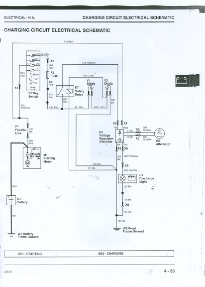

Can I test the amps from my alternator like this?

i found a friend who is going to lend me his clamp on ammeter (or whatever it is called).
what should i test? the amps coming from the alternator?
For starters, you mention that you have a number of wires that get hot. Thats where I would look first.
I would also measure the output current of the alternator and compare it to the current into the battery.

here is another attempt at posting the schematic....keep your fingers crossed.
Thanks! I'm working on some color highlighted illustrations. It will take me awhile, but I'm hoping my illustrations will explain things enough that you'll be able to get some quality troubleshooting. In the meantime, if anyone else wants to explain the circuit, go ahead. I welcome your help.:)
   / Can I test the amps from my alternator like this? #100
First I see a FUSEABLE LINK in the circuit between the battery, alternator and key switch to limit current. What is its current value? The two lines from the VG to the Alt. I an not sure what they do without knowing what is in the black box. I can assume that the VG is acting like a voltage regulator holding the output constant with an oversupply of voltage and current from the alt, or i may assume that the Alt case is grounded [not shown] and one of the two lines is the rotor winding feed and the other is the AC output current from the alt to VG rectifier. Need to know how the alt is wired and more about the VG innards.
