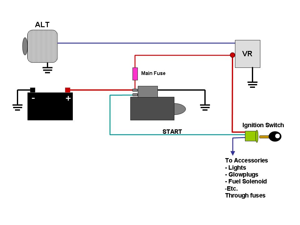

Smitty, this is getting really complicated really fast. In another thread where you first posted about your burned up regulator, Mitch Becton said that the JD4100 has a permanent magnet alternator (essentially a dynamo). A dynamo requires no battery for output. As a matter of fact, you check it for operation by disconnecting the output and measuring to ground with a voltmeter. However, if you have a traditional alternator, you may need to have it spinning at a minimum rpm and have battery voltage to excite the field windings.
You also mentioned that when you turn on the key, the battery voltage drops. I think this is due to an automatic glow plug cycle that puts a load on the system and pulls the voltage down. I'm just not sure.
I'm afraid to give you anymore advice without the system schematic. I really think my best advice would be for you to "bite the bullet" and put your tractor in the shop with experienced technicians. Your problem could be something simple that they have seen. Wouldn't you hate to "throw good money after bad" and just keep having problems? You've given this a good go and haven't found the problem. I think it's time to turn it over to the professionals. We all mean well, but nobody here seems to be an expert with your system. That goes especially for me without some documentation and manufacturer's references. We all want to help you, but we're a bit like the blind leading the blind without all the details.:eek::(
BTW: I put together the following schematic that basically illustrates how most of our tractors are wired. Notice that the voltage regulator red wire goes to the starter terminal and attaches to the battery. It also branches and goes to the ignition switch. The switch then powers the various circuits of your tractor through individual fuses (blue line). When you turn the ignition to Start, the green wire is powered to pull in the coil of the starter solenoid and close the high current switch to the starter motor. This simple diagram should look something like your tractor's schematic in a very simplified form.

thanks again for the info.
this problem has definitely gone way past my knowledge base, which I am sad to say is not that deep.
i am ready to hand it over to the pro's.
i am curious though about your point about the dynamo. i don't know if it is called a dynamo but I do know that it is a small 20amp alternator.
I don't know why it won't run without the battery...I just thought I was breaking some sort of circuit and that is why it stopped.
