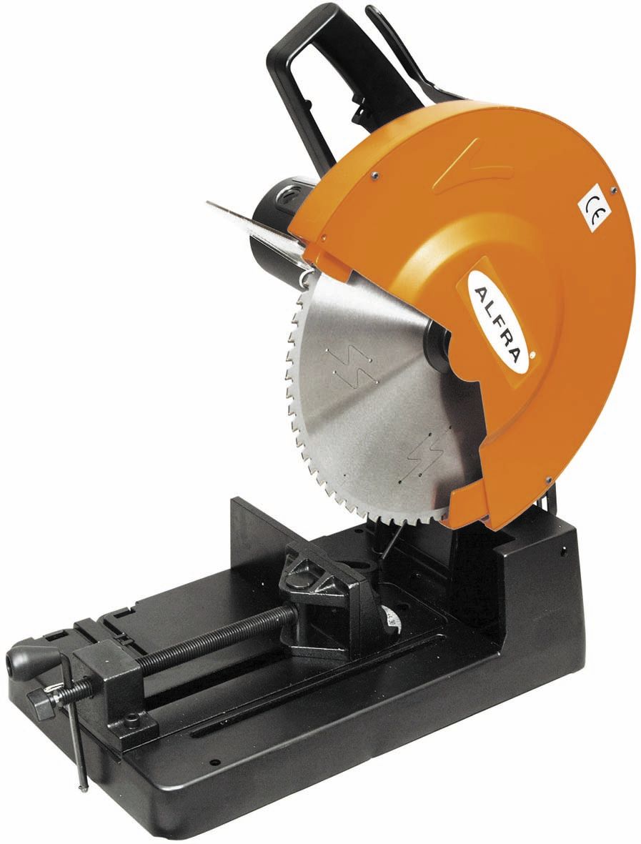

As long as we're talking high end stuff maybe you should look into a cold saw. Those are great if you have a lot of tubing to cut. I had a friend who had one in his shop, I loved using it to cut tubing and most other stuff. Good clean cuts to exactly the length I needed and even angle cuts are a snap. They ain't cheap but they sure are great to use. I used his shop so much I broke down and bought him a Miller plasma cutter one day. It was the least I could do.

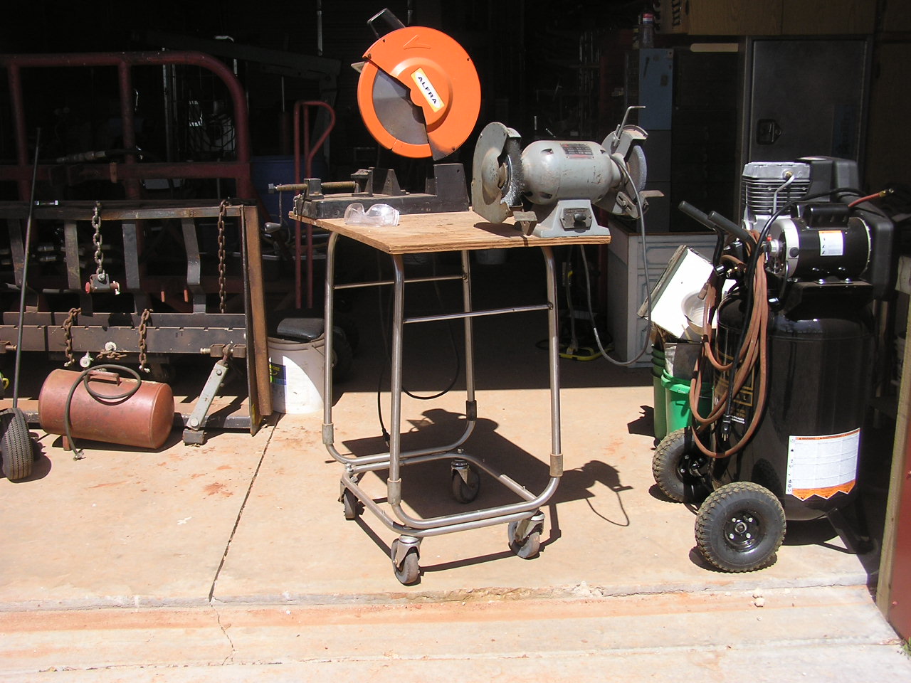

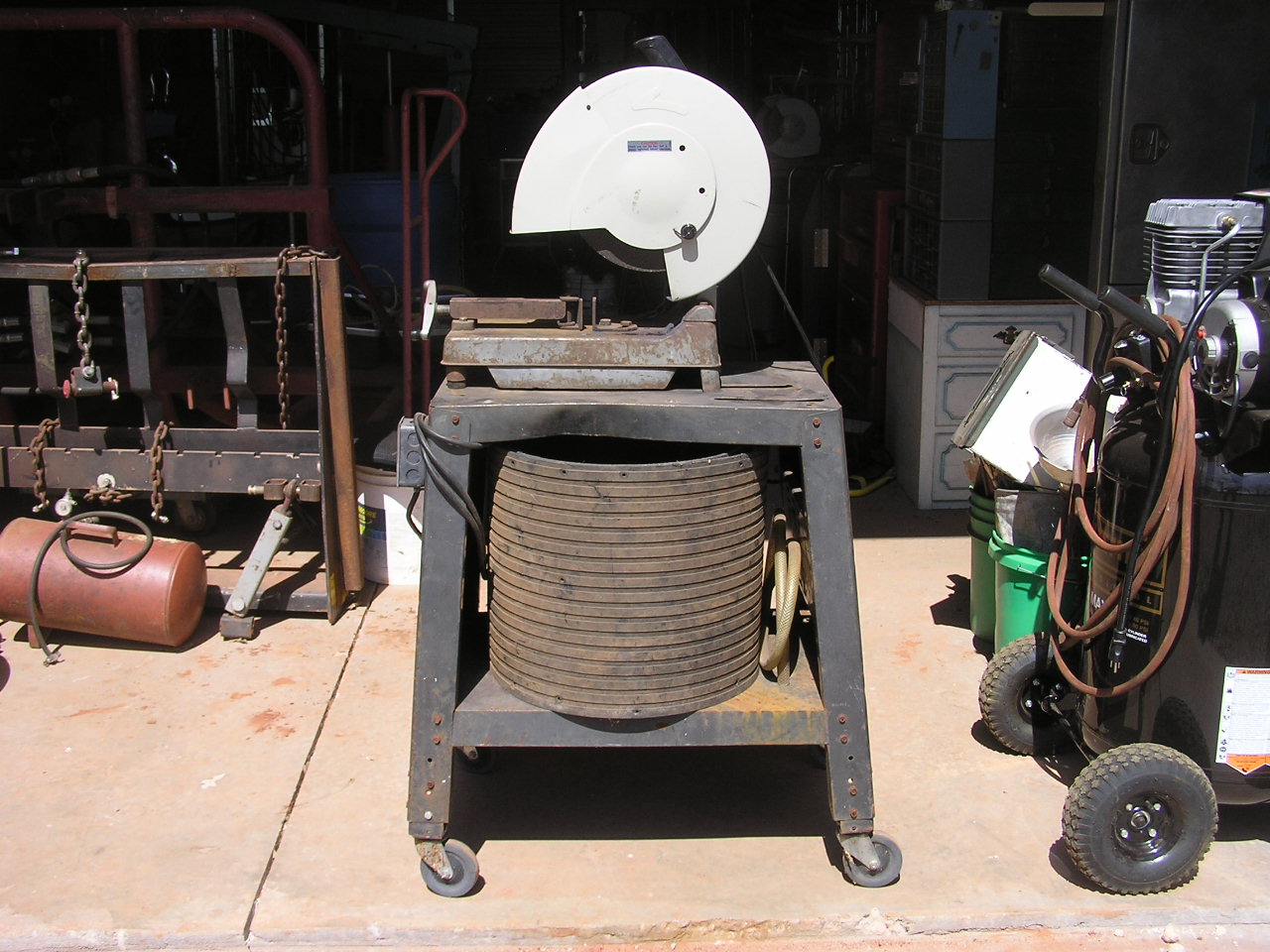

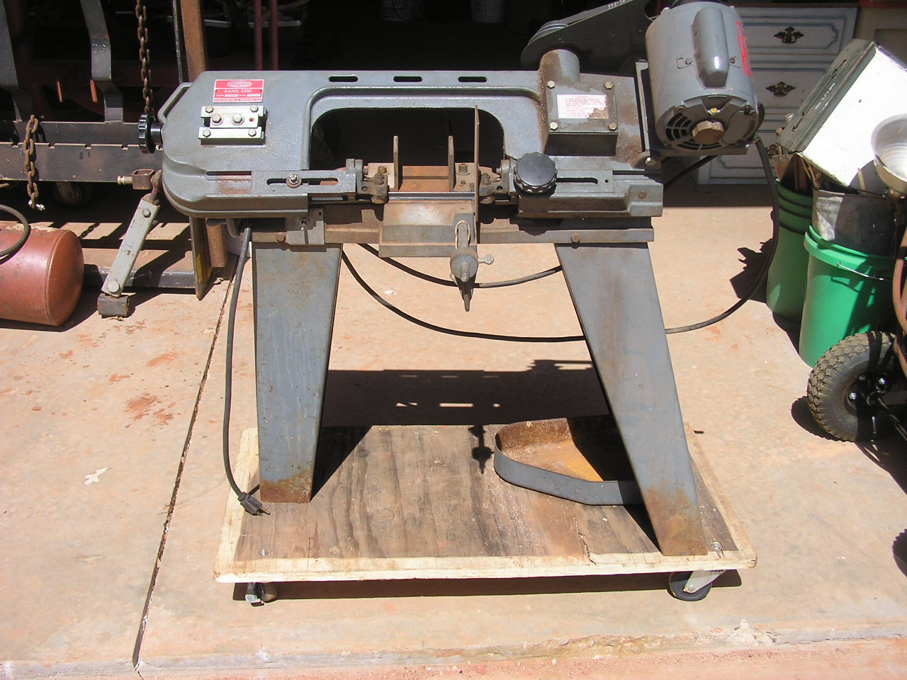

Not an industrial cold saw, mine is a Alfra metal cutting saw.
And a chop saw.
And the band saw that also cuts in the vertical position.

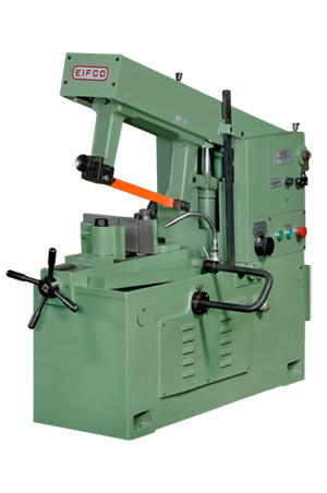

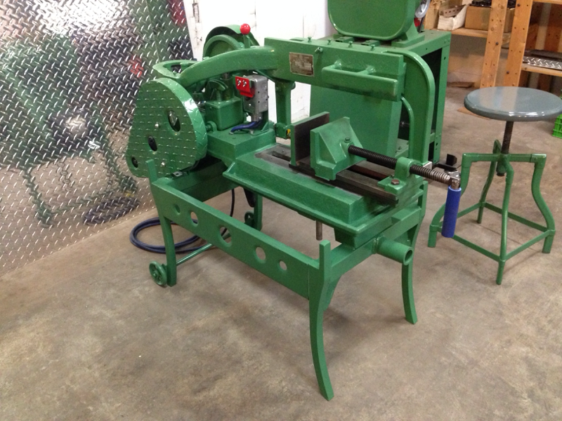

In high school metal shop class we had a power hacksaw:
I was the only one allowed to use it, :D everybody else kept breaking blades.
   / Can I use a miter saw for steel ? #27
Never seen one of those... doesn't seem nearly as efficient as a horizontal band saw. Rather a big tool with not much capability... just my initial thoughts. Interested to know if there are benefits vs. a band saw?
   / Can I use a miter saw for steel ? #28
In high school metal shop class we had a power hacksaw: I was the only one allowed to use it, :D everybody else kept breaking blades.
I'd love to have an industrial saw like that! I only have a little import one that I "re and re'd". :(

Hey X, where did you get that Alfra cold saw and how much? Looks to be a nice German made tool but don't see it for sale on line after a quick search.
Got it several years ago at a welding supply place in Oklahoma City.
Seems like just over $300, with an extra blade.
Amazing how good it cuts and with very little heat.
