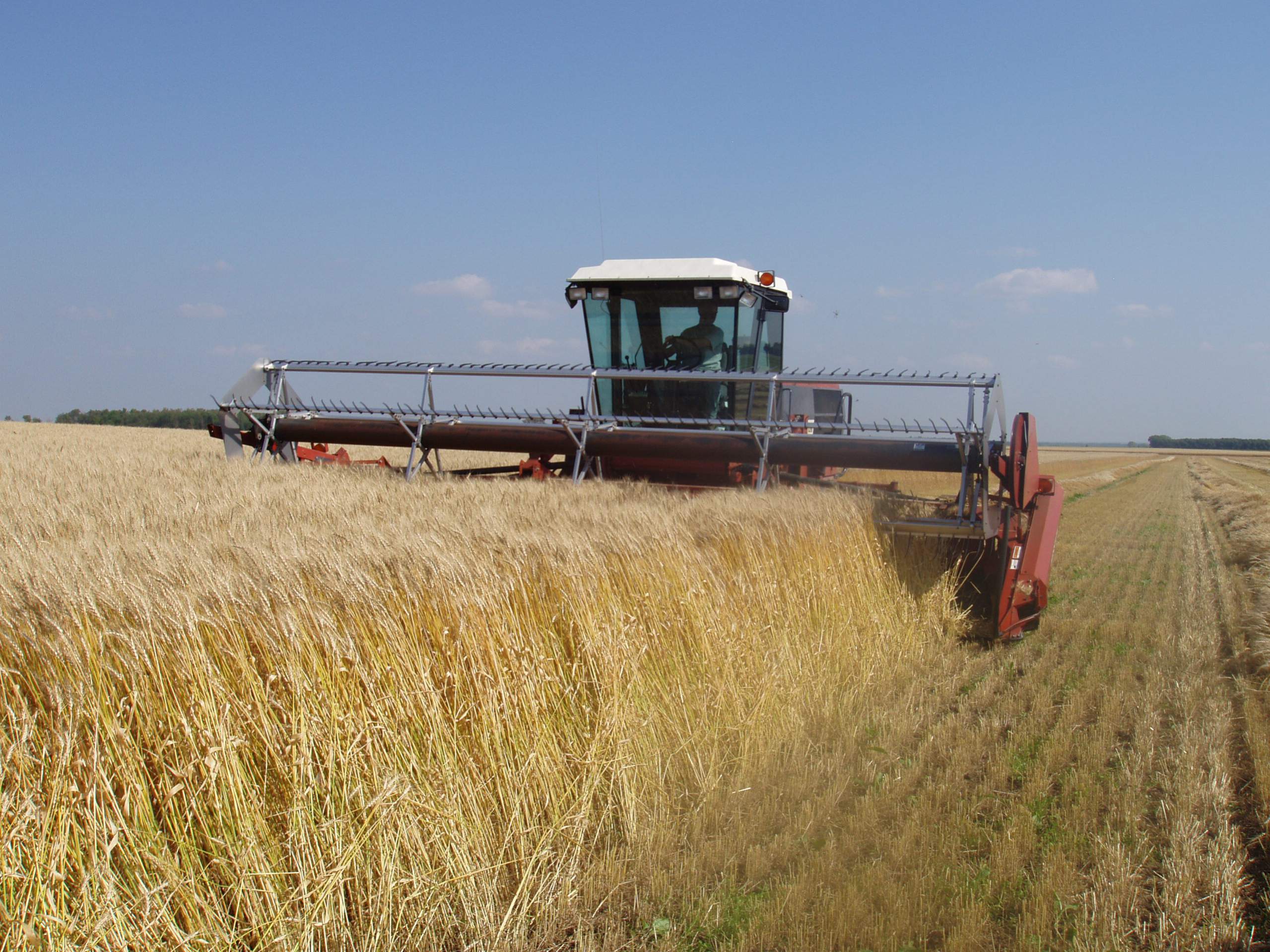

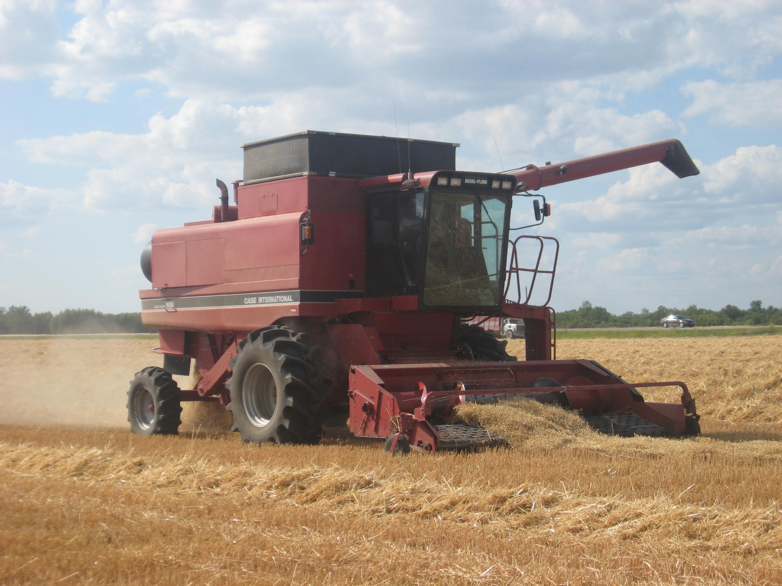

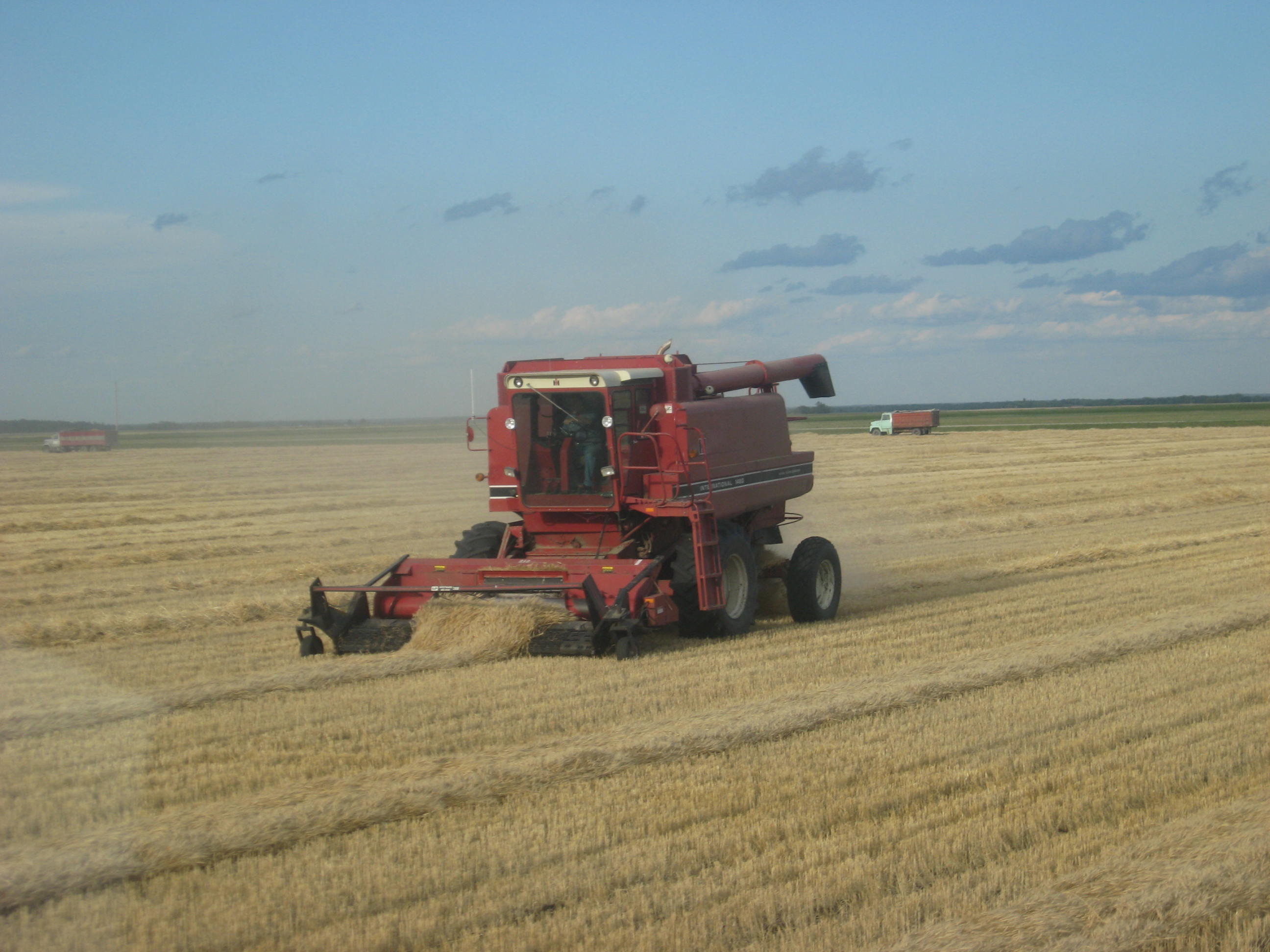

I guess I'm a little confused Robert. Once oats mature out, and you can get 45 day oats, then they are basically dead. Once that happens the water to them is gone. It's basically a dead stalk. Hay on the other hand is always alive and growing. I guess I don't see the benefit to letting the oats dry on the ground? I would think you would get more moisture pickup on the ground and cutting the oats early rather than leaving them on the stalk.
We swath up to 800 acres of oats every year to combine and i find less grain loss than straight cutting as by the time standing oats are ready the elements have shaken a lot of grains off , Early swathing saves everything and gives a more even ripening unless you dessicate with roundup .
