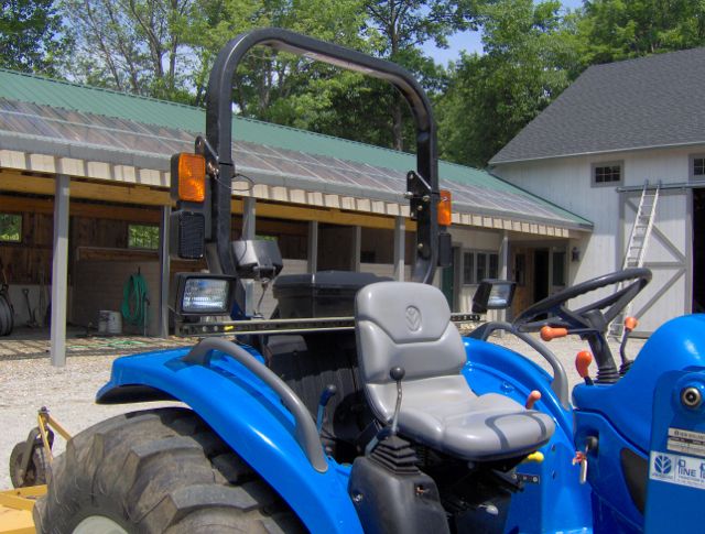

I've attached a photo of how I added extra lights on my 2004 TC35 without using the ROPS at all. My machine had two welded tongues on the ROPS frame, and I was able to bolt the metal bar directly to it. I was also able to attach a tool box to the metal bar, conveniently placed right behind my seat.
I have my two 55w lights pointing forward (they illuminate my work area around the tractor well), but they can swivel in any direction. Also, I made a bracket for my rear work light (a previous job) by just bending one of those 2x4 metal slide brackets and drilling some holes.

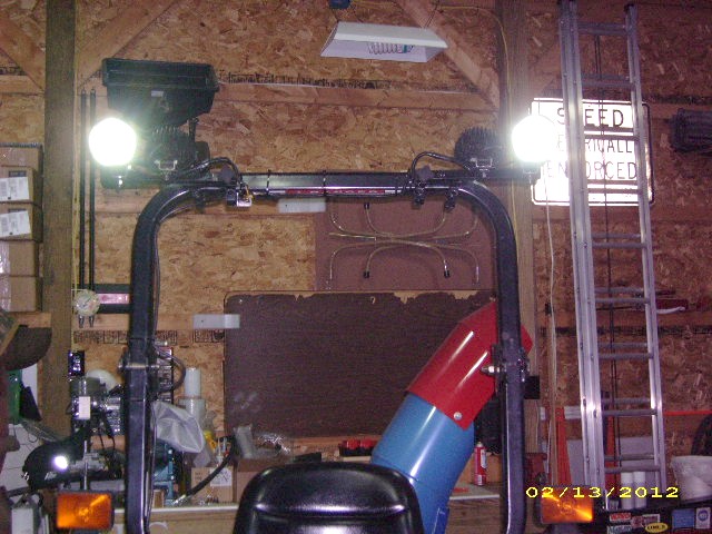

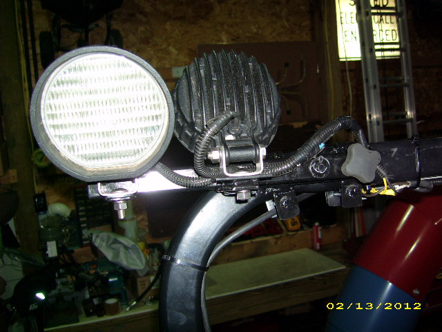

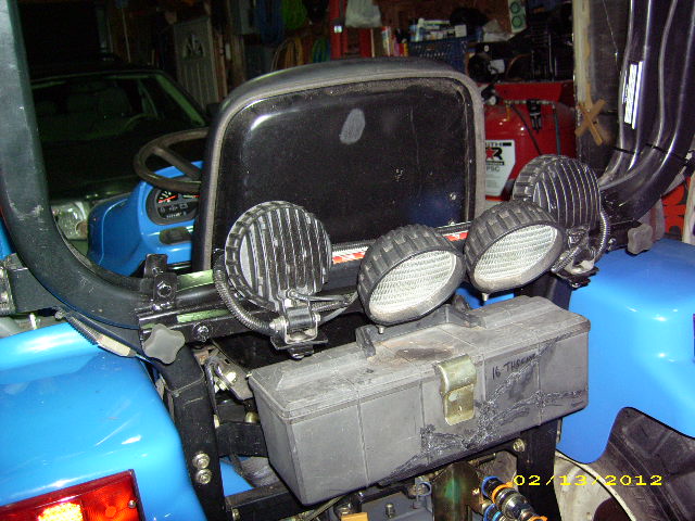

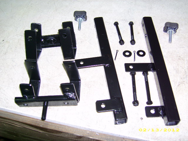

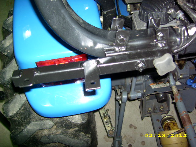

Here's a few photos of my recently re-worked, now rotatable light brackets.
Because I can't get my machine in and out of my 4 bay garage (where I park it for the winter) without folding down the ROPS, when it came to attaching lighting, I wanted something where I could easily swing the lights out for coverage (mainly snow blowing) and tuck back in when necessary for clearance. (mowing, woods work etc.)
My LED lights mount to the ROPS using U shaped brackets I fabricated and then have the ability to swing the arm in or out.
I also wanted something to work around another project I am in the middle of... converting a $79 golf cart enclosure into a soft side tractor cab.
I plan to create separate posts in more detail on both of these projects.

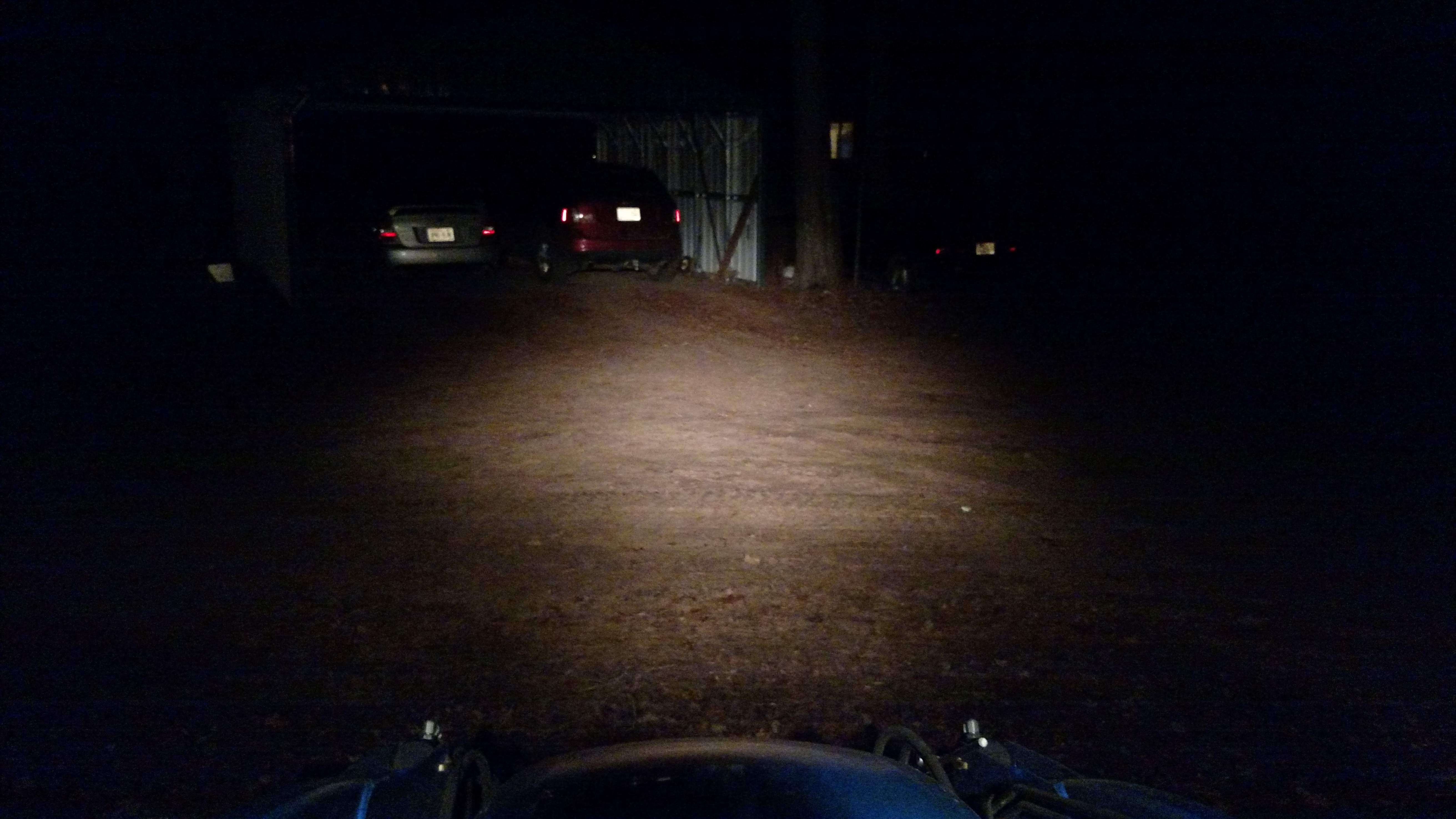

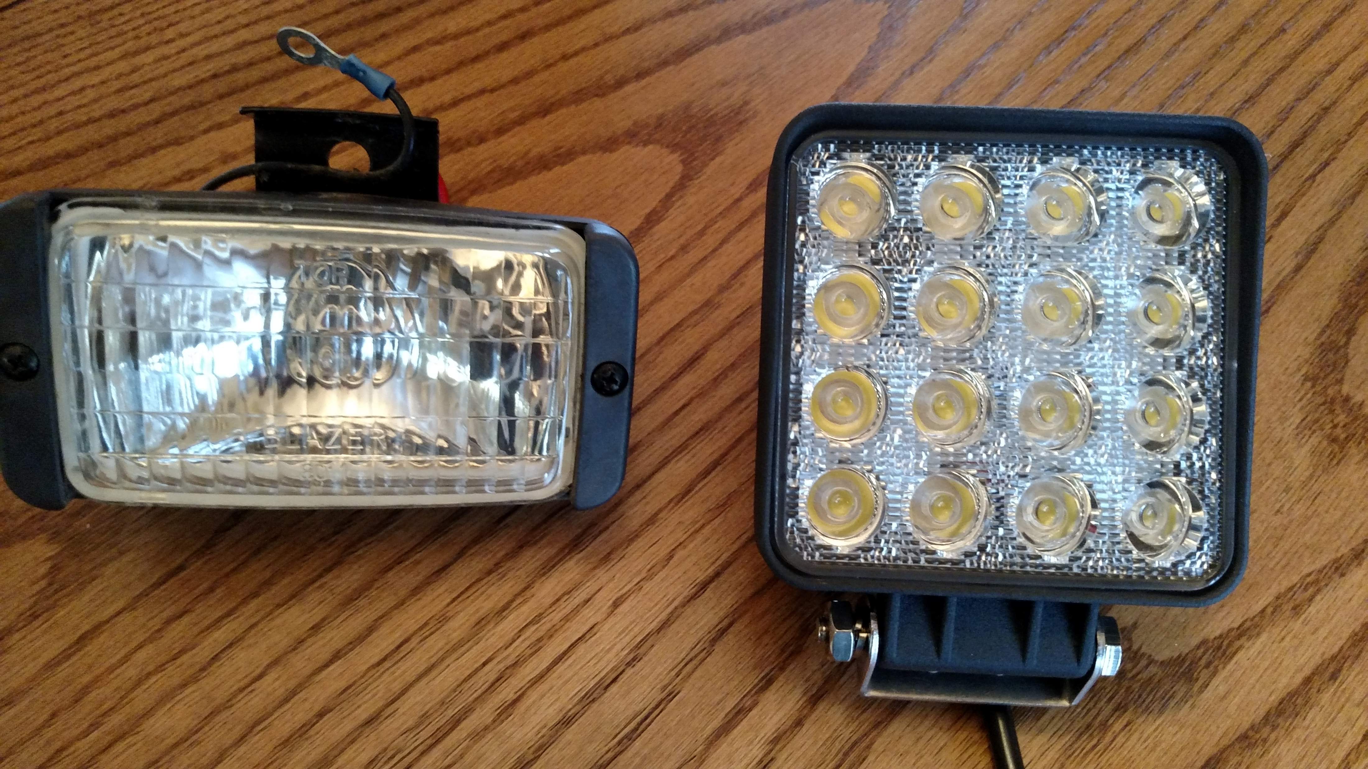

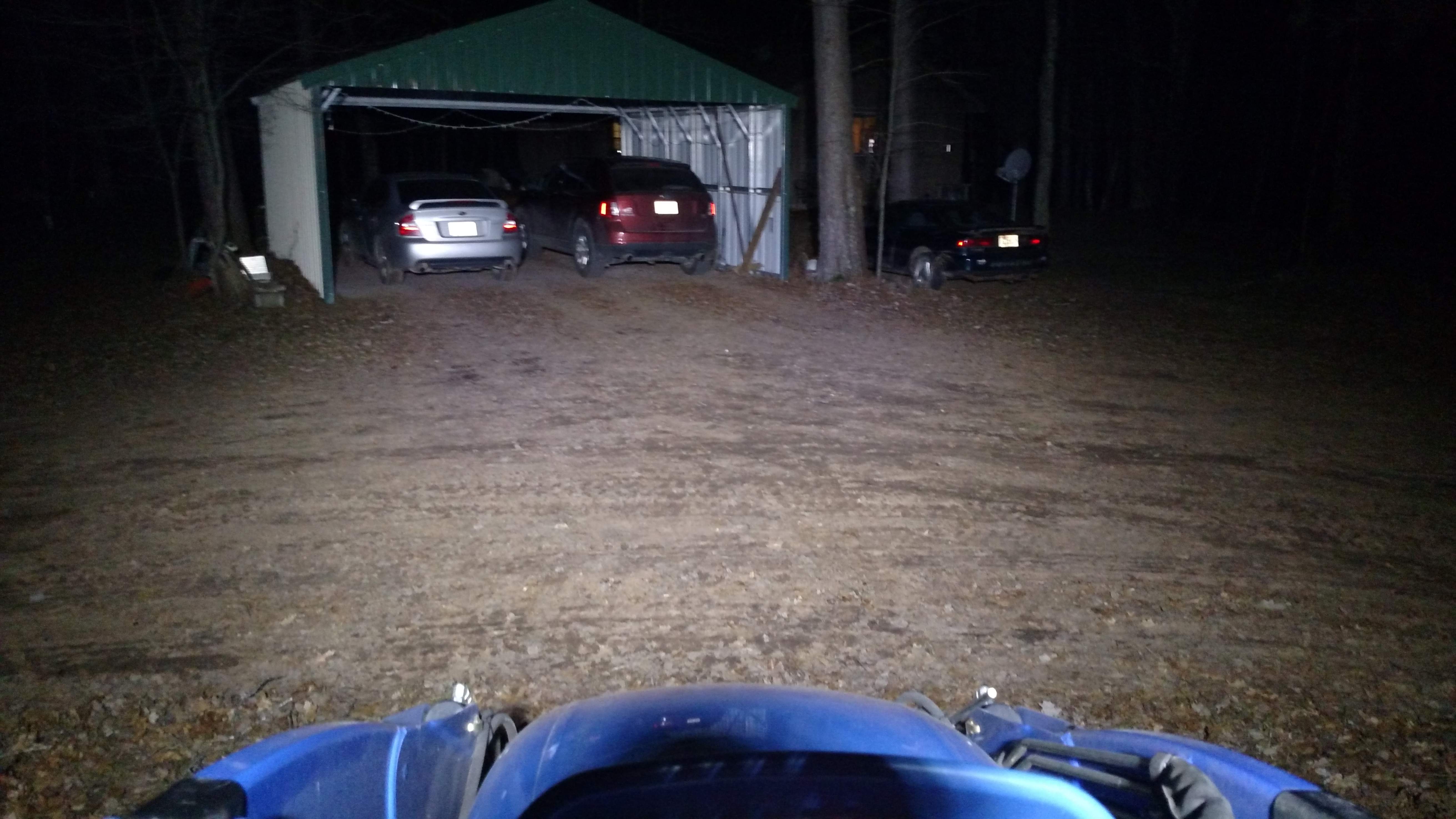

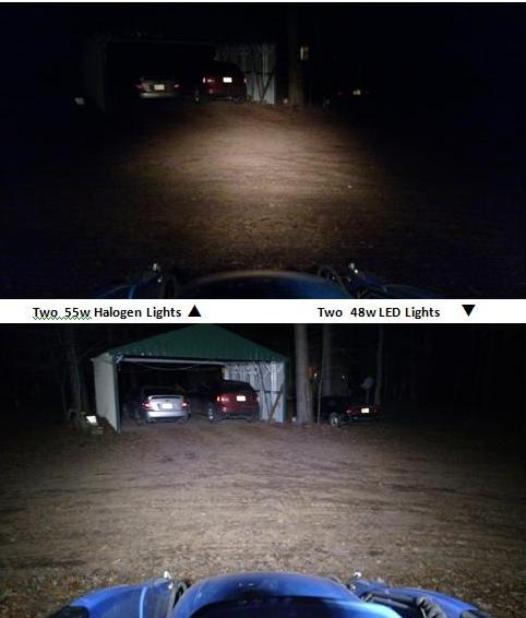

   / Can I Use Fuse Box Spare for Work Light Power????? #10
