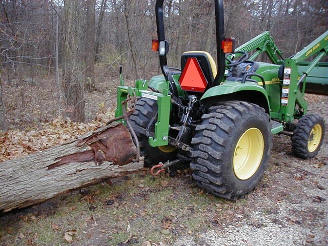

Sure, a set of log tongs will hang nicely from the center hook.
Heres a picture I stole from member "beenthere" in an older thread"
   / Can I use this to drag logs?
Thanks for the photo. Any suggestions on where to buy the log tongs?

   / Can I use this to drag logs? #7
Taking into account what Bruce posted, we have used our skidding tongs to both lift the leading edges of logs for skidding and to lift them into the bed of our truck.
However, as the folks on the forestry forum are quick to point out, the safer/est way to liftclogs is straps (or chains) used in choker fashion.

   / Can I use this to drag logs? #9
i do it the same way as that pic but i rap a chain under the log so im pulling with the hitch and only lifting the log with the 3ph i dont like to pull with the 3ph also it will keep the front end down more.
