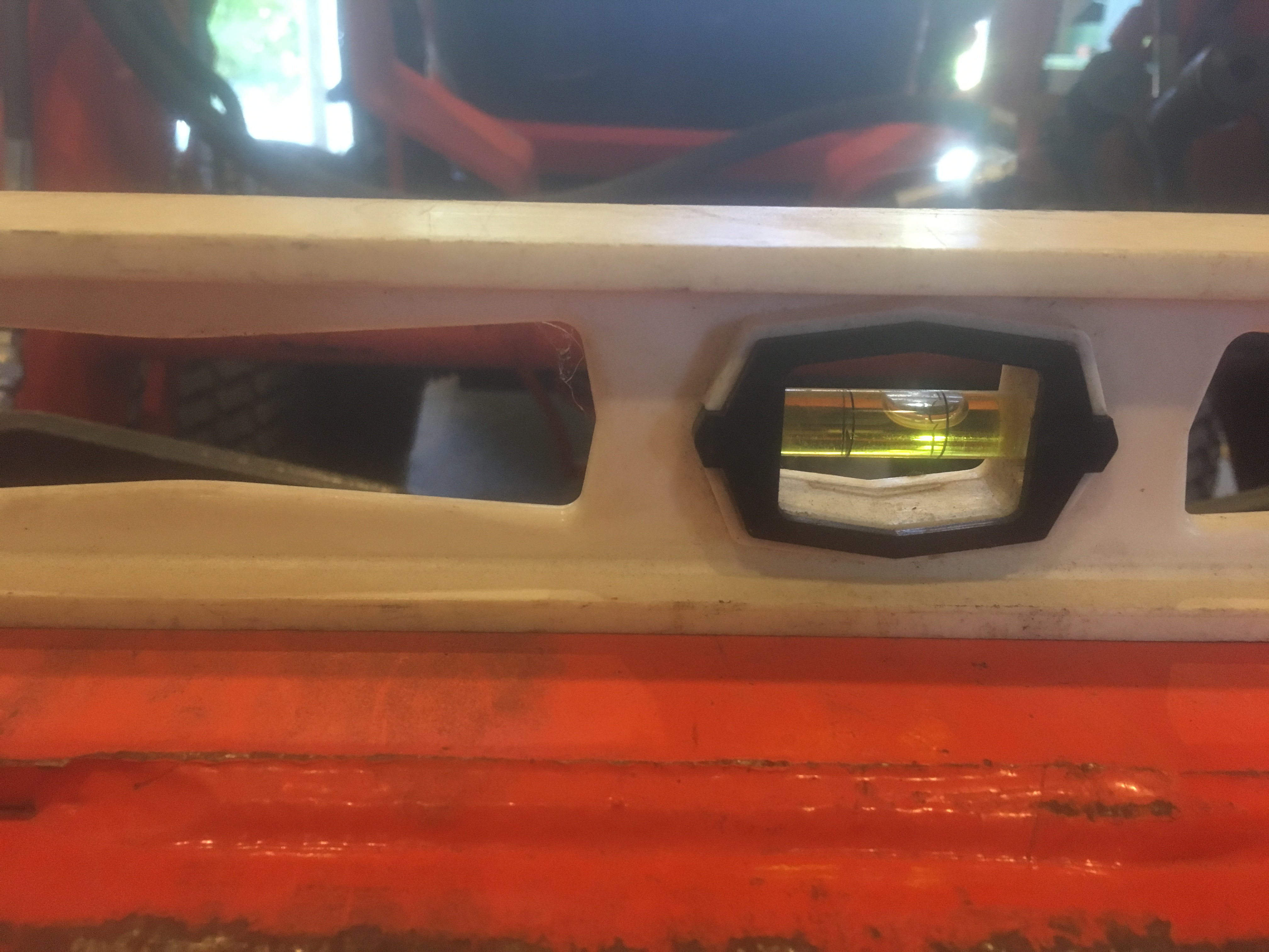

I have a Kubota B2301 with loader. Not sure how or when but the right arm appears to be bent down and in. I didn't really notice it until I took the bucket off and had to put it back on. If I measure the top of the end of the arms (the part that slips into the bucket) there is nearly a two inch difference in height between the arms.
Thanks

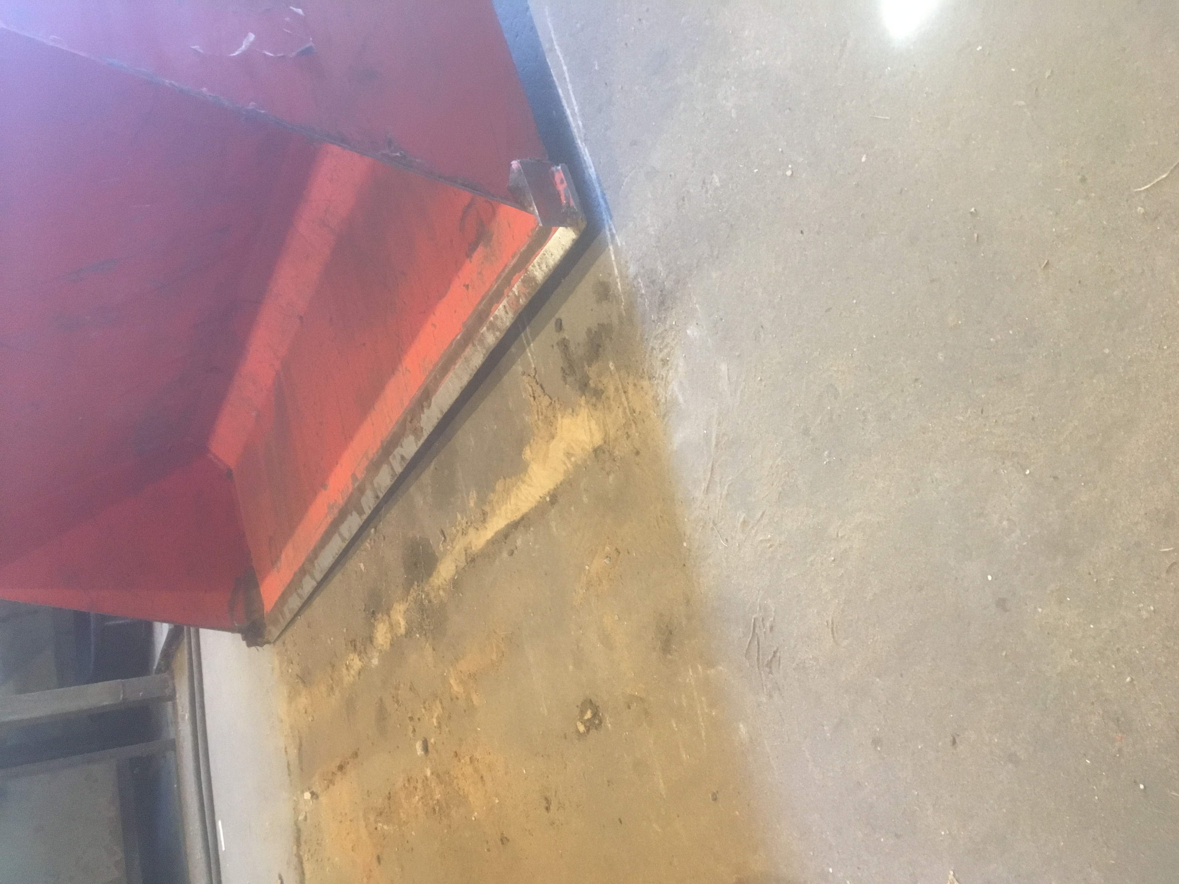

View attachment 673166View attachment 673167
Thanks
If the bucket came off easy and went back on easy, it is not the arms, but the bucket is twisted. I beefed my bucket up with 3/8th inch angle iron on top and 3/8th inch side plates welded on before I used it much. They are easy to twist, even after beefing up.
If it really bugs you, just find something real heavy and try to lift it with just the left corner of your bucket. It might even been just wear in the loader curl linkages. Try lifting the front tires of the tractor up with the bucket's joystick. I bet the cutting edge will go flat on the floor.
hugs, Brandi

Just use it per normal. Mine was tweaked and by using it it tweaked back in place. It was so bad I couldn't even connect my quick connect attachments.
Over time it fell back in place.
Just lifting this heavy and crooked with twist it but it will eventually twist back when you lift something heavy on teh other side of the bucket.
