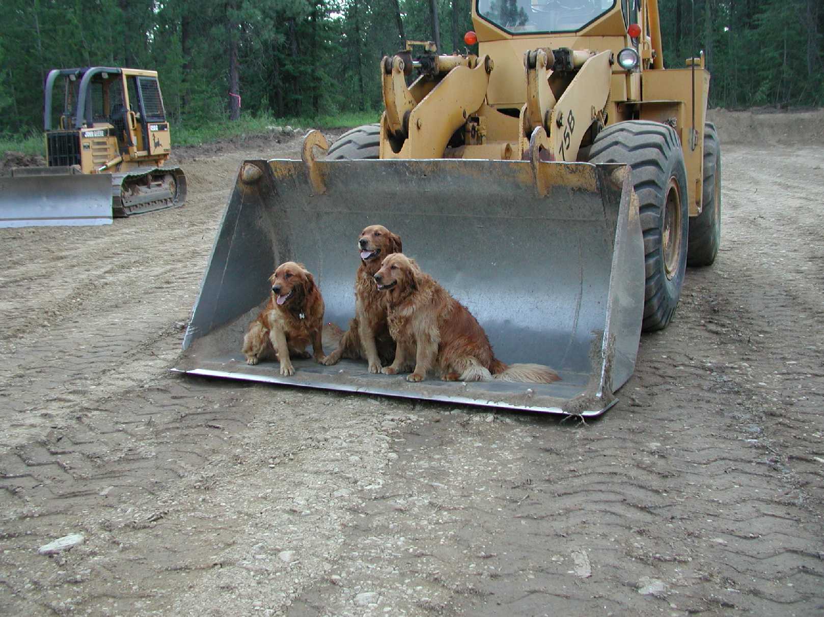

You know , when i put in my riding arena i had to lower one side about 5 feet and raise the other side the same amount. I was going to take all summer and do it myself, but instead (wifes nagging) i hired an excavation contractor to come in. He brought a large loader and dozer, leveled it in 1-1/2 days. Did an awesome job and it was money well spent.
Since having this main work done, i have had occasions to dig a little more here and there to fine tune it. It takes soooooo long to move a yard of dirt with my bucket. This is the sized thing he used.
