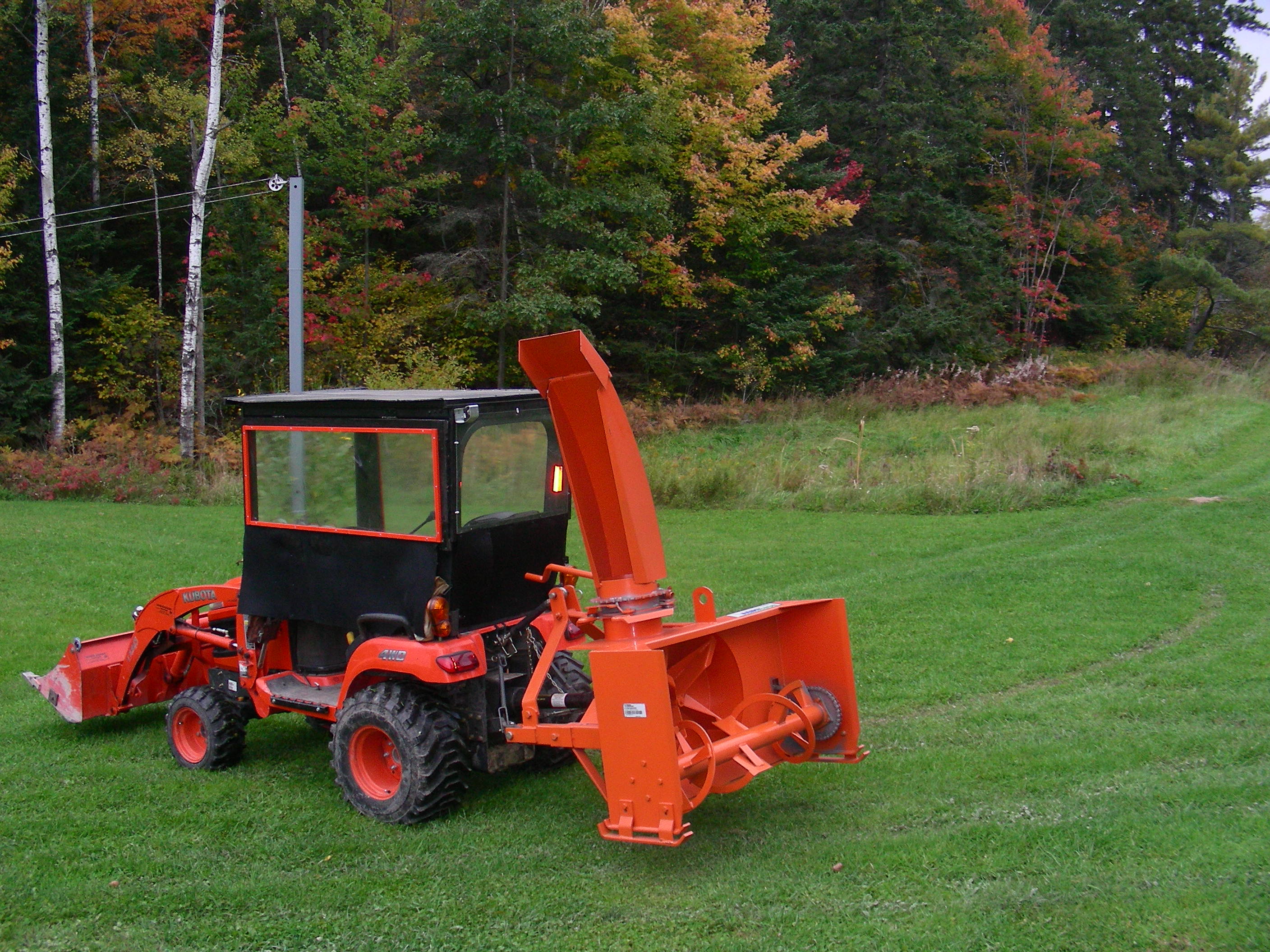

Well dho13 ............ I did things in reverse of you, I have had a SCUT (BX2660 ) for a few years now and just bought a Kubota RTV X1100.
The BX I use for grass by using a rear finish mower (I leave the FEL on ) and I have got quite quick doing 3 acres in about two hours with a variety of obstacles and hills . I also use the BX for snow removal with a snowblower attachment on back, don't sweat about expense of a cab, it is easy to make something to get you out of the wind out of wood and clear plastic and plexi, that you can take off in summer.
I am considering using the RTV for snow as my backup in case tractor ever down or for quick swipe with a plow, but will make a plow maybe next year after I get a winch. The tractor will also be used this summer and next to widen all my trails for the UTV that is 66 inches wide versus the ATv that was only 42 inches wide .......I think you will have an excellent one two punch for your alnd if you go the SCUT route and after you see all the advantages of a three point hitch and attachment available, you will be buying a new attachment each year ($1000 - $2000 typical attachment ) good luck
