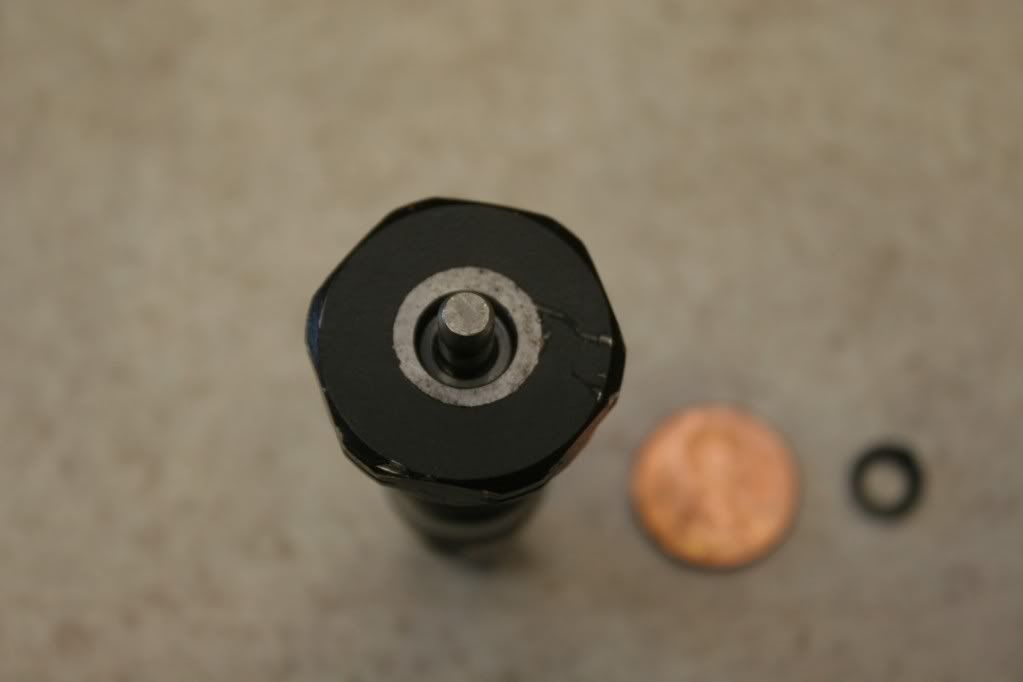

I have 2 Releif Valves out of a JD425 The Seals on top are leaking, I removed one of them and they are about the size of a top of a pencil eraser and the number is NTN 2X6X59 I have looked online and not found anything, I hope someone in this great forum can help,

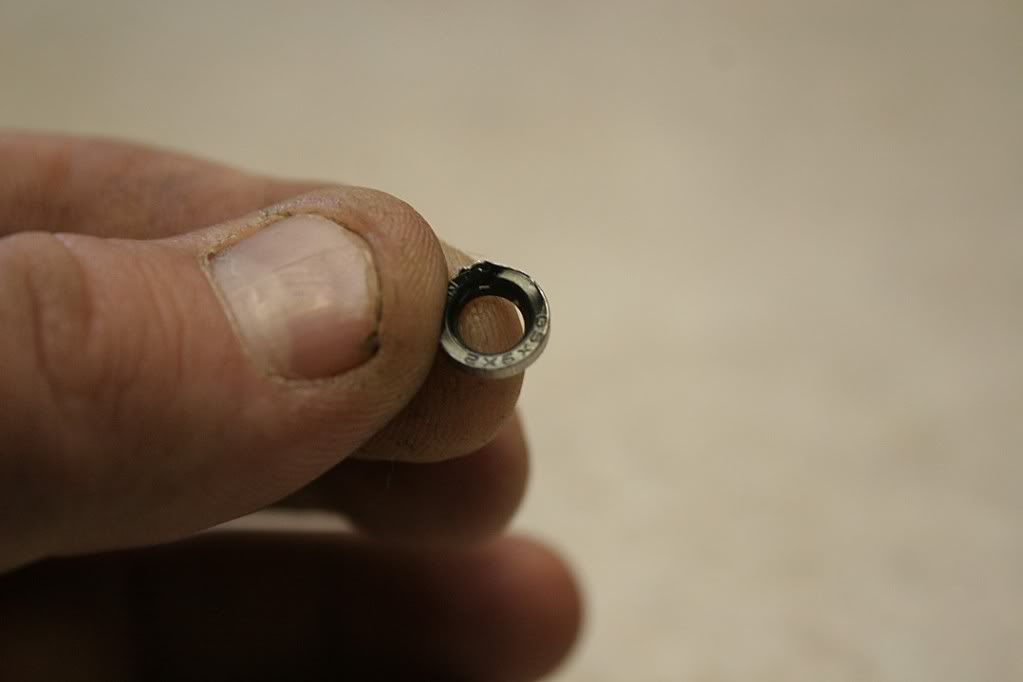

Heres some Pics, I called NTN and they said it was not theirs, OK then who made it with your stamping dies, but anyways, Look over the dirty finger and thumb, I took 2 different pics of the number one upside down and one the other way it could be 2 different numbers, but hope these help someone in helping me find one
Top of valve where seal came from

Seal numbers
seal numbers another way

That seal is just a wiper protecting the oring (or seal) under it....
if you grab the valve carefully where the backup/oring is pictured in the chuck of a lathe.....you'll be able to unscrew the cartridge valve and expose the seal that's leaking.......it'll be inside but you have to unscrew the assy.....
be carefull not to tighten the lathe chuck too much as it will squash the innerds of the valve.....this will hold on to it just enough......
polish the stem and housing where the oring rides (using the lathe), clean, lube and reinstall new oring (& backup if used).....:thumbsup:

that seal shown if not buggered too bad can be reused....once again, it's not a pressure seal but rather a wiper to keep dirt/contaminates from getting in....that seal's lip should be facing out.....
