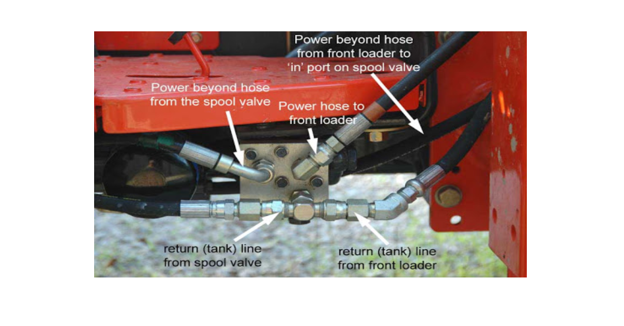

Jul 19, 2019 / Can Someone ID a connector #1 montelatici Platinum Member Joined Apr 5, 2007 Messages 630 Location Croom, Maryland Tractor Kubota B2601 and L3560 HSTC LE This is a nice photo by one of the members that is quite helpful. However, if someone could indicate the type of connectors and size/thread, especially the T-Connector, and the connector with a slight angle to it, I would be extremely grateful.
Jul 19, 2019 / Can Someone ID a connector #2 F Fallon Super Member Joined Aug 25, 2013 Messages 7,075 Location Parker, CO Tractor Kubota L4060hstc, formerly L3200hst It may be noted in my TnT install at https://www.tractorbynet.com/forums/hydraulics/295816-kubota-l3200-tnt-3rd-function.html I assume that's an economy L, which should add all be the same. Pretty sure they were all JIC fittings, but it's been a while.
Jul 19, 2019 / Can Someone ID a connector Thread Starter #3 OP montelatici Platinum Member Joined Apr 5, 2007 Messages 630 Location Croom, Maryland Tractor Kubota B2601 and L3560 HSTC LE Thanks, I saw and printed the listing of all the connectors.
