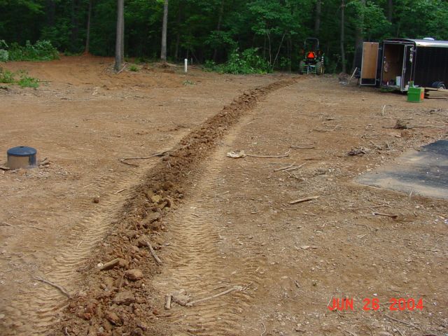

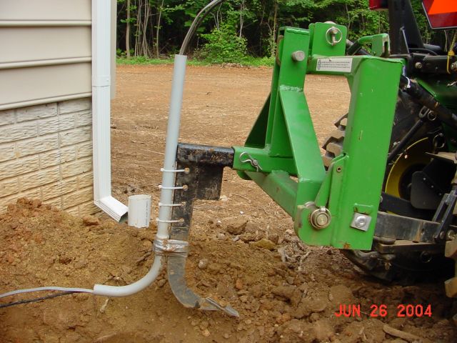

I would (and plan to) build something like this (sorry to whom ever I borrowed these pics from!)

It's a Mighty Mule opener, it is 12 volt DC wire that has to be run. I didn't realize that some gate openers were also 110 VAC.

BTW this "subsoiler" thing from Northern Tool looks like a plow I have already. The plow I have makes a bigger mess than my backhoe. I am trying to limit damage, that's why I thought of the rather slim ripper from Brotec.

montelatici, if you already have an implement that digs into the ground... why not remove the what I assume are large sweeps and install a chizel point only... and remove all shafts but one.... that's how I made my "subsoiler"
Tractor Supply has numerous points... you should be able to find one that has holes that will fit your shank.
