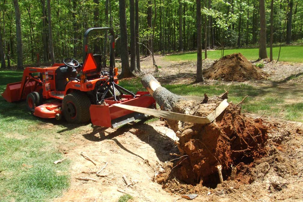

I'm not a fan of stump grinders. I remove all the stumps from my yard.
This is a large-ish stump from a double trunk oak I pulled out about 6 months after getting my tractor. Not sure if it was related or not, but I got a backhoe less than 6 months later.
Getting a stump with a FEL isn't too tough, it just takes more time and requires more chopping than with a BH. Obviously. But it is INFINITELY better than going it alone. Done that, too. No fun.
The trouble with pine stumps is that there is that tap-root that goes straight down in a way that is impossible to get with a FEL, axe, and sometimes a BH. I had a particularly stubborn pine tree the other year where I dug 3 feet down on all sides and it STILL wouldn't come out. It would flop around on the tap root, but I couldn't get it out. It would have been funny if it wasn't so frustrating.
And I would not let my chainsaw within 10 feet of a stump excavation project. That is, I wouldn't let MY chainsaw...if you don't care about what happens to chain or bar, have at it. But a very small amount of grit will chew both to nothing in ~5 seconds. And I'm not exaggerating. If you don't believe me, get out there with a sawz-all. Done that, too. You'll be trying to cut with what looks like a butter knife in under a minute. Dirt and grit does amazing things, sometimes.
Have fun, though. The smaller ones will pop out quicker than you think. And the larger ones will irritate you to no end.
