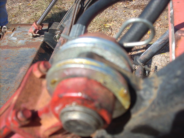

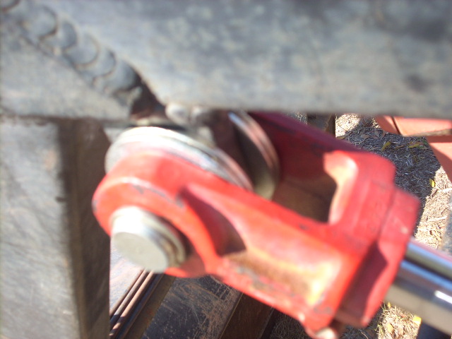

We have a FEL on a Hinomoto with Cross cylinders. If you take a look at the picture you can see that there is a big gap between the cylinder and the frame mount.
My questions are these.
Is there something that can be placed on the pin to take up slack so the cylinder doesn't wollow around so much?
Can I make some shims of some sort to fill the gap?
Are there spacers made for this?

You can make some bushings out of small pieces of pipe, I would make 2 so the cylinder is centered on the mounting tab.
/ Can this be repaired, modified or improved? #3
just stack an equal number of washers on each side t center it
tommu
/ Can this be repaired, modified or improved? #4
tommu
I would add to your suggestion using SAE washers. The O.D. is not as wide as USS washers.
/ Can this be repaired, modified or improved? #5
I would check the other end connection too.
Then I would make sure to line up the cylinder(s) so they push and pull in as straight a line as possible in line with the fel arms and shim it accordingly. This is to insure best performance, power, and least amount of wear ... so there is no sideways vector force on pin or mount, or as little as possible.
A little slack is no big deal.

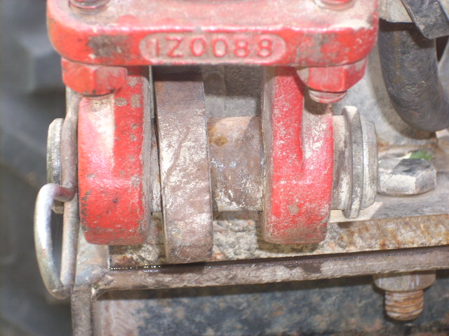

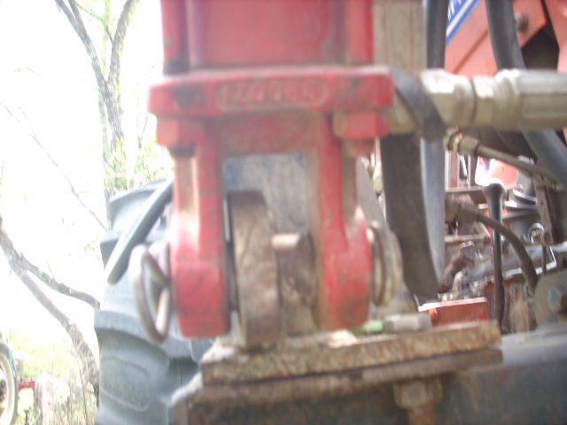

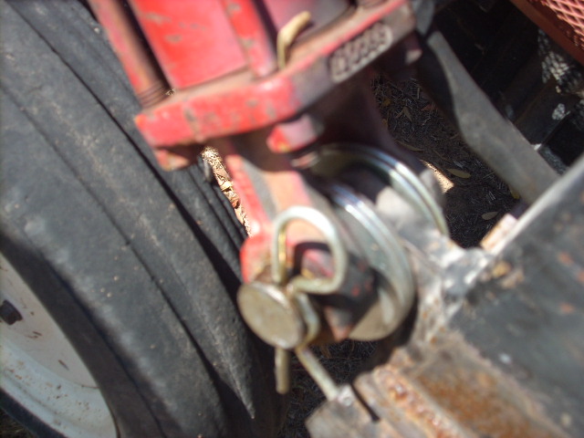

Well I took my measurements and decided that going to Tractor Supply and buying a bunch of washers by the pound would work.
I ended up getting two washers on each side of the cylinder ends and the FEL tightened up real good.:D
I put axle grease on each side of the washers and on the pins.
I took the tractor on a ride around the foodplot making sure to hit as many gofer mounds as possible and the FEL was riding a lot quieter and not wobbling so much so I was very happy with the results.
Yesterday we used the bucket to stretch some barbwire around the big hog trap to keep them from digging out and the reduced left to right slop was really nice.
Total time spent on the actual install was less than an hour.
Cost of materials was around $10.00 for the washers.
Thanks to all for the help!

Getting rid of excess play is always nice, but do take note of 3RRL's mention that a little play is ok. If you remove ALL of the play, and the loader isn't exactly lined up, or moves a little, it puts an enormous amount of pressure on the ears of the cylinder which will cause a failure that you won't fix for $10. If you have no slack at all, remove one washer or install a thinner one instead.

Hummm? I need to recheck my work.
I know I had one that ended up with very little play.

I'd just take one washer out and not worry too much on a machine that size. All of the cylinders on my machines have some side play.
