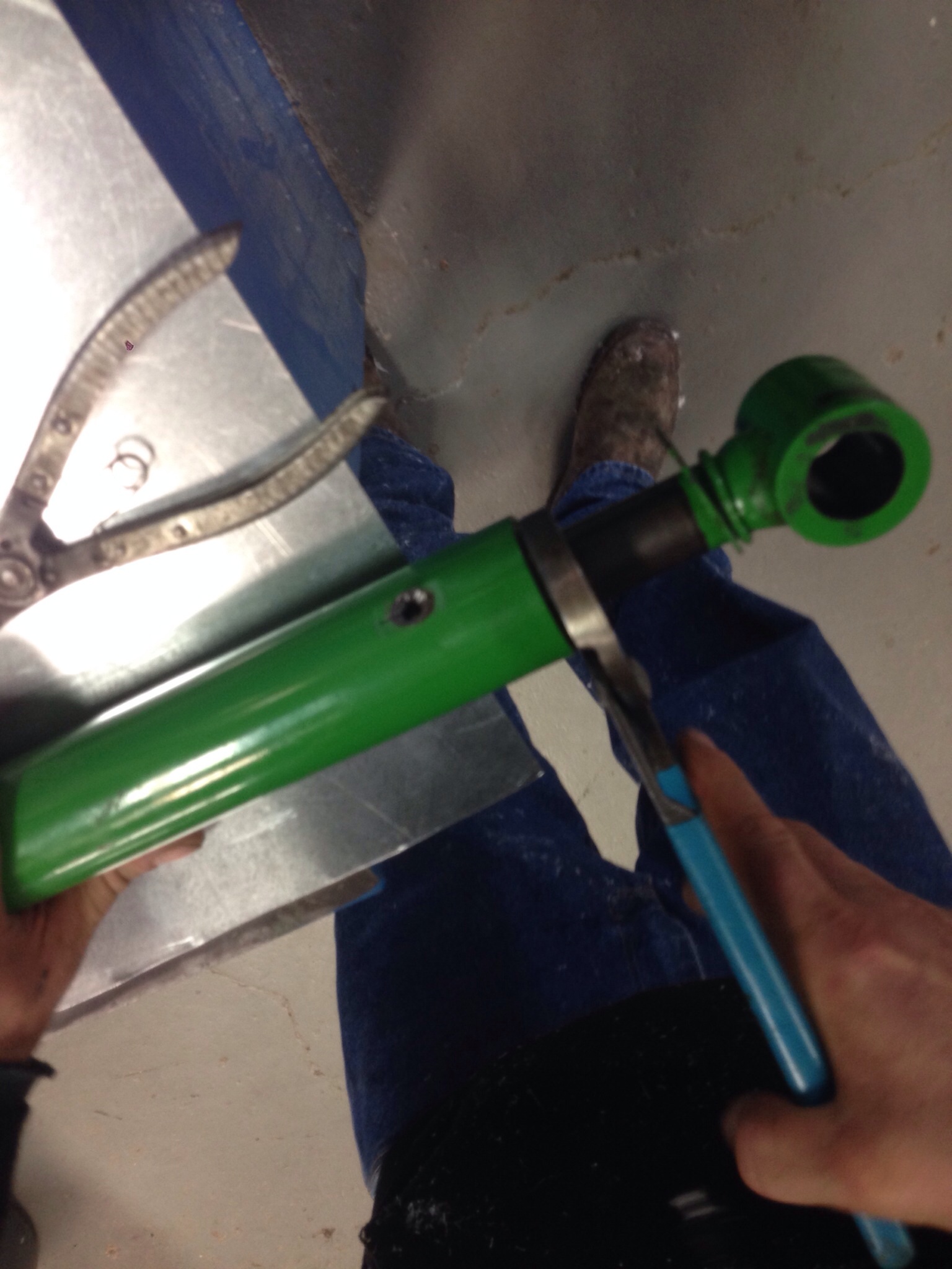

Thanks guys. I did get it apart. There is a tool that comes with the rebuild kit. It's a ring that has to be put on so the internal gland ring can slip past the groove when pulling it out.
I appreciate all the replies.
/ Can this be repaired ? #22
Yep, shook my memory, I've rebuilt those. Glad you got it apart.
