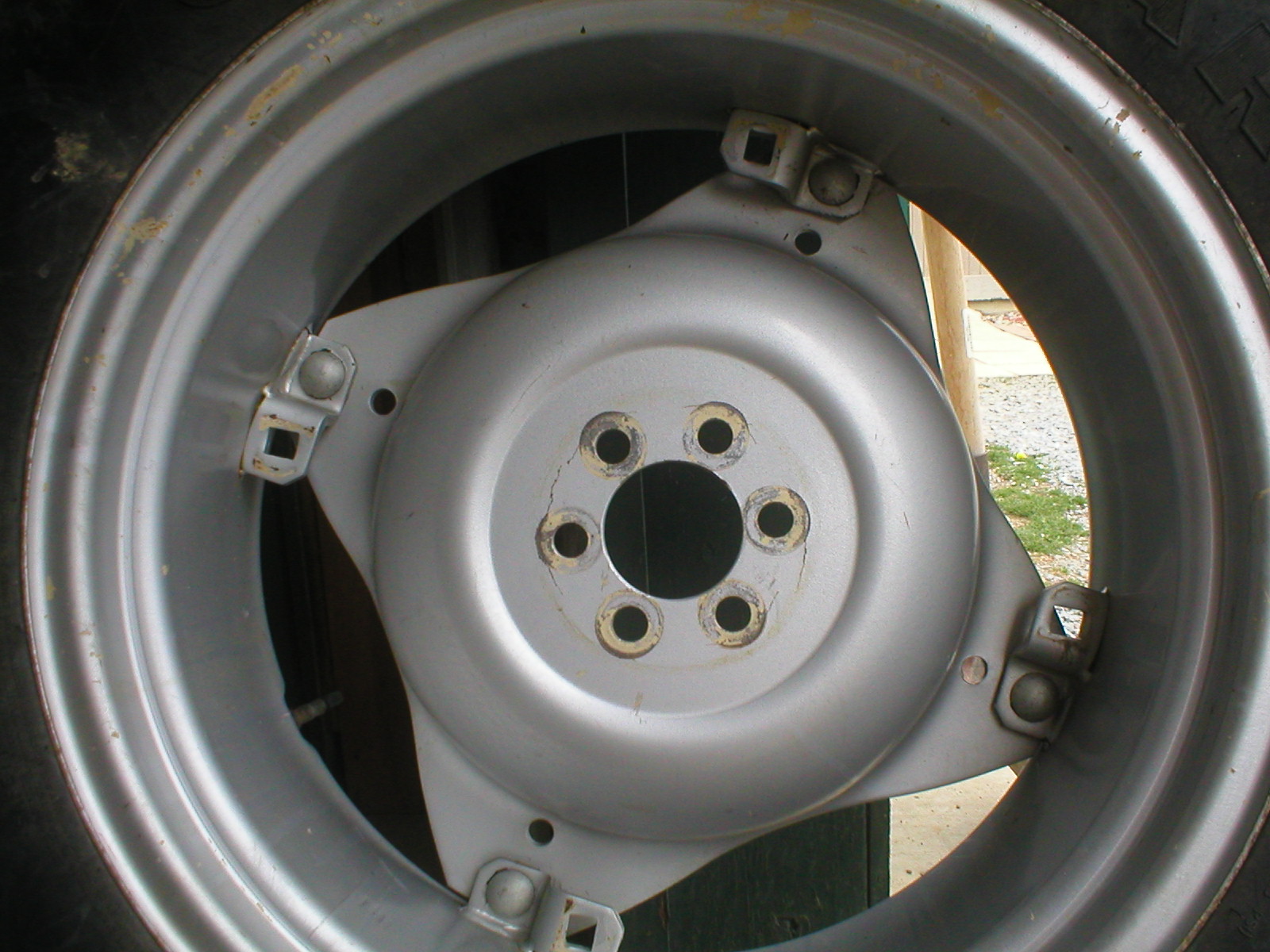

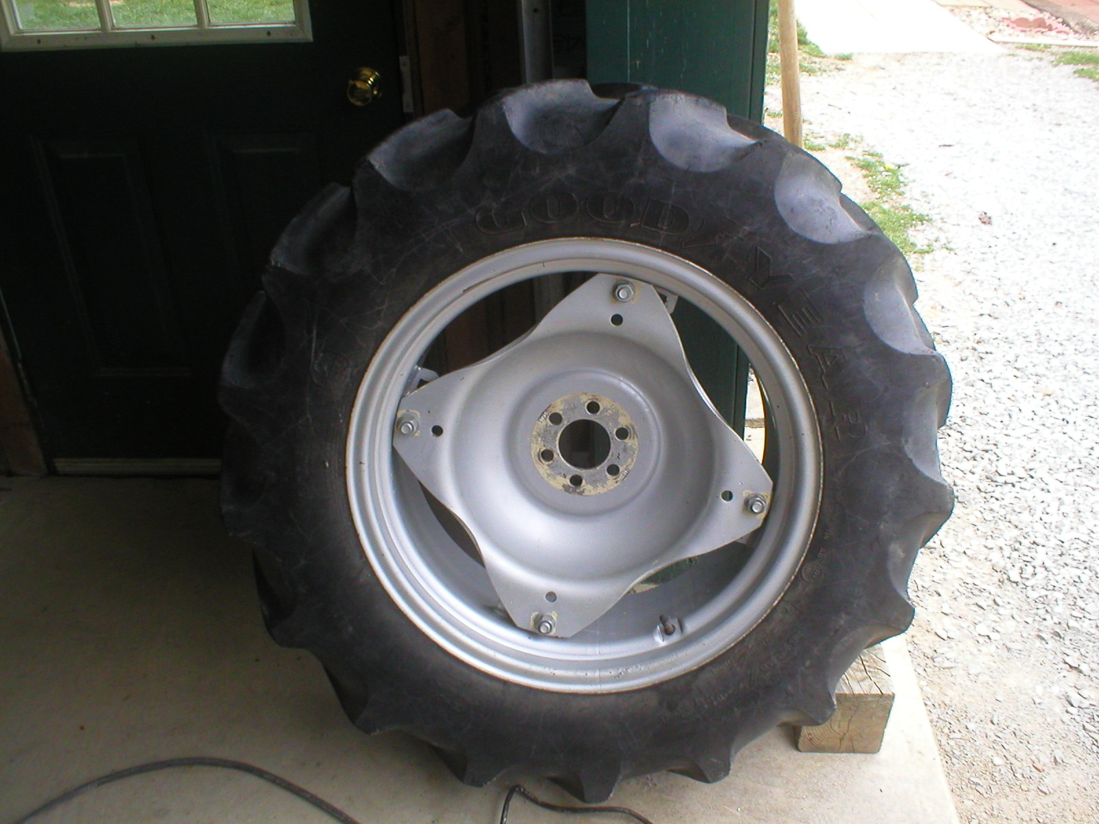

The front wheel on my 5660 Agco Allis four wheel drive is showing signs of a hairline crack around the 6 bolt holes. See Attached pictures. Can this be fixed any way or will I need a new hub?
A new hub is $550. plus shipping , I have tried to find a used one with no luck .

Hello
At that price it would be well worth a try.
You would probably need a machine shop to make you a new center,
and then have it welded in place.
I would clamp it to the existing one and and have welded on the OD of the
plate to keep it square.
I think that if you try to repair the cracks only, they will crack again.

A machine shop would make it easier, but in reality it can be fixed a couple of ways. One way would be to grind out the crack, weld it back up. Or make a larger diameter circle and drill the bolt holes, being careful to make the holes "exact" and use a tool to champer the edges just like your wheel is, then sandwich the wheel in between them. Add some really good security, and do both! Then weld the disc to the rim!(Note, the side that matches up to the wheel should have as much surface contact as possible, so the dimples and ridges need to be matched together.so they don't interfere with each other)

You can add some life to it by getting a circular spacer made up for both sides and making a sandwich out of them. Make it as large as will fit in the hub.
The wheel has been overstressed probably by too much wheel offset. I suggest you reset the front wheel track to rim and hub spider positions such that the center of the tire is in the same plane as the center of the hub bearings. The bending moment caused by a lateral offset is pretty hard on wheels like these. All you really need is a new spider, though, the wheel seems fine. Most flat wheel disks like these should use lugs with washers. Too low an air pressure combined with too much toe in (or out) can cause this type of over-stressing. Its not so much overloading as the number of cycles (revolutions).

I'd weld it (stop drill the ends of the crack first) and add a doubler plate to the outer surface (weld it on). This isn't a high speed application, so perfect balance isn't required.
Just keep an eye out for a replacement wheel. You may need it sooner or later.

Hub?? we call them centers.. but anyhow.. i agree with the others.. weld the cracks up then scab a plate on to it probably as large as the big part of the center circle then line the holes up and drill em.. then weld it in. not sure how much stud you have to work with.. so something like 1/8 on each side.. or maybee 3/16

to all of you claiming that the tire must come off the rim.. did any of you actually look at the pictures??? the center can be removed from the rim with 4 bolts... take the center to your work bench and have at it.. leave the poor tire seated onthe rim where it should be... :(

i would grind slot in cracks weld from back, then make a 1/4 plate od to meet that radius on hub cut big hole out in center, then weld it to rim drill out bolt holes, u mite need longer bolts ,be shure to use cold roll steel not hot roll.

i can't make it out real clearly, but is that the crack that looks to run nearly all the way around the outside of the bolt holes? looking at the condition of the rest of the wheel it's hard to believe that it's been stressed enough to crack that badly without any catastrophic damage elsewhere to the rim - especially on a front wheel. forgive me for asking, but it does go into the metal and not just in the paint/powdercoating?
if it's cracked on one side, i'd just have the crack cleaned and welded. grind as necessary to put the lugs back on. if it looks to be cracked nearly through, possibly reinforce it by welding another plate to the wheel. check and see if anyone around has a cnc burning table that can cut you a precision center that can be welded in. today's plasma cutters, when coupled with a cnc controller can cut good quality bolt holes - especially for a low speed application. i've seen people on ebay making cnc parts for around $1 a pound. even if you used 1/4" plate, you'd only be in about $10-15 plus shipping for a piece that is a perfect fit into the center of that wheel.
