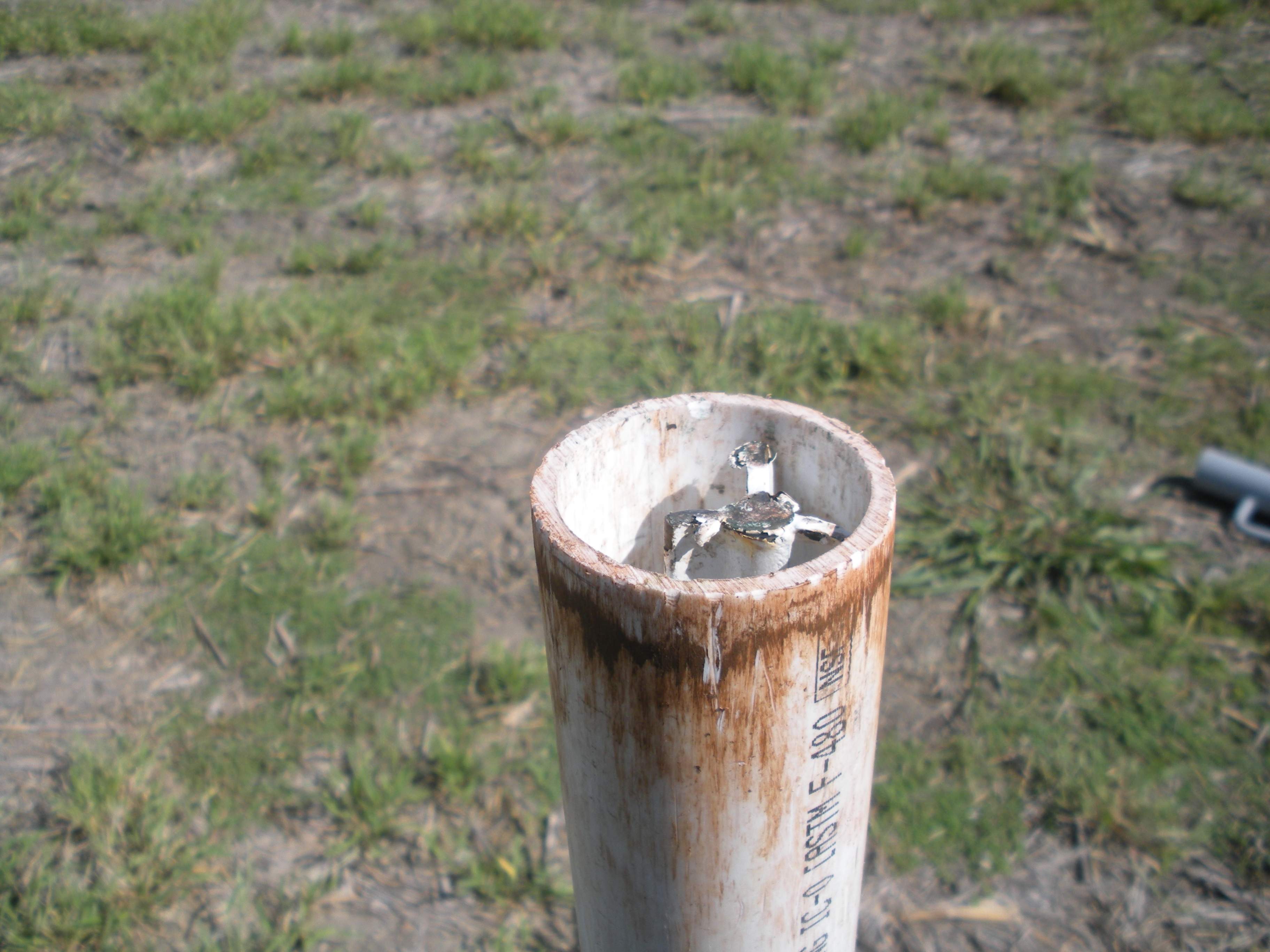

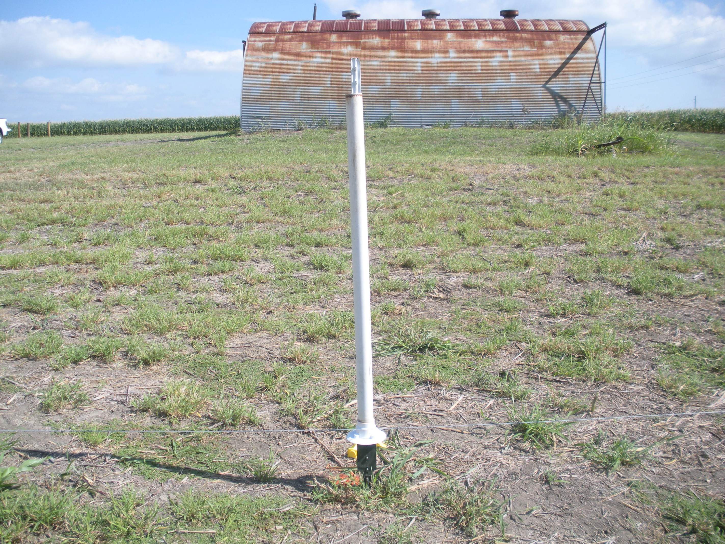

I have used the FEL on my Kioti DK45 to push in almost 100 metal t-posts. I made a spacer from PVC and a pool drain so that it was easy to gauge how far to push the posts in. Once the end posts and snap line is in I could put 20-30 posts in the ground in a couple of hours.
Not sure how well this would work with wood posts. I would think the ground would need to be fairly soft and the point on the post end pretty well centered. Might be worthwhile to fab up some kind of metal cap to slip on to the post top to keep from damaging the post.
