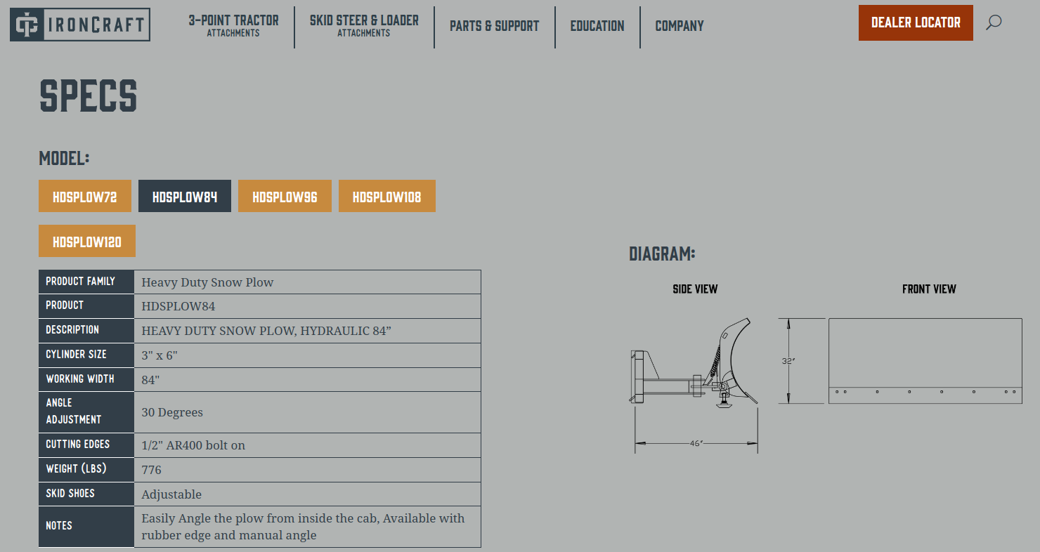

What I am after is some advice for my specific situation : half a mile of asphalt driveway in pristine condition, i.e. I do not want to see it damaged.
My tractor is a 60 HP Kioti compact and I do have the third function installed.
I am on the fence between a snow pusher and a hydraulic angled blade. Both of them obviously with rubber edges to protect the driveway.
I contacted 2 local dealers and have obtained the offers below. Please do note that I live 'on the other side' of the PNW Cascades and getting implements shipped here is costlier compared to living on the i-5 side of the mountains.
Currently I use an ATV with a manual angled blade and it costs me nearly half a day to take care of the property after a snowfall. In view of rather tight security on my property I do not want contractors to take care of this. I am an ex finance guy, so I do want to buy biggest bang for the buck. Having said that, I won't make concessions on quality.
After my lengthy introduction, here we go :
1] Braber Equipment FBS7B0500BK Agriease front blade with hydraulic kit : 2,624$
My front bucket is 72", so I assume that with a max 30 degree angle I have to go for a 84" blade
2] Ironcraft Heavy Duty snow plow with rubber edges : 2,995$
A bit more expensive than the Braber, but 250lbs heavier....
3] Rankin 90" snow plow with hydraulic kit : 4,840$ (ouch !)
I have a Rankin box blade and absolutely love it, but on the other hand that is a semi permanent attachment. This snow blade would only be used a couple of times a year, so I do not think I need to pay for the Rankin name on that one.

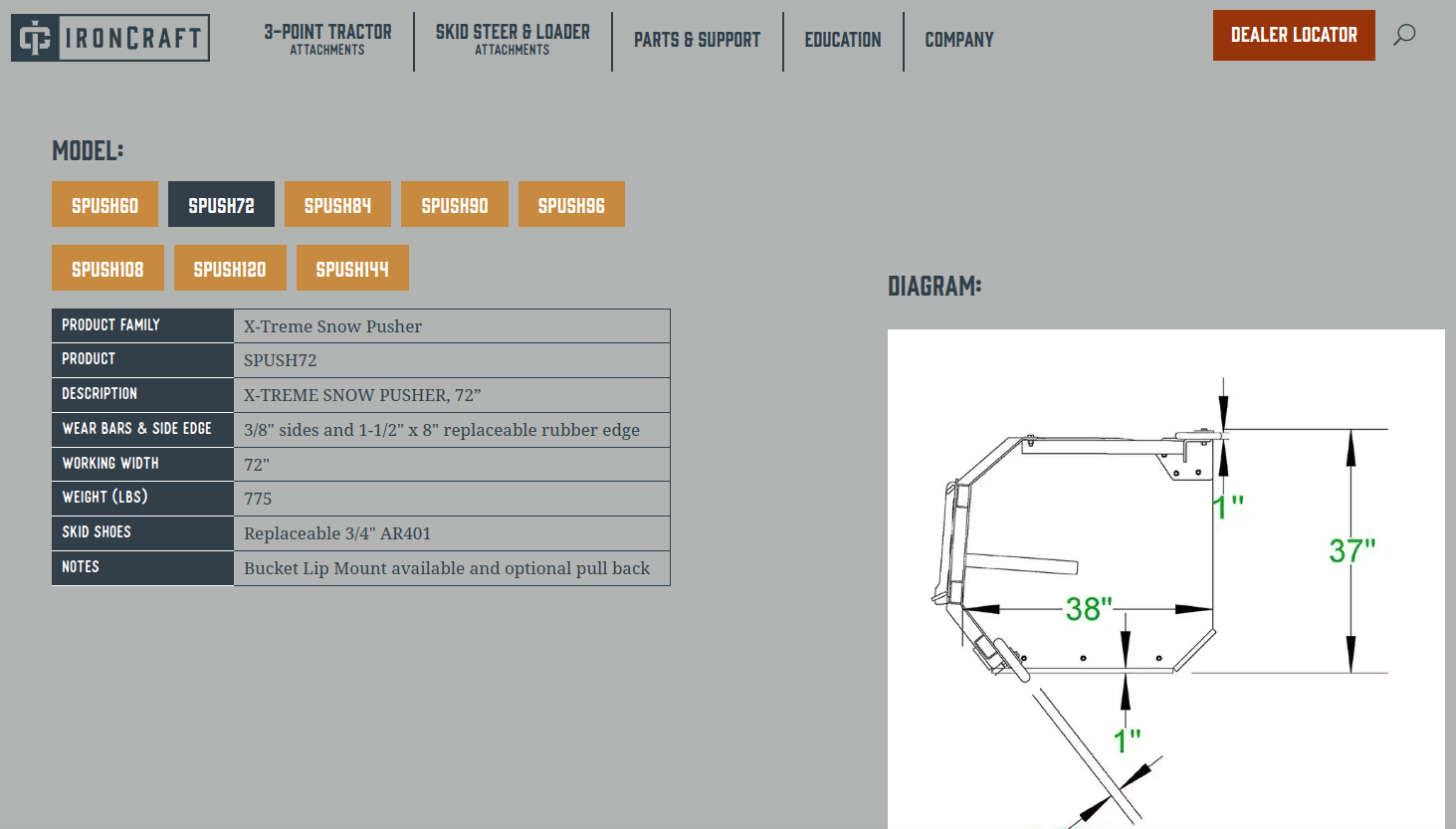

4] Ironcraft Snowpusher with rubber edges and pull back SPUSH72 : 3,000$
5] Worksaver Snow Pusher :2,175$
Quote doesn't seem to include the pull-back.

Snow pushers would be a pain on long stretches. Definitely get an angling blade, front or rear.
Also, give serious consideration to skipping the rubber edge and get a UHMW Polyethylene edge. They last longer and cut better than rubber. I run them on my front ssqa plow and rear blade, and they work very well.

If you are not concerned about the snow banks along side the driveway an angled blade would be quicker than pusher since the pusher catches the snow like a large scoop.
