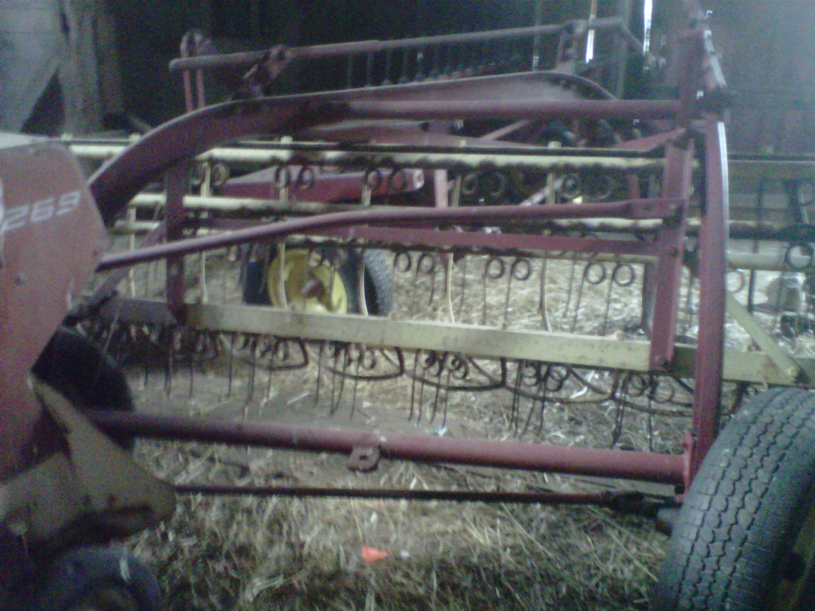

Hey guys im tryin to identify model of this hay NH hay rake by photos I got. I need to identify so I can get specs for it to figure out how im goin,to load n wat trailer to take. Only askin 400 n I thibk thats a steal. Thanks all

It looks like my Model 56.
   / Can you Identify this model NH hay Rake? #3
Yea it looks like a 56 but I need pic of the rear driveshaft to tell.

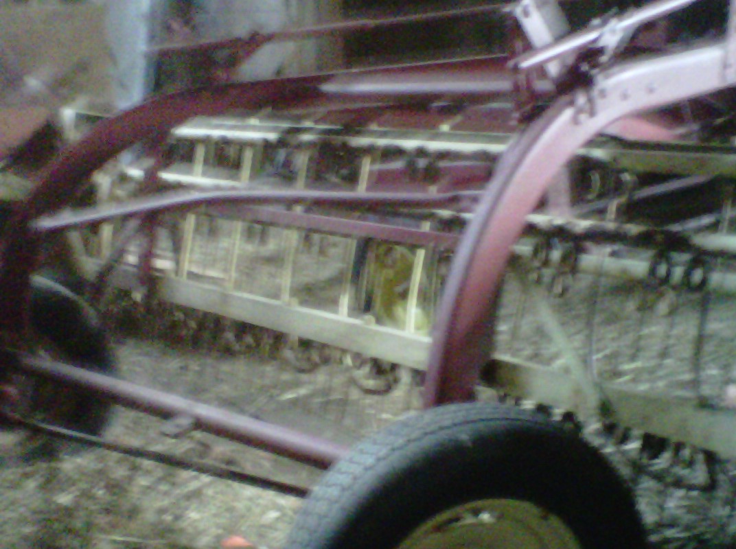

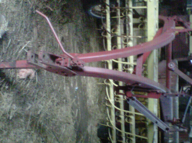

These are the other 2 photos that did not load. Hopfully this will show ya what ya need. Thanks again. Im hoping i can winch it on the 8ft wide deck over trailer i have. They have no loader there to load it.

Is the NH 56 a good model and what's it worth?
   / Can you Identify this model NH hay Rake? #6
What is the difference between a 56 and 256?
All I have seen are teh 256 rakes, just newer?
   / Can you Identify this model NH hay Rake? #7
the 56 has the fold down jack like on the 55's the rake in the pictures is a 256 and the only difference between a 56 and 256 is the jack on the 256 that crank's down instead of fold down. All other parts will interchange on the 56 and 256 rakes
the differnce between the 55's and 56 is the 55 has a straight shaft between the wheels and on the 56 the right hand wheel is placed further ahead and has a shaft between the two wheels that contains u joint on each end.
it could range between 350-2500 just depends on the teeth the bearing in the end of the bars and the bearings in the stars on each end also the over all shape of the rake also would need to check the bushing's in the hubs
So you are saying its a 256 for sure?
