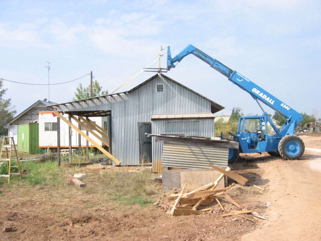

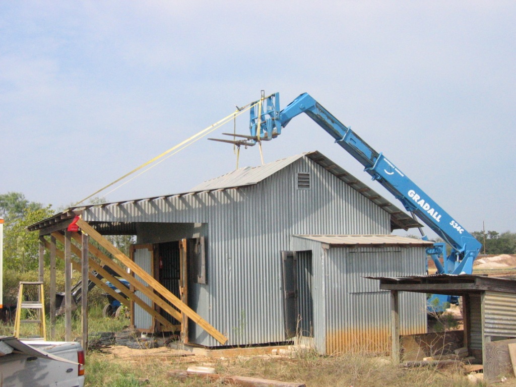

I moved a barn for my |FIL last year with my forklift, will see if i can find a pic of it. Maybe you can rent one ofthese forklifts and do it yourself over a weekend. It was really pretty easy we made a spreaderbar to distribute the weight and picked it up through the center of the roof. We carried it across a pasture for about 500 yards to its new home. Going to look for pics.
   / Can you move a pole barn? #16
some photos i found
