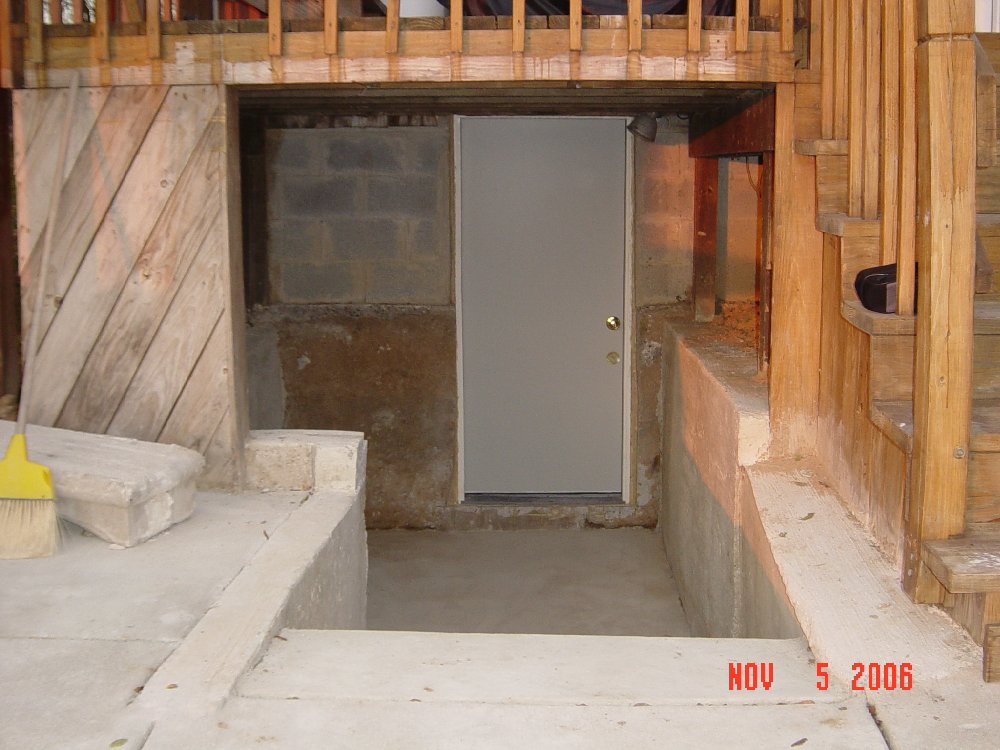

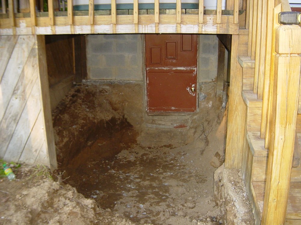

I modified the door today. First I resized the frame to fit in the rough opening. Then removed 6" from the bottom of the door. Took the piece that was cut off apart to get the wood and the seal from it. The wood was 3/4" thick. Then used a router to trim the foam inside the door to 3/4" deep so the wood would fit back inside the door. Sanded the rough edge with a sander and caulked the wood and seal back in place. Took about an hour to do. Getting it square inside of a concrete rough opening is another story.

Just to show how it turned out here are before and after pics. The door opening ended up to be 6' 1/2"

Yikes, You scared me with the first picture. I thought that was the new one.
The new one does look good though, I think I'll try it.
