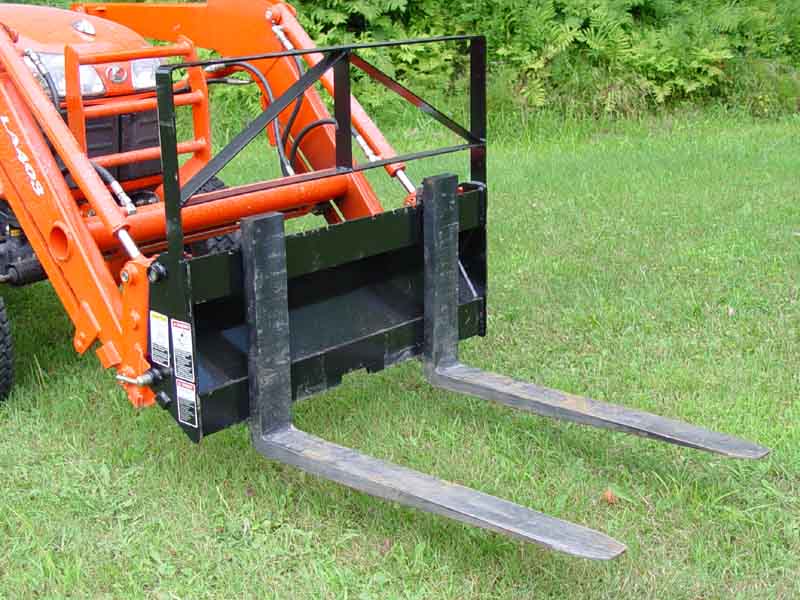

Last one (for now... I need extra lights for next winter) is a quick-attach and forks. It's the pin-on type. Ok, you have to step down of the tractor to put/remove the pins but it costs nearly 3 times less than a Skid-Steer type quick-attach. It takes around 25 seconds to do the job. The rated capacity of the forks is 600 lbs. The rated capacity here is not the capacity of the frame or the forks in themselves but it's what the tractor can safely manage. I move 1000 lbs with it but I nearly tipped over when I lowered the load (and the backhoe was mounted). By experience, I can say that you can easily manage 750 to 800 lbs safely. I loved the forks. I use it for different kind of works (not just pallet moving), for instance I use it to move trees from place to place. First I dig around with the backhoe to make a nice bundle of roots. After that, I plunge the forks at angle below the bundle of roots and I pop out the whole package (in fact, I should make a post about that with pictures, it's pretty impressive the way it's done). And that's only a glimpse of what I do with forks.

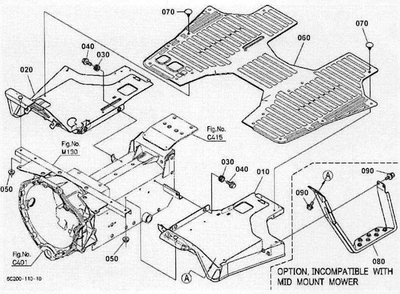

Here are the part numbers:
step aid: 6A700-51350
bolts (4): 01125-60816
I just looked at TractorSmart.com and the step aid is listed at 13.70$ and 2.50$ for a pack of 10 bolts. It's pretty cheap to ease the step up/down so much.

Stef, do you have to drill holes for the step aid or do they already exist on the tractor?
   / Candies for B3030
#9
The holes are already there. In fact, the nuts are already welded on. It's very easy to add that step aid. For the price of the machine, Kubota should have included this option when you buy the tractor. As I said, it's not compatible with the MMM and this is probably the reason why they don't include it.
Here's an exploded view of the step.
If you look beneath the step it's easy to see where the bolts go on.

Stef, Unless the part numbers are different, I have a step aid that came standard with the 3030 cab model and the 72" MMM. There appears to be no clearance issue between the step and the MMM.

bwvfan, the cab model is not the same thing at all. The steps are not the same. You can get on a B3030 easily without a step aid, but it would be much more difficult to do the same with a cab model because you have less room to move.

Did you put a step on each side? I don't do it very often, however sometimes I do dismount the tractor on the right side. With your remote loader stick, that might be difficult though. Are the step(s) you bought already painted Orange #2?
   / Candies for B3030
#17
3030PJ, the step aid is only available for the left side and yes it's already painted orange. You buy it, you open the box, you bolt it (around 2 minutes maybe) and you're done. That's all you have to do.

   / Candies for B3030 #19
I also bought the step for my B3030 back in May. For those that are wondering, it says it wont fit on the tractor with a MMM. I figured it was cheaper to by the Kubota step and shorten it to clear the MMM than it was to build one from scratch. To my surprise, the step does clear my 72" MMM when its all the way up and pinned. (only about 1/4" of clearance) Of course you don't need the step with the MMM on because it has a step, but it does come in handy when the MMM is off, or when the front rotary broom is on.
