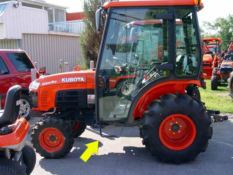

The step-aid was attached to my L3130 when it was delivered. Maybe they are standard on L-series now? I really like the FEL controller btw.

2 minute job. Thanks for the info on the step. It works well. Much easier step.
/ Candies for B3030 #25
I put my step on today and it makes the deck and especially the fender move quite a bit more than just stepping on the deck. Does anyone else notice this? Whats up with the flexing deck and fender anyway? I looked underneath and there isn't much support under there? Is it this way with the older models? It seems a bit of steel support could have been used here. It looks like over time your deck will rip out of the fender. /forums/images/graemlins/confused.gif
I like my B3030 but I am wondering if they skimped a bit in a few areas.

Yep... I notice the flex too and I worried about it too at first. Over all, when I look at the B3030 I understand now why it's so lightweight. The sturdiness is deficient caused by a lack of steel plates everywhere. I love it but I keep in mind that it's not a tank.
