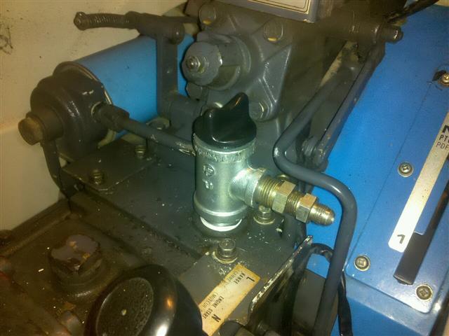

Here is how I decided to do it. Gathering ideas from this site, but I really wanted to still be able to use my original dipstick. I will make an extension to the dipstick rod to compensate for the extra pipe that has been added.
Greg

I also added more pictures of my power steering progress on my other post
   / Cannot figure out how to return back to tank / resevoir? #13
Actually my Kubota had no dipstick, just a fill plug. But then again, its just a Baby tractor. Your set up looks good.

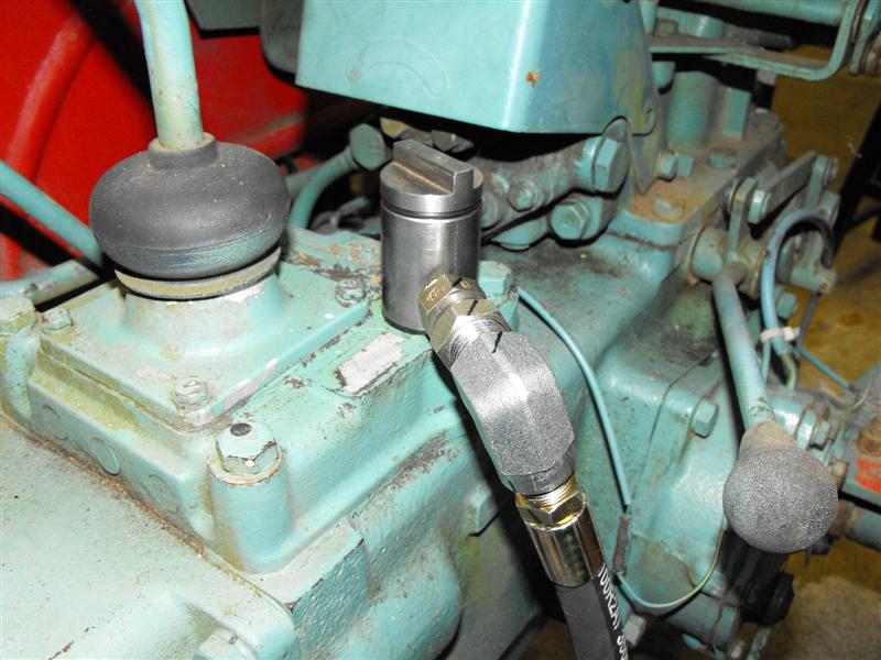

   / Cannot figure out how to return back to tank / resevoir? #14
I did the same kind of return line setup on my Yanmar because there were no return lines to tap into. So far it is working great.
