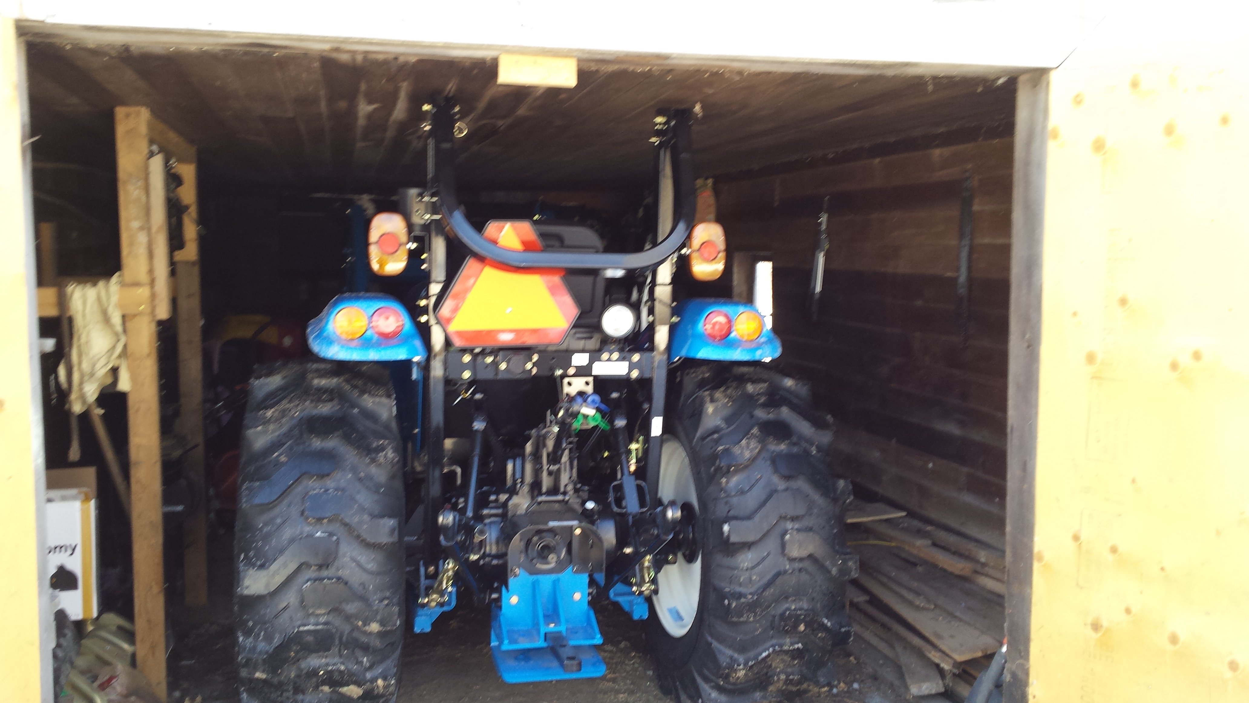

Dealer picked up the Boomer 40 this morning. He could not get the bucket to lift and curl either. I do not feel stupid anymore. Says it is an adjustment. If so, why not get it set up before sending the unit out?
Anyway, moving on. Called the LS dealer today and getting the XR4140. More tractor for the same money. (50% more lift capacity and 25% heavier than the Boomer 40 for $700 more OTD after trade)
I really appreciated the NH dealer letting us demo the unit. Dealer is Don's Tractors in Alpena MI and they are good people. They offered me the most for my trade. I would have considered the Boomer 45 but it will not clear my garage opening so never worked the numbers on it.
are you sure the xr 4140 will fit if the boomer 45 wont? I was under the impression they were close to the same tractor. i know my xr 4140 is roughly 76 inches to the top of the folded ROPS, off the top of my head. like you i only have so much space :)
Both the dealer and I measured it and it looks like it will fit. It gets delivered next week and we will know for sure.
