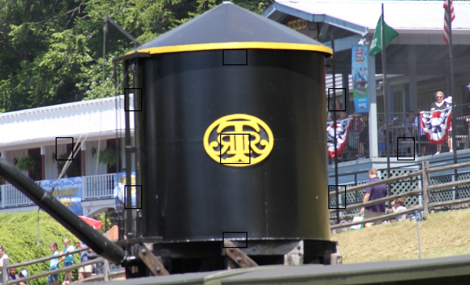

The girl holding babies is a 2013 photo, the railroad water tank and kids was just two weeks ago.
   / Canon SLR Troubleshooting and Comments #37
Railroad tank was a 1/200th exposure at 135mm focal length. ISO 100. I'd say that is getting close to the point that one can expect camera movement to create unsharpness. Back in the old days when not everyone had telephoto lenses, a lot of photography was done with 35 and 50mm lenses that has apertures of 1.4 or 1.8 and a camera can focus those lenses a lot better than they can a zoom lens with an aperture of 4.0 or even 5.6. Get yourself a cheap 50mm F1.4 lens and see how that works for you. Why not run ISO 400 ? that would be 2 stops more safety or an exposure time of 1/800 and then I think the image will be sharper. Modern digital SLR's do not suffer nearly as much from noise at higher ISO values than the old ones.
The image in front of the water tank is clearly out of focus and nothing behind the water tank is critically sharp either. So to me this does not look like a focusing problem.
Crank up the ISO value all the way to 1600 on a contrasty subject and see what you get. Use a tripod and focus critically (manual focus) and then take the image with a remote or the self timer.
   / Canon SLR Troubleshooting and Comments #38

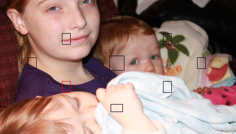

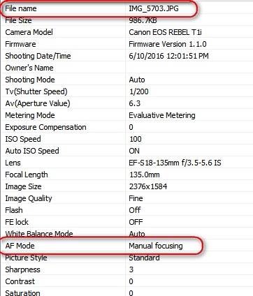

Check your lenses that they are on AF (Auto Focus). I opened the images below in Canon's DPP and turned on the focus point indicator (the boxes in the AF matrix). Your older image shows the red AF points where camera grabbed focus at. The newer "tank" image has no AF points illuminated and the shooting info shows the focus mode is "Manual" for that image. I'm not sure that the AF can be put manual within the camera, so if the lenses are set to AF, then it's likely the camera may be at fault or the camera is not receiving the lens focus status correctly.
You had said you cleaned the contacts and those do convey the focus status to the camera. Perhaps try cleaning them again, both the on the lens and camera body if the lenses are indeed set to AF.
