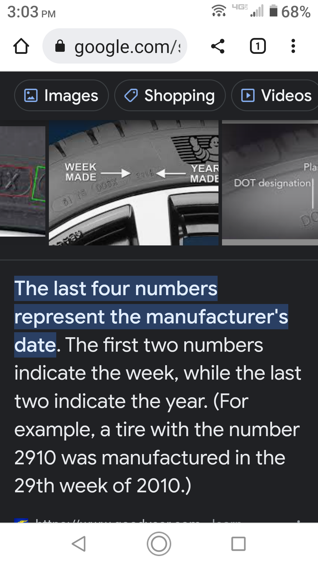

Not many folks can understand or bother to read the 4 digit date code on tires imo. If I'm spending about 1k on load range E or better tires I do.
