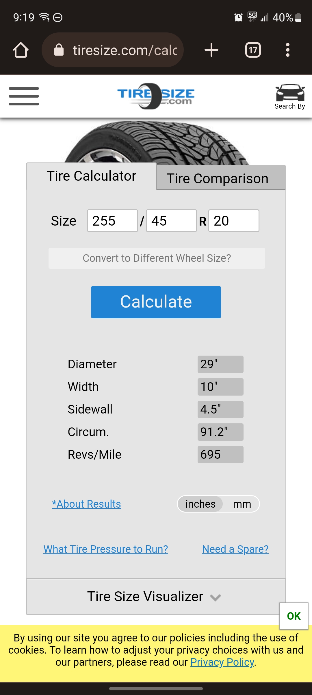

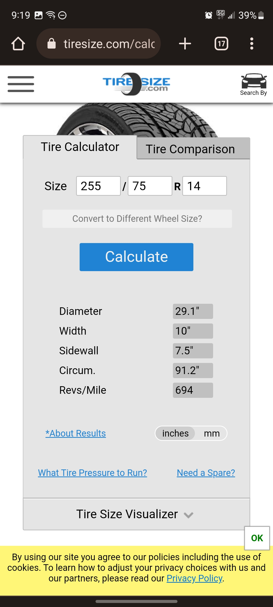

. Only way with fenders to widen the contact patch on the ground is lower the aspect ratios
That's just wrong. Here are two tires and wheel sizes with same width and circumference with vastly different sidewalls. The reason for low pro tires are larger diameter
brakes, looks and that's what people equate with high performance street car.
