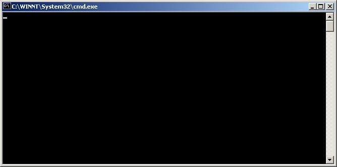

Help ! Norton antivirus has indentified a file as a IRC type Trojan Horse. Norton can't quarantine or delete. I can't delete the file either. How can I unlock this file so I can get rid of it?
See attached image.
I need 'DELETE' extra strength !

Ok...
From the image on your attachment it looks like a printer driver problem.
ReInstall your drivers for your printer from yor printer installation disc,
Of course you will have to uninstall it first.

Apparently, your OS is NT, Windows 2000 or ?
First, go to the Windows upgrade website and find any info you can on this "virus". Hopefully, there will be explicit directions on how to delete it. You may want to print out any instructions, especially if you have to reboot or go into your system registry.
This also might work:
Do a CONTROL-ALT-DELETE and shut down all programs except Explorer and Systray. Since the suspect file is also named Explorer, that may seem to be a problem. However, if you shut down Windows Explorer, the shut down menu will pop up. Obviously, that's not the Explorer application you want to shut down. If there is another Explorer (maybe called explorer.exe) shut it down. Once shut down, you should be able to delete it then.
Or:
Do you know how to start you computer in SAFE mode? If so, try that first. SAFE mode only executes certain applications required to run the computer. Once in SAFE mode, you may be able to delete the suspect file (as it won't be in use)
Those are two potential fixes. I'm very surprised Norton can't quarantine the file. However, if the file is in use, you cannot normally delete them until they're shut down.

Thanks to all that responded. Starting in Safe Mode did the trick. The file may have looked like a printer driver but it was a virus hiding and masquerading in that folder. Also, the use of explorer in the name was designed to confuse as well. I've deleted the file, now I need to backup and check the registry and win.ini. An application is still being called for at boot-up even though it is gone.
