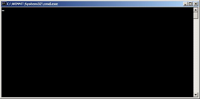

Are you still getting funky messages on start-up? If so, write down the name of the missing file, start your registry editor (either regedit or regedt32 from the Run box) and do a search for that file name. If it finds something, don't delete it if you're not sure about the results. Rather, post the registry path here so that we can decide if it's safe.
This may or may not be a result of a trojan or virus. Sometimes it happens as a result of a poorly written uninstall program.

Yes, I do still get a window of sorts at bootup. It goes away on its own after a few seconds. I'll post better info when I get home. I appreciate your help.

Ok, I generated a picture of the window I get at bootup. It goes away after a few seconds.

Jerry,
Something is causing Windows to run a program from a command prompt, i.e. cmd.exe. I did a search at microsoft.com on cmd.exe and got lots of hits. You might try to look at some of them to get an idea of whats going on.

Suggest you boot from a clean DOS diskette.. get Windows out of the way completely. Then navigate to and delete the file. You may need to set the protections on it to allow deletion.
When Windows is running, it holds some files open so they can't be deleted. When you boot from a DOS diskette, those files are free to be renamed or deleted. Make sense?

Like the Inspector said, something is calling the cmd.exe program on startup. This isn't necessarily a bad thing - it depends on what program is calling it.
For kicks, open regedit and check the following key:
HKEY_LOCAL_MACHINE\Software\Microsoft\Windows\CurrentVersion\Run
Check what values are in there. These are the things that will run every time you boot your machine.
