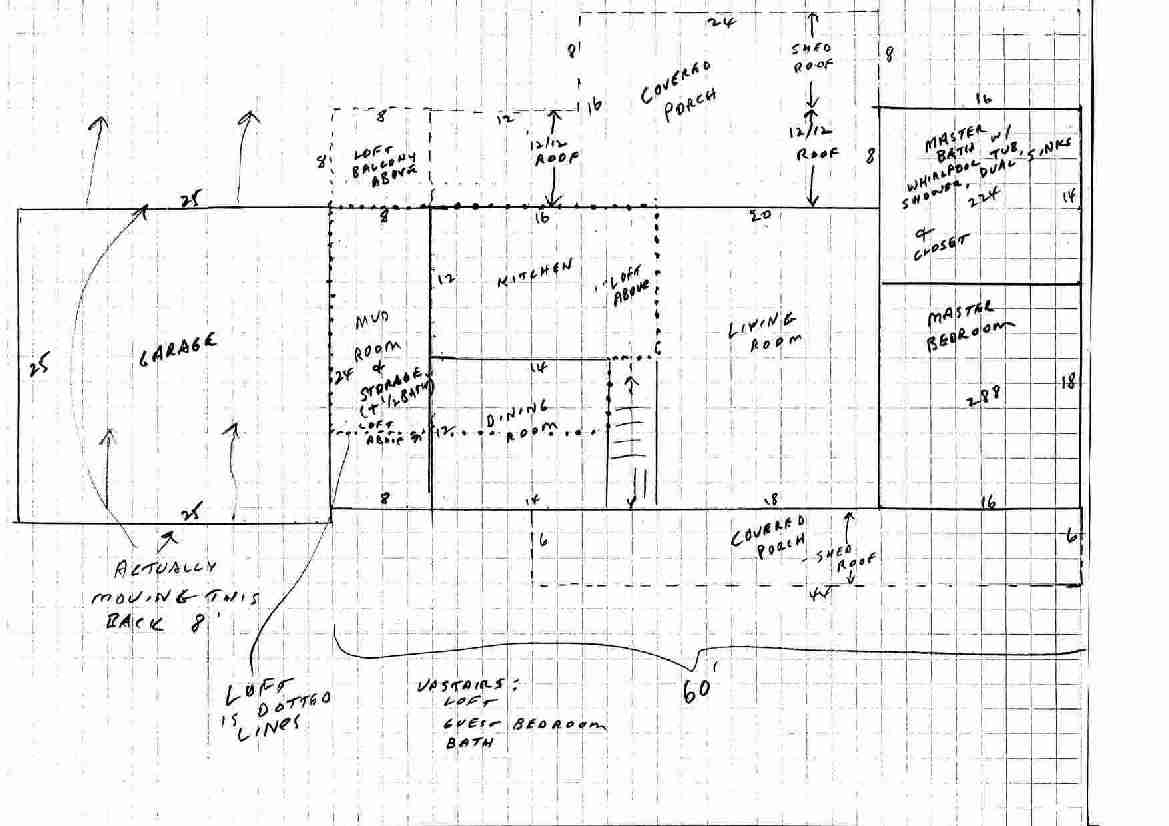

I have my drawing at my office. I'll scan it in and post it tomorrow (Tuesday). The drawing doesn't show doors and windows, just spaces. Very rough. I have put it in Punch software to get some idea of the roofline etc, but the software is not very good and I can't do shed porches or dormers on it. Also can't figure out how to have a second floor in part of the house and a catheral in the other part (in the software that is).

Eddie, I considered using some sort of trusses to give me an "attic" space above the cathedral ceiling, especially to give more room for insulation. However, I need the high ceiling for the loft area, but maybe it won't matter that much. As for insulation once I decided to use foam it became apparent the attic space is not need for that, but would sure come in handy for mechanicals. Heck even electrical could be a big problem with no way to get from one end of the house to the other without drilling through the rafters that are already holding up alot anyway.
I had figured on the gluelam beam with the opposing rafters connecting above the beam.
There will be covered porches front and back so the wiring might could be run in there. However since it is sealed off from the attic, I wonder if it would need ventilation of some sort.
I have read about the high velocity A/C systems but I don't know if the HVAC guys around here know anything about them. What I did read is that they are more expensive.
I have a great respect for professionals like architects, and the value of their services. No question whatsoever that I would use one for the whole project if I could afford it. We are talking about a budget of $170,000, which is about $85 per square foot. We already have a septic and well and the land, so this is strictly the house. Looks like we are losing our rock already in favor of brick because of cost, and granite countertops are on the way out. But I am steadfast on high quality energy efficient windows and doors, foam insulation, 3 A/C zones, and metal roofing. If I spend alot on an architect I will have to cut the square footage back .
Really the plan is simple and rectangular. From the front you would see a 12/12 roof - gable on the ends, with shed porch, the garage on the left side would be a lower roof, same pitch. Inside the front door is a 24 by 18 great room with stairs to loft on the left, kitchen to the left of the stairs and dining area on the back left. All of this open, with a loft area plus guest bedroom above the kitchen & dining area. Master suite to the right, about 16 by 34 altogether. To the left of the kitchen/dining between those rooms and the garage is the mud room, about 8 by 24. In the back of the house more shed porch with a large area that will be shaded from the southwest, were the hot sun comes from in the summer.
Here in north Texas, you have to stay away from lots of windows and use as few windows as possible on the west/southwest. Many of the windows will be under porches. The biggest exposure to the hot sun will be on the right which is southwest, this is the master suite. Mrs. Alan L. insists on having the windows, so they must be very sun resistant glass.
We want an unpretentious home in a rural setting. We do not want something that looks like it belongs in the middle of a Dallas development.
We plan to use lots of cedar under the porches and soffits.

My brother in law is a Mchanical Engineer who owns a HVAC design business. He is the one who the arichitects go to to get HVAC engineering plans. You might want to find a HVAC Engineering company, give them a call and ask them about pricing. The HVAC Engineeers are already going to know all about the different types of windows, especially those that are used in your area as they are designing to those specs, in other words designing HVAC systems around localy used and built building components. Also a HVAC Engineeer is gong to tell you how high up to build your porches and how wide to go. They are going to know all about the summer sun being higher than the winter sun etc. etc. and he calculations to provide nice light in the winter but shade in the summer. I also like the idea of another poster of getting a P.E. Structuaral engineer to draw up the house plans. Perhaps locate a good P.E. and have a meeting with the P.E. and an insulation contractor. Actually doens't this all sound like exactly what an architect does? Just as you have subs to sub out on their specialties for the actual construction, you could sub out the engineering work and perhaps get what you need. The only way to know that is to call some engineeers and ask about their services and pricing. I would say after you have made those phone calls you will know what directin to take.

Here's a rough sketch. I had a devil of a time getting it under 100K.
