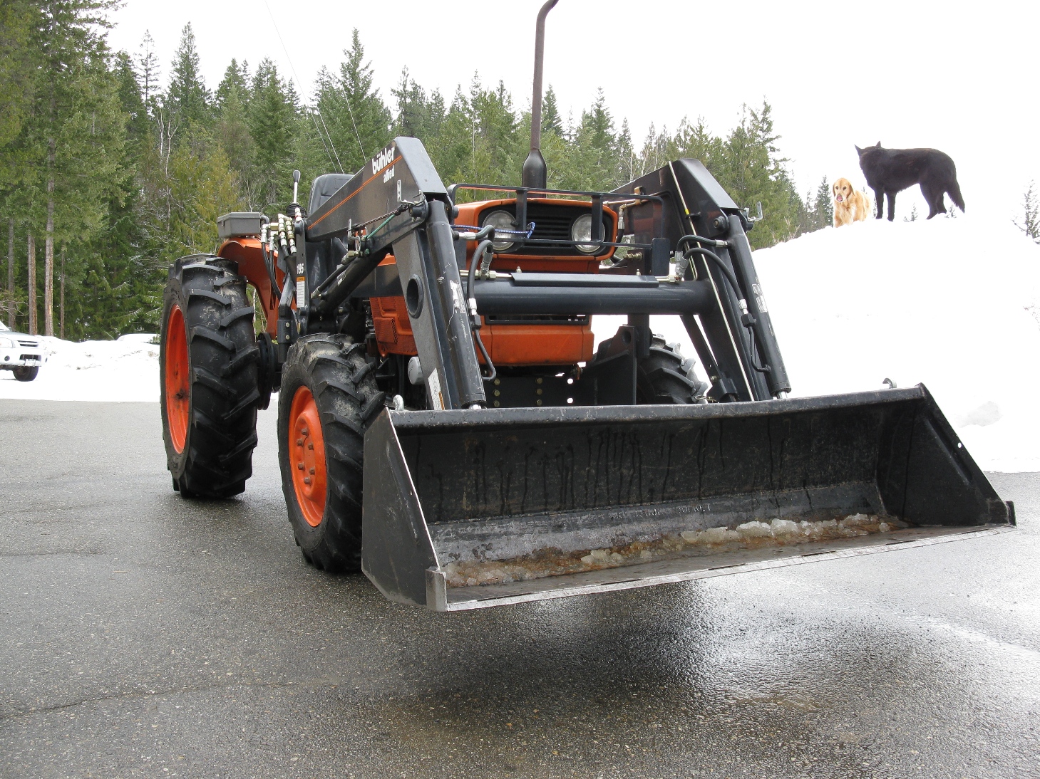

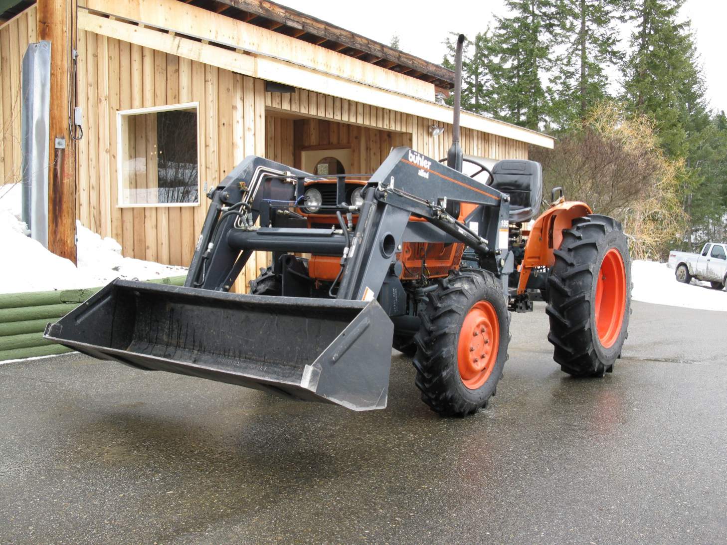

Another brand to consider is Buhler Allied. I added one to my previous tractor, a 1981 Kubota L275DT. It was a good loader. Photos attached:
