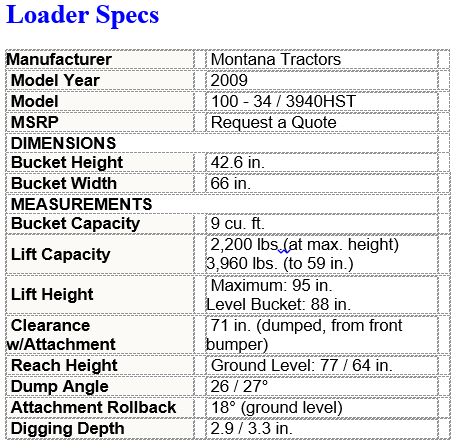

Hey everybody, as the title suggests I am looking for loader specs, specifically for the R4944 and 3940. Tractordata has nothing and I have been unable to turn up anything on Google. Any help would be greatly appreciated.
   / Can't find Montana loader specs anywhere. #2
I copied the specs when I bought my 3940..
Hey MWB, thanks for the reply! That is actually really stout.
