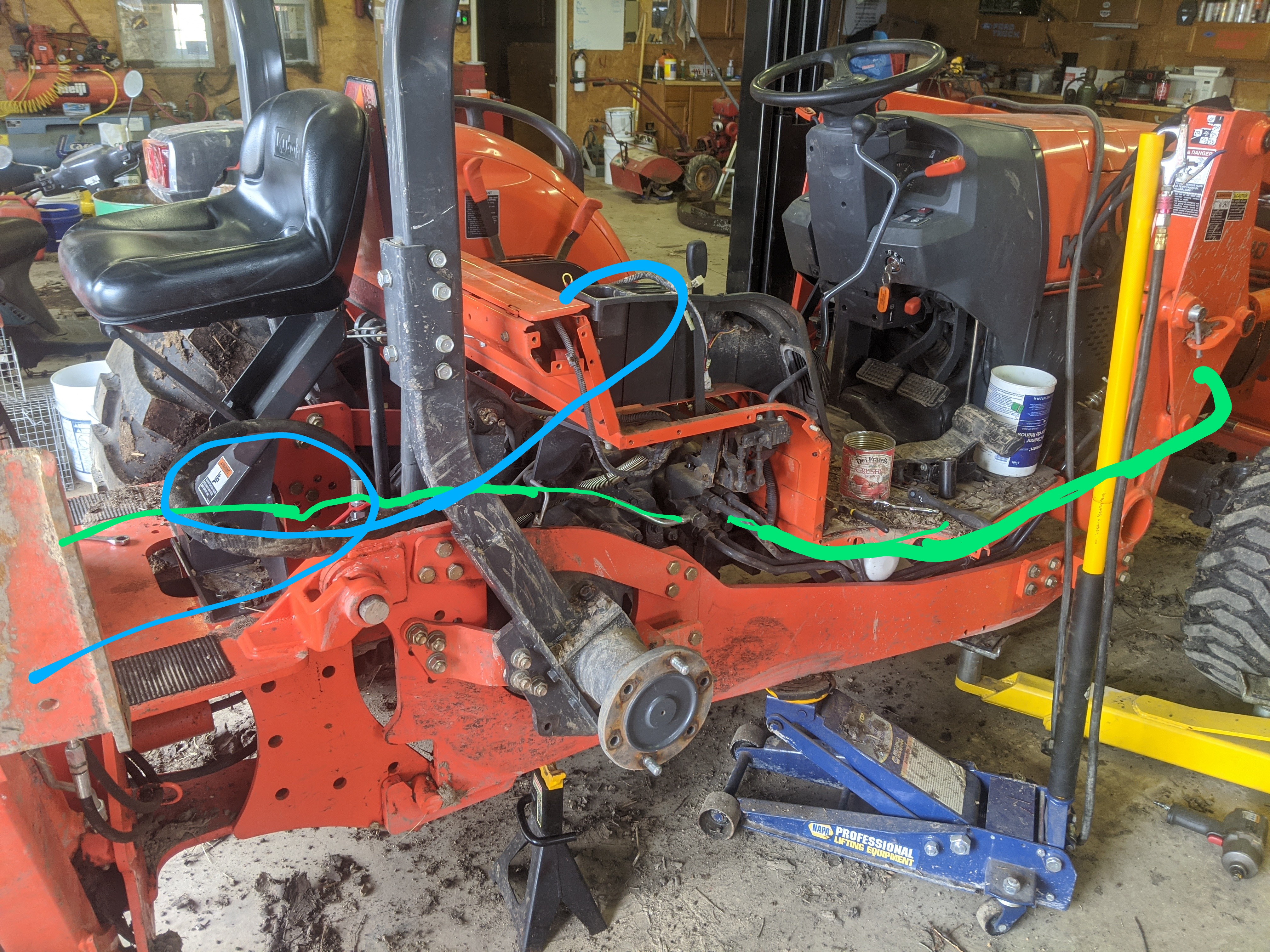

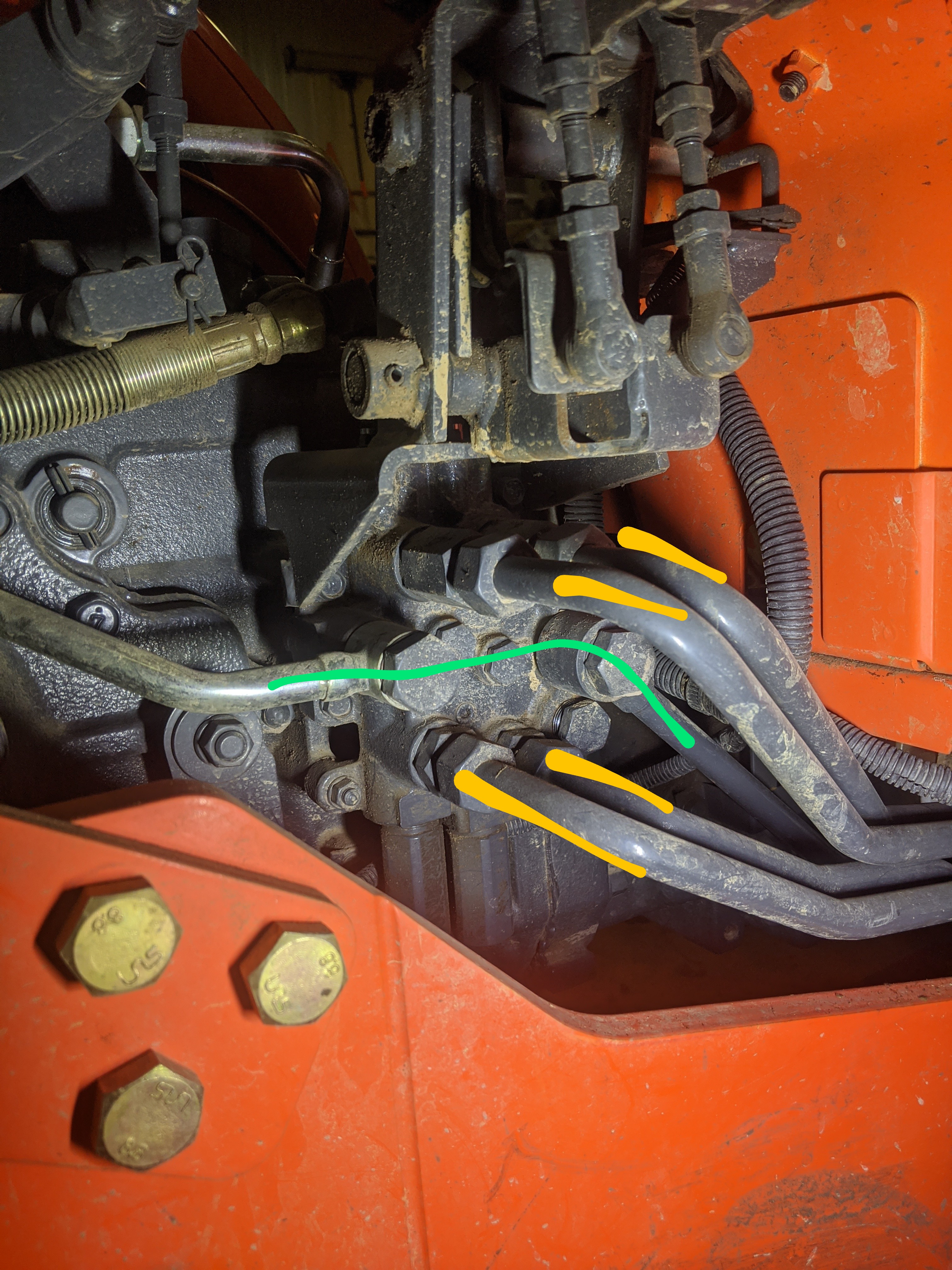

I'm moving towards figuring out things so I can self install a valve stack on my Kubota L4240 for all kinds of fun things like a couple remotes and top and tilt. I believe I got the PB lines located but cannot figure out tank return. Since I have a dealer installed backhoe BH-92 I started there. The lines that go to that are BP. Starting at my pump, one goes back through the loader valve and to the backhoe valve (green). Then it goes out of the backhoe and to underneath the operators seat (blue). Pardon my fine art here but can someone help me locate a tank return? And maybe confirm I'm looking at the PB correctly.

A couple more thoughts. On the back of the tractor is a QD with a hose plugged in. That is where the BH plugs in. I have to uncouple it and then attach the BH to the hose and QD. In the manual it says do no start up tractor without that hose either connected to the BH or plugged back in to the tractor QD. So I know that it has fluid moving through it anytime the tractor is running and it's important. So it dawned on me that it was PB. This is what got me thinking the green to blue line was just a PB loop. But I just had another thought. Maybe the one coming from the loader valve is PB and it goes into the BH valve. But the one coming out of the BH valve is not PB, that's actually just the return line and it then dumps under the operators seat. Is that how it would work? Could that be how the BH valve work? PB in and then 1 line out to tank? But if that's the way it works, then it begs another question. How is the 3pt hydraulics fed? Maybe that line under the seat is PB and that is the feed on the 3pt. Which would bring me back to trying to find the return line.

Yes, you can use your backhoe loop for your valves. I do that on my MX4800. One line is the power beyond output from your loader valve and the second goes to the 3 pt hitch. The output line is power peyond going to the 3rd point, it is not the tank line. At least, that is how it is on my MX4800. However, I don't have the loader valve in the same location. Someplace, you also need a tank line from your new valves. I am unsure on your tractor where that is. Perhaps someone more familiar with your loader valve can help.
Your loader valve should have three lines on it excluding your 4 FEL lines. Power Beyond goes to your backhoe loop. One of the others is Pressure (supply) and one tank. Look on the valve for any markings that indicate function. Many valves are marked.
When you find out which is tank, figure out where it goes. You will have to Tee into that far end for your new valve. Tank can be Teed, other lines cannot.

And here's a pic of the loader valve. No tank line that I can see. Just the PB (green) running through. Right side to the pump, left side to the BH. And then the four loader lines (yellow).

My thought it the tank line is integrated into the back of loader valve I guess. Because I think that's where the tank is. Somewhere back there and under the operators chair.

Let me get this straight Aaron. That line from the backhoe that dumps to under the seat is in fact going into the tank. But it's also a pressurized line (pb). So we can't call that a "tank line". So while it's going where I wanna go (tank) it's not the like I'm looking for.
/ Can't find tank return line #10
That line is input to the 3pt. I believe it internally dumps to tank after the 3 pt. I have no experience on your loader valve, so unless you got a work shop manual or better pics of the valve, I got no idea on tank.

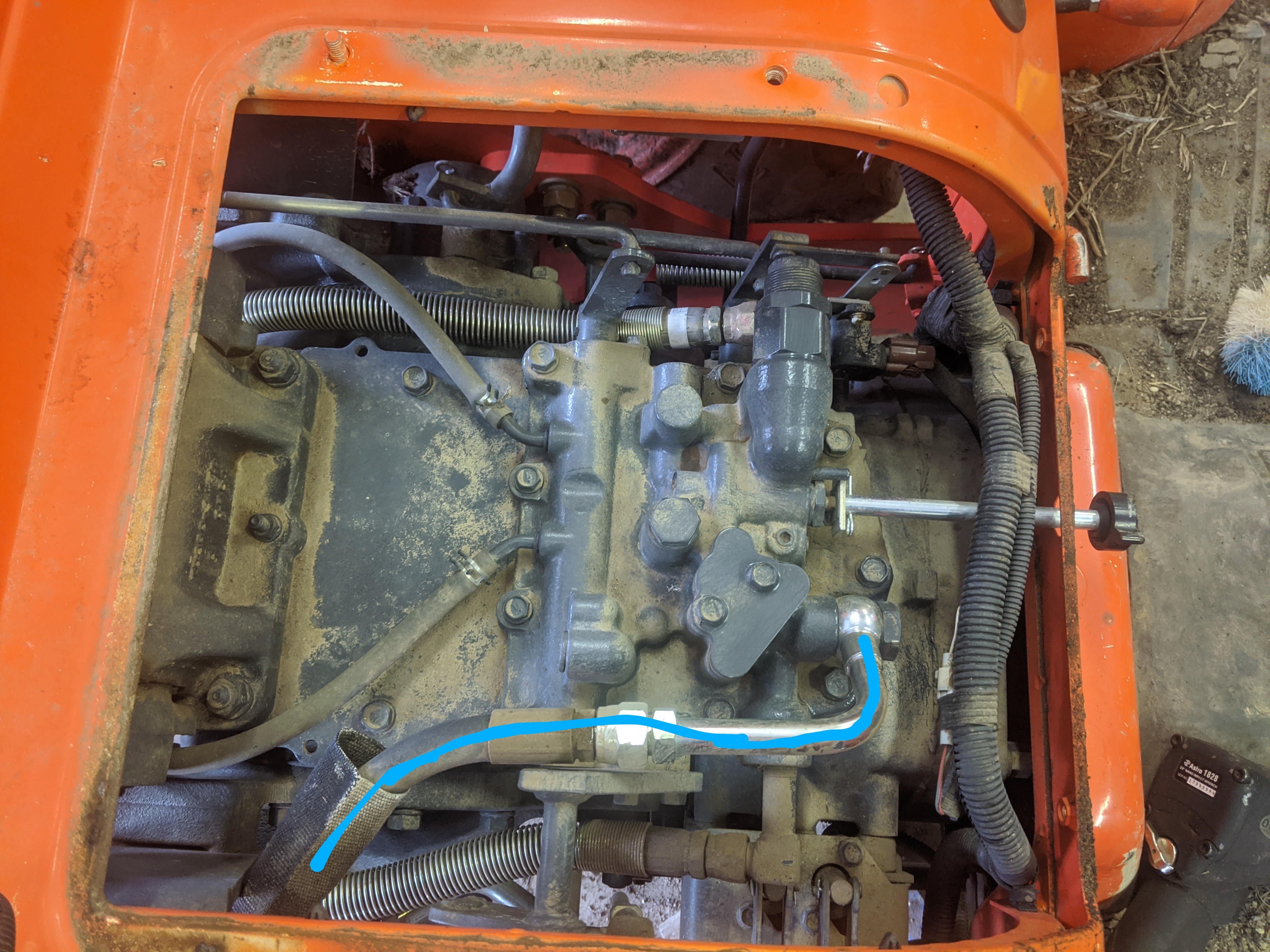

The is about all I can find for pics. A couple drawings from Kubota website of what I believe is the right valve. The spot that was curious to me in the drawing was the O ring. Wouldn't need O ring just to bolt on a valve to the side of the case. In thinking maybe that's the passage for the fluid to tank? One of the drawing shows where the pressure relief is. As for my pictures. I got a view of under the seat, a side view, and a shot from up underneath.

I just looked at the parts diagram @ messick. There is one o-ring on the back side of the valve. That is likely the tank port. Not sure what to do. Some folks have plumbed tank to the fill port.
If there is an oring under the head of the bolt that is sealing off the port on the valve, there's a good chance that that is intended to be a o ring fitting (ORB).
If you take it out and take it into a competent hydraulic shop they should be able to get you a matching fitting (Tractor Supply or a similar such store in your area may also have the fittings, but it's up to you to make sure that they fit properly).

Check out this picture. This is the o ring (#020) we're talking about. it looks to be between the valve and the tractor (transmission case maybe). But anyways, i think what it means is the there is a hole in the back of the valve (where the o ring is) and it dumps direct into the tank. there's no place to put a fitting there and tie in.

Re: Can't find tank return line L4240
Good point, I was looking at the valve backwards.
About the only option I see would be to cut line 110 in this diagram and put in a compression tee:
