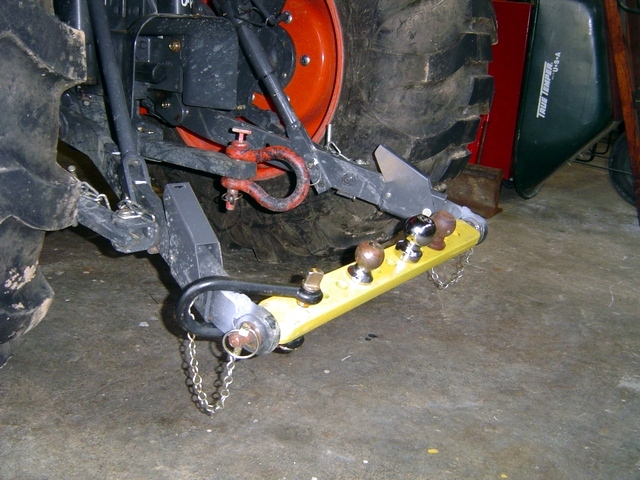

Can't find this drawbar lock.

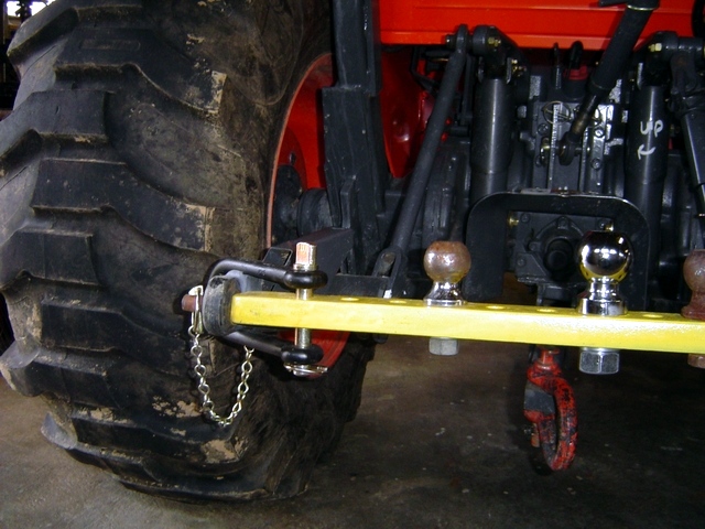

This is what I have been using...got the shackle at Northern, (Tractor Supply sells them, too). It fits over one of the 3 point arms. I welded a small bump on the 3 point arm to keep the shackle from turning off the arm. In the second pic, you can see the bump I welded on the arm to keep the shackle on. I also use the shackle for other uses, too.
