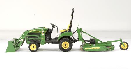

   / Cant get 410 FEL any more #9
front view, 61" bucket...
