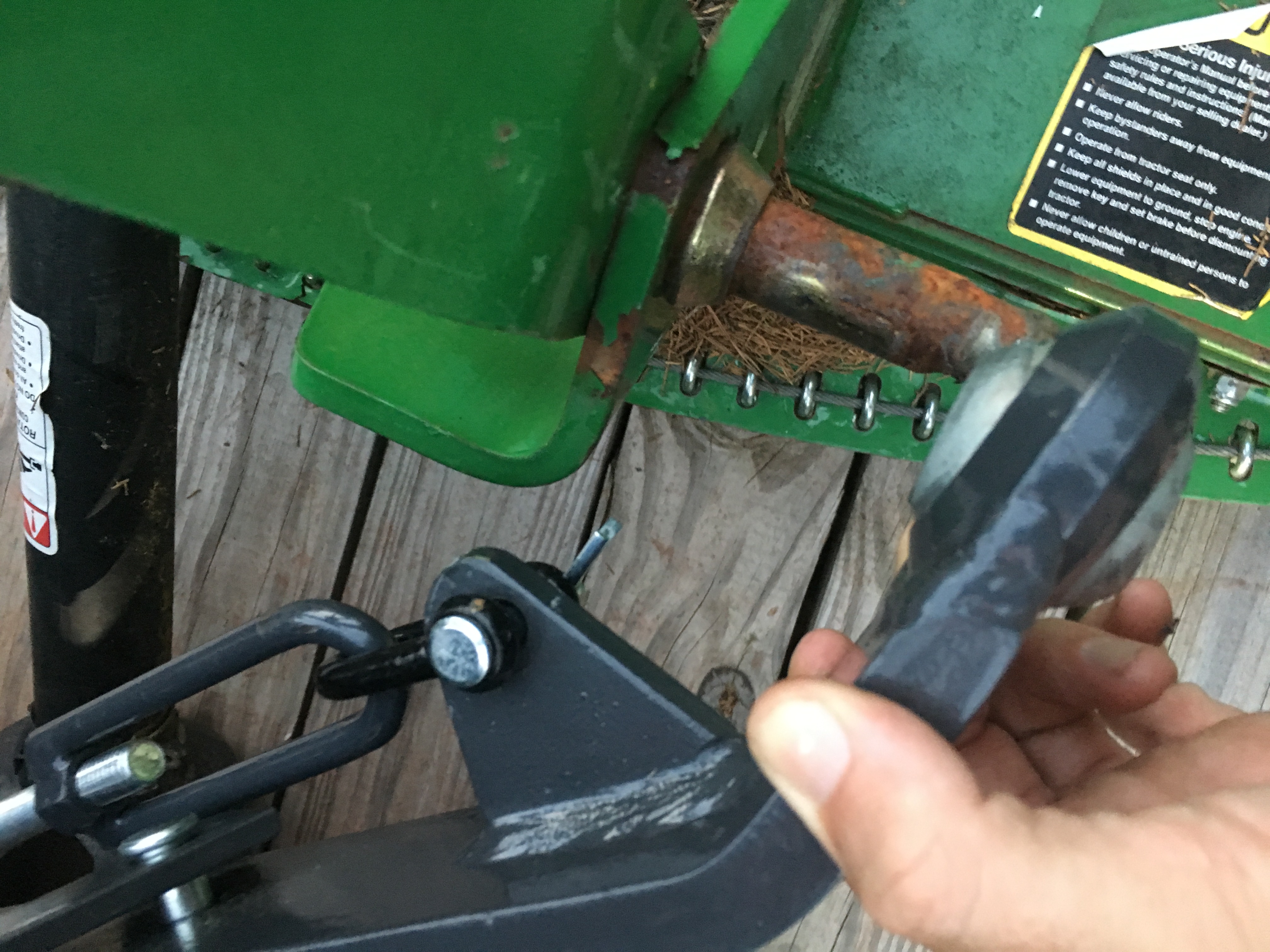

I tried and tried to hook up my new to me Frontier rotary cutter to my BX23s 3PH. Any ideas?
I loosened the 3ph arms to where they would spread apart to their maximum width. If I turn the pins inside the brackets on the frontier 2048 will not allow you to hook up that way. I just can't figure out what I need to do. The inside plate on the BX 3ph arm hits the bush hog where it will not slide over the pin.

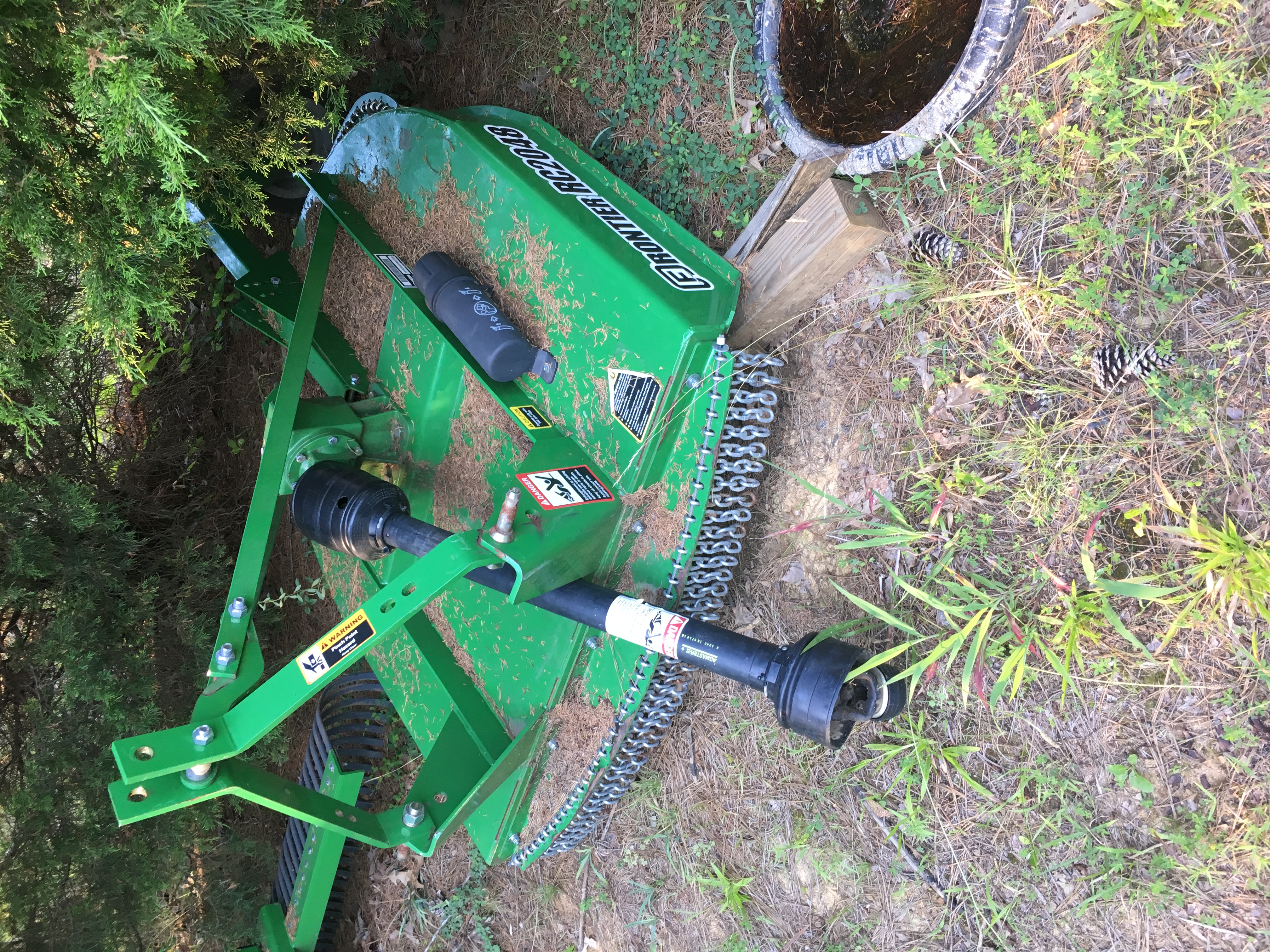

Here is a picture of the cutter.

As I understand what you are describing, you have backed up to the cutter and your arms wont spread far enough apart for each to go over the cutter hitch pins.
If you put the cutter at an angle and then slide one lower 3 pt arm over its pin, then lever the cutter square and sideways to get it moved as far as it can towards the side where the lower arm is already on the pin, then you are not trying to get as much spread in the arms. This might just give you the movement you need.
Alternatively, there are many styles of quick attach adapters for 3 pt hitches. These go unto your lower 3 pt arms and come up under the pin so you don't have to be spreading your arms past the ends of the cutter pins.

Can you totally detach the lift arms from the tractor and then slide it over the pin and re attach the arm to the tractor? Very awkward but that might take care of the spreading/interference from that inside plate. The extensions work good and that would fix it for a price. I have the Pat's and I'm very pleased with them.

Got enough pin length to cut off small amount for needed clearance?
Drill new retainer clip holes on pins for smaller clip.
If it's that close/tight, you almost may not need any pins. You can use an alternate way of securing 3pt arms like large zip ties, etc.
Just a thought and best regards for resolving your problem

Drill a new hole and move the pin forward. If I understand what you are saying is the backet that the pin is on hits your tractor. If that is the case drill a new hole and move the pin. In your case a quick hitch such as Pat's or the other will not work
