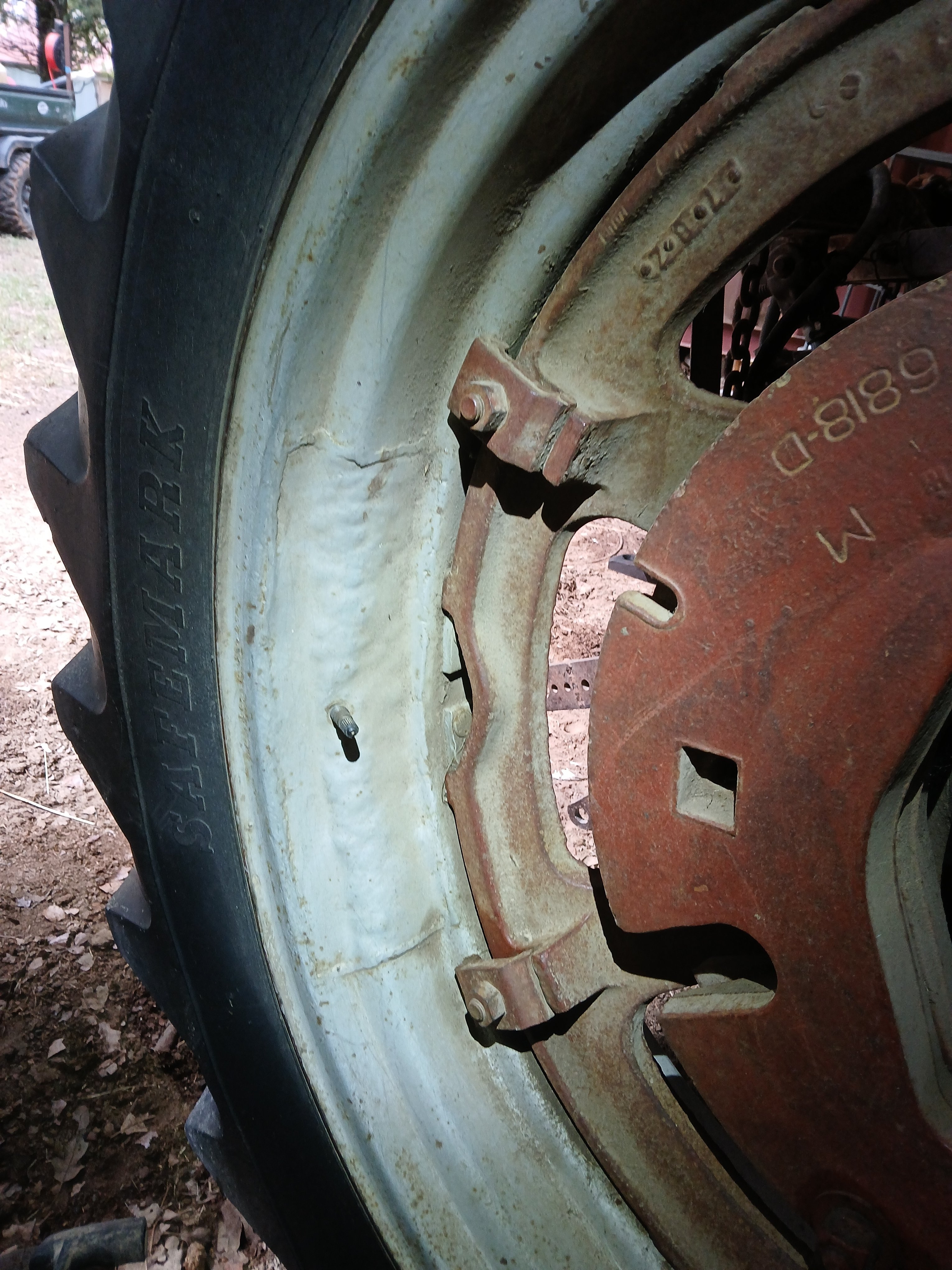

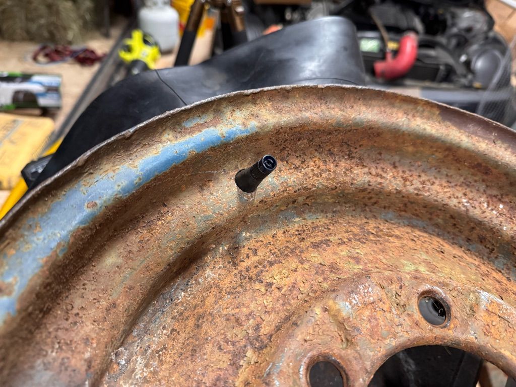

Cleaned up the inside, went to mount the tube, and it was the wrong size... Completely ruined my motivation for the evening.
   / Can't just retube that #37

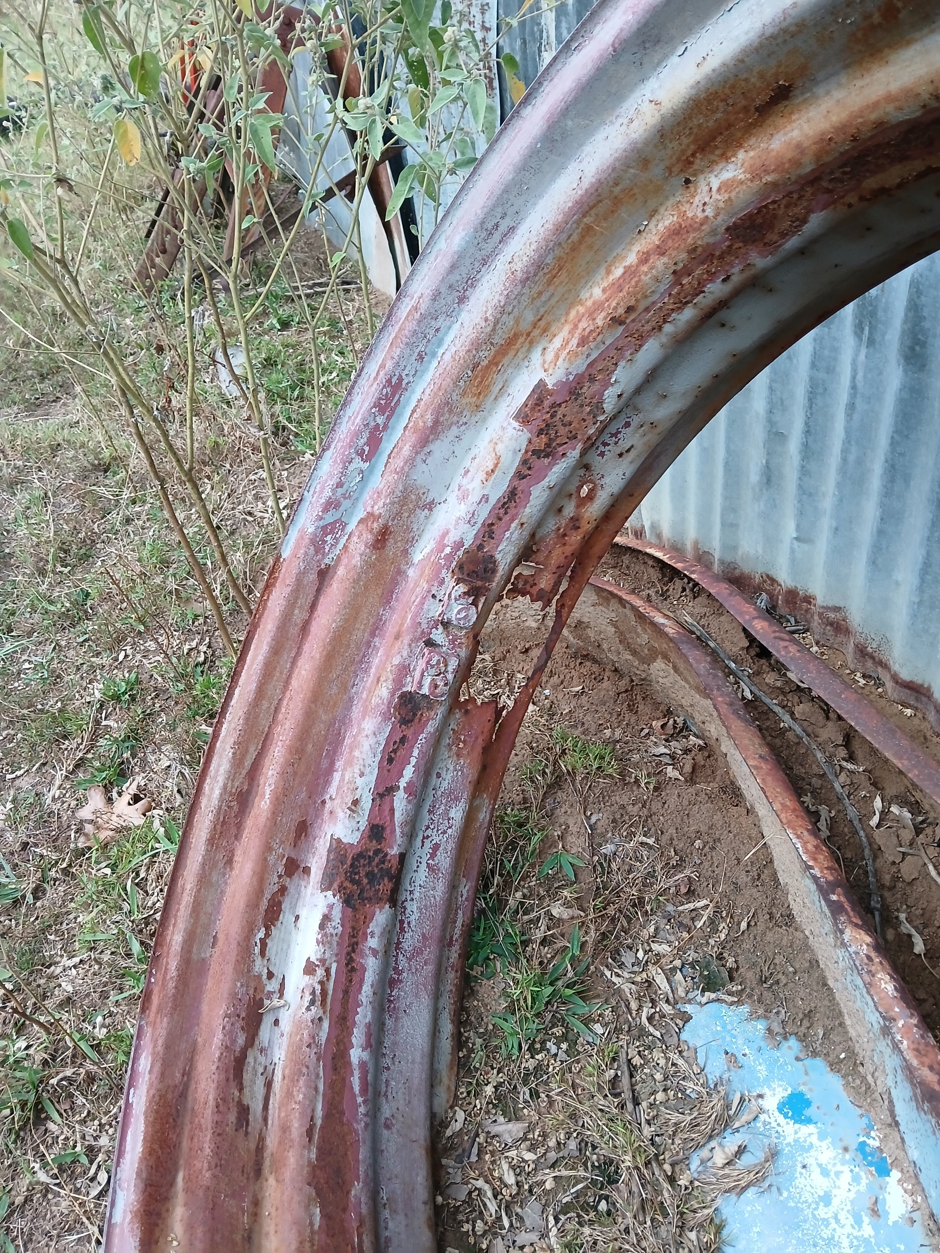

Went through hell getting the tire off, but I got it off. Wire wheel'd the whole thing. All the metal is in good shape, it's just that spot. I think water got in through the valve stem and just rotted that specific spot.
I have seen that on a number of rear wheels. The generations before me used corrosive additives to keep water (weight) from freezing in the tubes. Get a puncture in the tube and it begins to take its toll on metal.

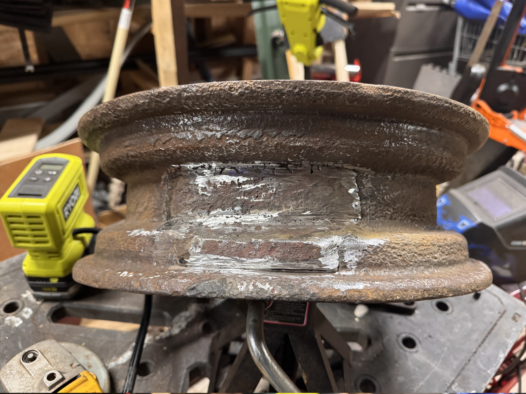

Wheel's repaired, new tube hole drilled, deburred, and tapered, new tube. I bought the HF tire changer to get the tire back on. Everyone on youtube is dealing with nice fresh rubbery tires that stretch. This old tire does not want to stretch. Plus it's quite cold out.
I got 80% on and lost it, and gave up for the night.
   / Can't just retube that #39
You need to keep the tire pushed down off the lip of the wheel so it’s in the middle section of the wheel. That way it can move quite a bit from side to side and allows you to roll the bead over the wheel rim without actually stretching the tire.
You need a helper or a clamp or something to push the tire down at about the 6 o-clock position. If it’s down and off the edge of the rim you’ll be able to roll the rest of it into place.
Wish I could explain it better. But the tire bead can’t be in its final position until the tire is completely mounted. They really don’t stretch overall. Need to allow the whole tire to move directionally as you work it onto the rim. The bead OPPOSITE where you're prying can't be "set" -- must be pushed down on the wheel where the diameter of the rim is much less and the tire can move in the direction that you're prying.
Edit -- In other words, pay close attention to the opposite side from wherever you're prying. In order to work the tire bead over the edge and onto the rim, you have to keep the OPPOSITE side pushed down into the belly of the wheel so the whole tire can shift your direction a bit and allow it to roll onto the rim.
I'm sure you're using a lot of lube. That's also key.
Nice job on a wheel rim that I would have scrapped!
