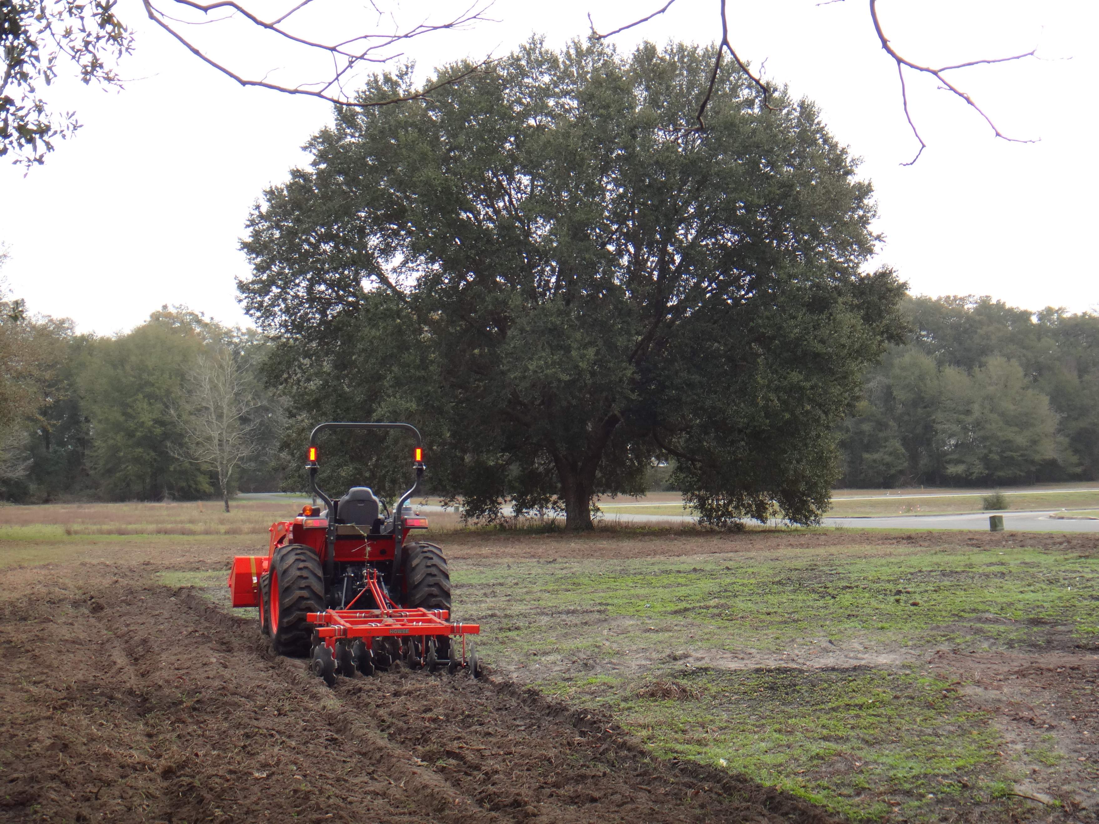

My Kubota L3560/HST is 5,400 pounds with air filled R4/industrial tires.
I work in an upscale residential development. I run over lawns in 2-WD mode daily, without creating damage. Our soil is sandy-loam. It drains perfectly. Never mud.

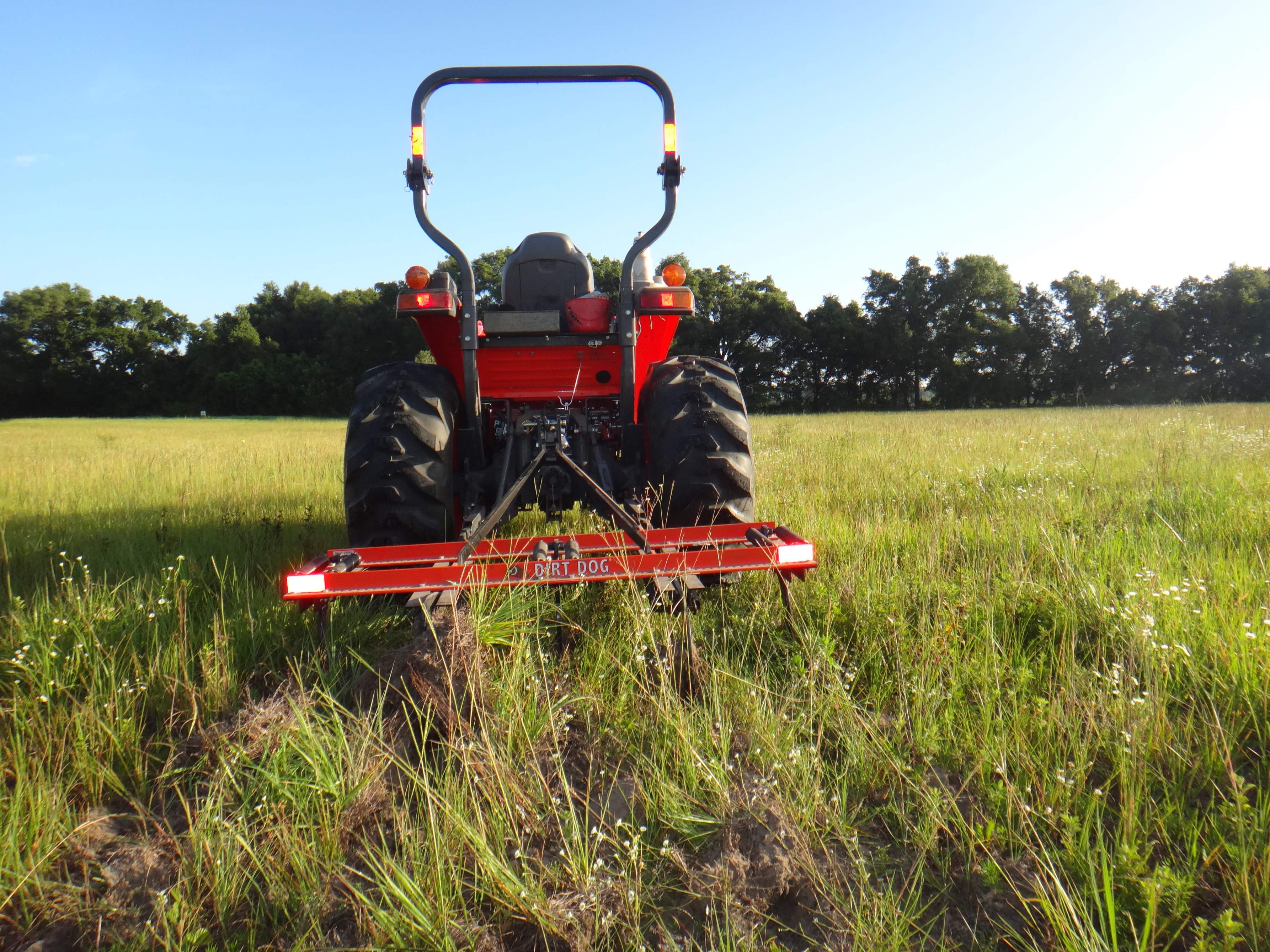

You can always add steel or rubber chains to R4 tires for additional traction in your food plots. My 5,400 pound tractor has only 37-horsepower. My R4s never lose traction though I pull a two bottom 12" Moldboard Plow and a 960 pound Tufline Tandem Disc Harrow with 20" diameter pans.
Had I a 50-horsepower to 60-horsepower engine in my tractor traction would be less certain with considerable throttle. So tractor horsepower indirectly effects tractor traction.
