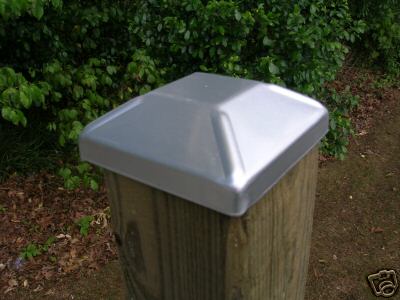

I have been racking my brain and need help. I want to place a cap of some type over the top of my wood fence posts to keep them from rotting. The caps need to be able to slip over a wood post which is about 5" wide across the top and only be about 1" - 2" tall. I would like to be able to nail through the side of the cap to keep it on the top of the post. Help?????

Cans work fine, even plastic ones. You can also cut thin sheet metal to size, snip a couple of places so it will fold over the edge and nail it with roofing nails.
   / Caps for tops of wood posts???? #3
Aluminum flashing cut to a disk and formed over the top and a couple of aluminum nails on the sides to hold it there.

I would get some PVC siding and just cut to fit with snips. It should last longer than something that is not UV protected.

I used a lot of these on my horse fence 4x4 posts some 20 years ago. I have NEVER had to replace a post.
I think Home Depot sells them and they do come in other sizes. They have a small hole in the top for a nail, I used the roofing nails with the neoprene washers. A $1 something each.
