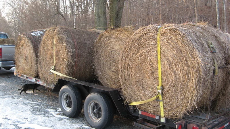

I can haul upto 11 4x5 bales on my 20ft trailer. I normally haul 7 to 8 for myself since I have only a IH766 or JD4430 with a 3 point sprear to load at the farm. The 766 three point goes high enough to get them on my trailer. The one between the fenders I roll forward. I have double stacked with the
Kioti loader and it handled it fine. I am trying to keep the Kioti home for the winter to clear snow and feed the bales.
If I do eight I have to have the third row back bales set on the fenders and tilt into each other like Robert_in_NY stated earlier. The pics below show a load of seven bales.
I always tie them down just in case. I even tie down my hay wagons of small squares. Cargo straps are easy to use and you can get a load tied down tight in no time.
Makes towing hay a whole lot less stressful.:)
