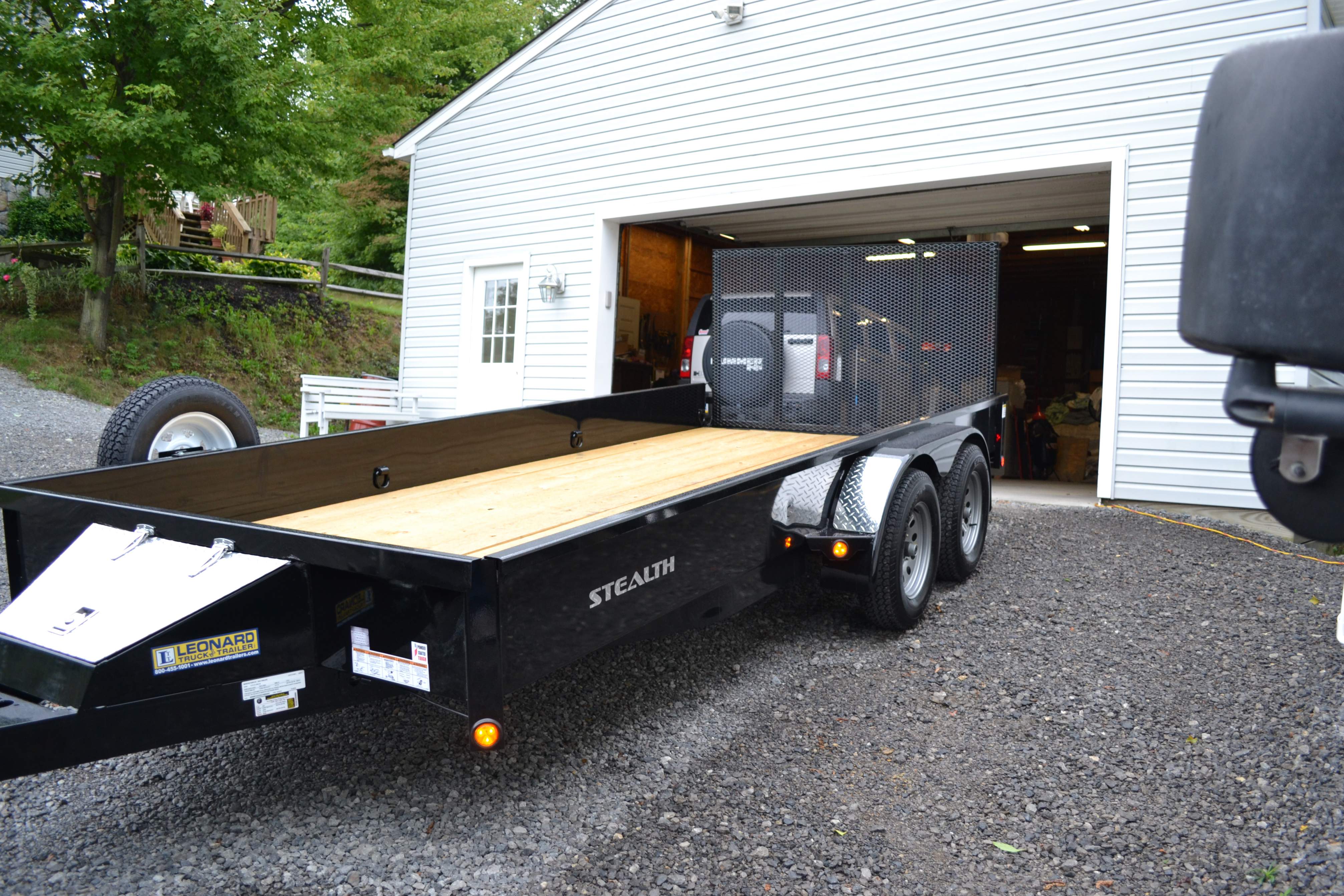

Tough decisions...
I was pretty well set on a Big Tex 60CH car hauler. Every time I'm about there I get to thinking about another facet of what I might want and I start looking at other options. Passed a trailer store yesterday that I didn't know carried the type of trailers I'm looking for. Ended up going back today when they were open. They carry Belmont and Currahee. The Belmonts seem really nice, maybe some of the nicest trailers I've looked at actually. They're also a little pricey, and the bigger issue for me with my tow vehicle being a Tacoma is that they're kind of heavy.
They had a Currahee landscape trailer that I looked at for quite a while. There were some things I didn't care for, but some things I did. For example I originally was hesitant to get a gate in case I ever wanted to haul something just a little bit too long. This gate pops right off without tools or even removing any pins. Just lift up on the one end, sliding the pivot pin on one side through a groove and out of the mount, then slide the other pivot pin straight out of the mount. I didn't care for the way it was wired, but honestly I haven't cared for the wiring on most of the trailers I've looked at with the exception of the Belmont and if I remember correctly the Sure Trac didn't seem so bad compared to many. Weight was 1600# with a GVWR of 7000#. Ended up not picking it up today after much debate, and on the way home I realized that the trailer actually didn't have a good way to chain down a tractor. There are no stake pockets, no D-rings. You could hook a chain on the bottom of an angle iron upright, but there would be no way to loop the chain through or run it in such a way that the hook is hooked downward. I could always add stake pockets myself but I don't really want to have to.
Been looking for a Big Tex 60SP but unfortunately I can't find one anywhere around here. That's the landscape equivalent of the 60CH. GVWR 6000# with a trailer weight of I believe 1650#.
   / Car hauler vs landscape utility
#19
For those with landscape trailers, do you have stake pockets? And if not, how are you attaching chains if chaining down a tractor?
Looking at landscapes again, I'm noticing a lot of them don't have stake pockets and I'm not seeing a good way to attach a chain with the hook pointed down, unless the uprights are strong enough for attaching a chain, but I figure they probably would have too much flex not to mention being a little higher than I'd want.
