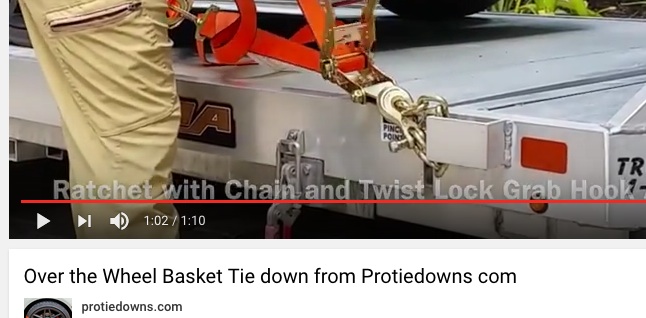

Watch to the end of the video, at the end he shows using a ratchet that has a chain going through the front stake pocket.
Aaron Z

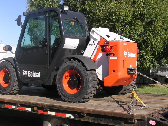

Yes, but hooking the hook back to the chain is asking for trouble. He should drop the chain through then put the hook on the top of the stake pocket.
   / Car trailer lock down system #13
Like this:

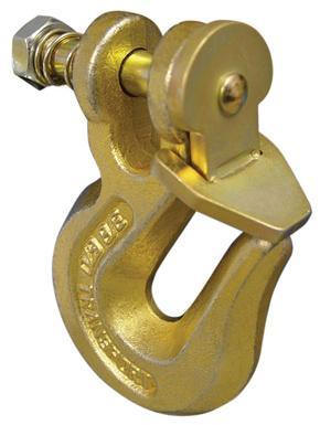

He used a locking grab hook. Probably like this. It may be safer than the hook on the pocket method.
