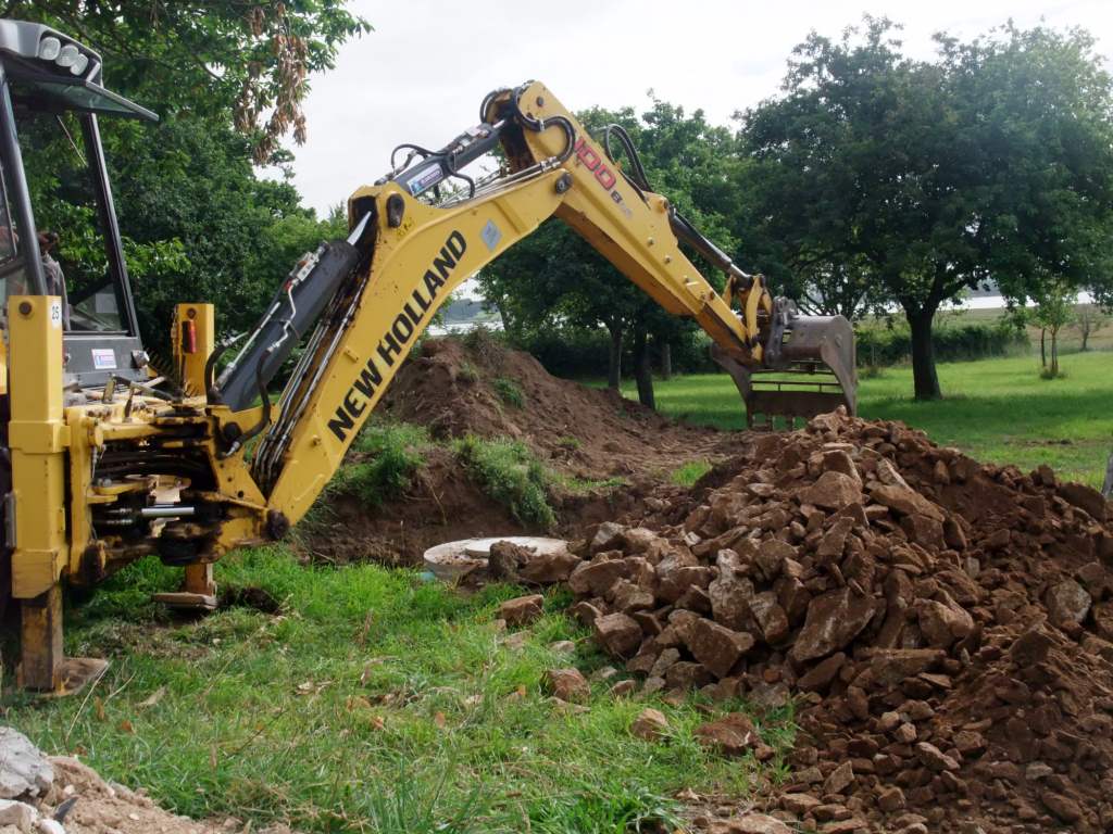

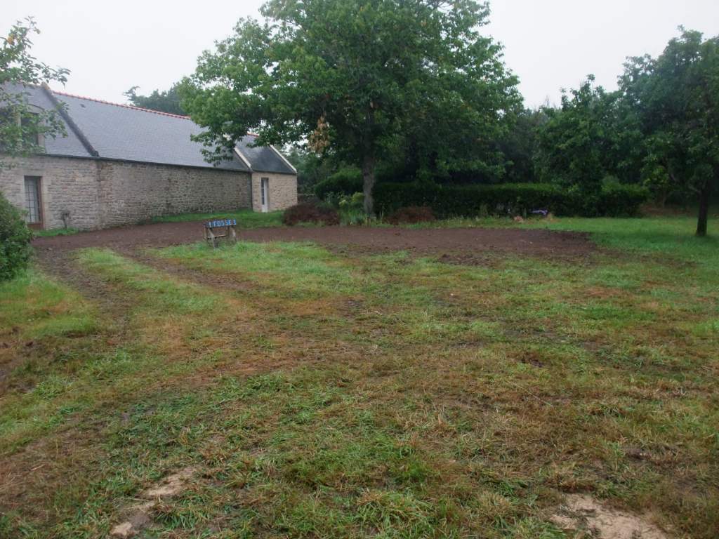

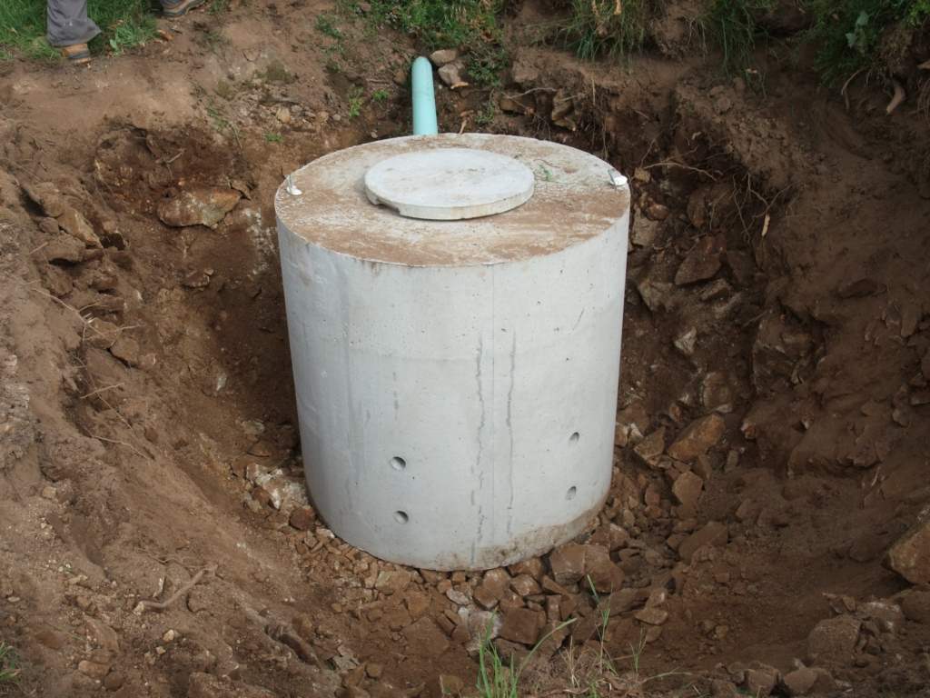

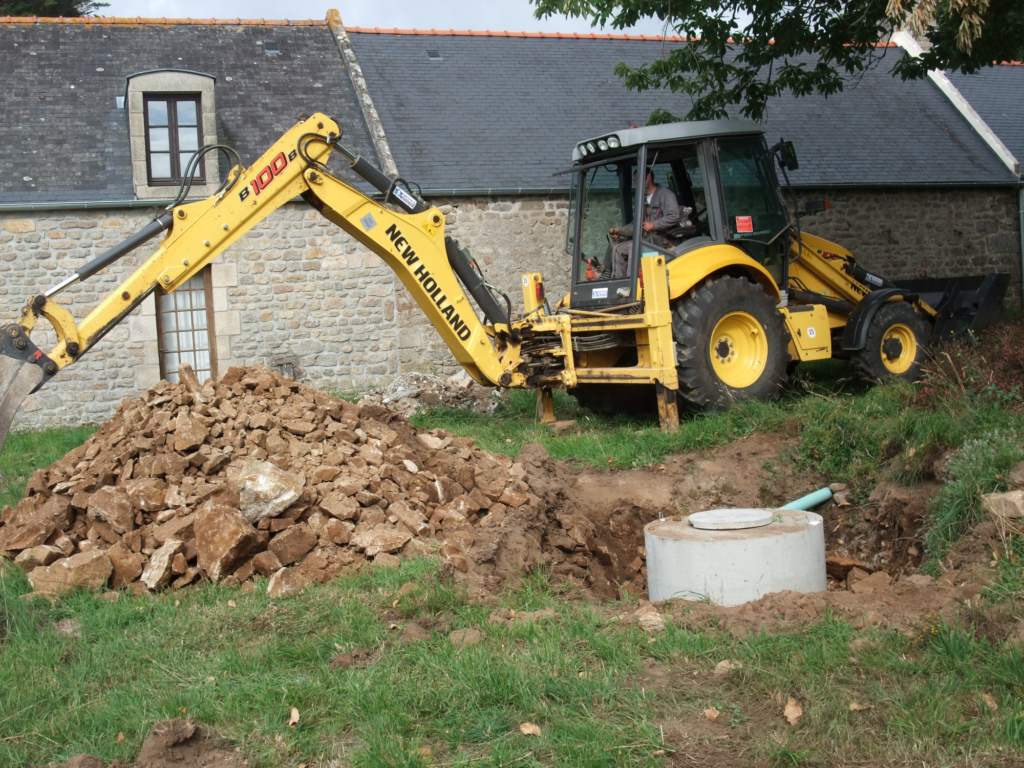

for those of you that have the grey water go "elsewhere," where does it go.
This is where the grey water goes at my place. Two of these, one on each side of the house.

The home I lived at in Austria had two of these also... one was to capture roof runoff and the other grey water... I think just about every home had the same.

Holy cow!!!:shocked: Philippe, is all your soil that rocky? You'll never have to worry about your houses foundation if it sits in rock like that. They have another name for soil like that here in Texas. It's called a rock quarry.:D
