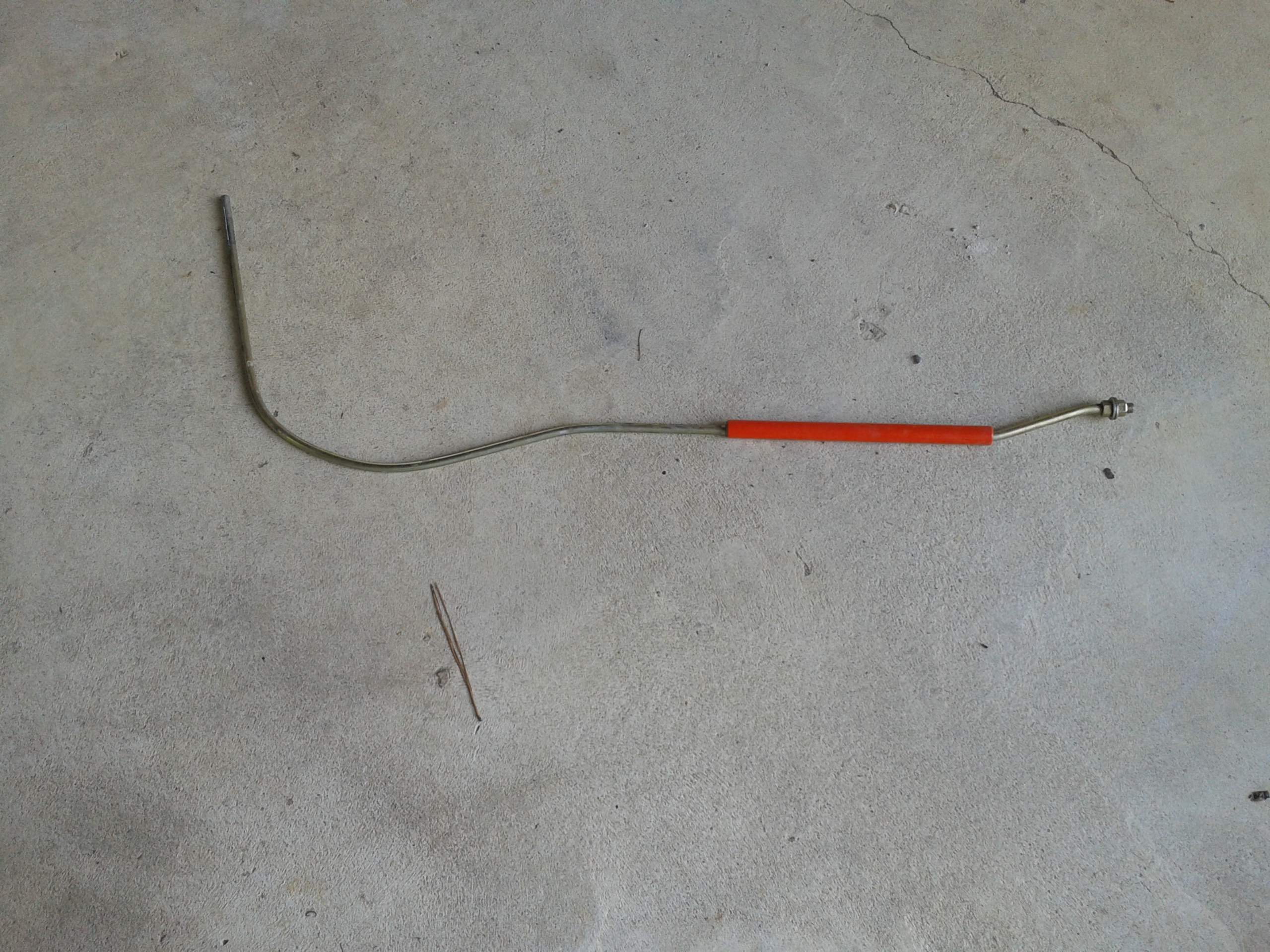

I'll bet many of you know what this used to be.
What should I do with it now?

OK, David, I give up. What is (was) it?

Well I can tell you what I did with mine:
I carefully straightned it back straight as an arrow.. I then took a 2 lb hammer to the bracket which was bent down, and got it back square. I then screwed the pipe lower guide back in and used some blue locktight on the threads, and after all was tight, I took an automatic center punch and put 3 dimples in the joint between the upper and lower guides.. That sucker is not going to unscrew again!

David....Looks like a fuel line ? hard to tell...if so , did it get hooked on something and pull off ?
You guys don't own a Kioti.:) this seems to be a common problem here lately with the DK series of Kioti machines.. I would tell you what it is, but I think David wants to have some more fun with the guessing game. But if you had a Kioti DK.. you would recognize it.. It is not critical to its operation but it can come in handy.

Gotta keep those brackets tight on those machines.

Looks like the bucket level indicator. The one on my tractor is always coming loose and I have to re-adjust it. Guess it is time for some Loctite.

I'm guessing bucket position indicator?

My DK is a older, so its a little differant.
I just bought a peice of 5/16" rod for a few bucks and made a new one.
