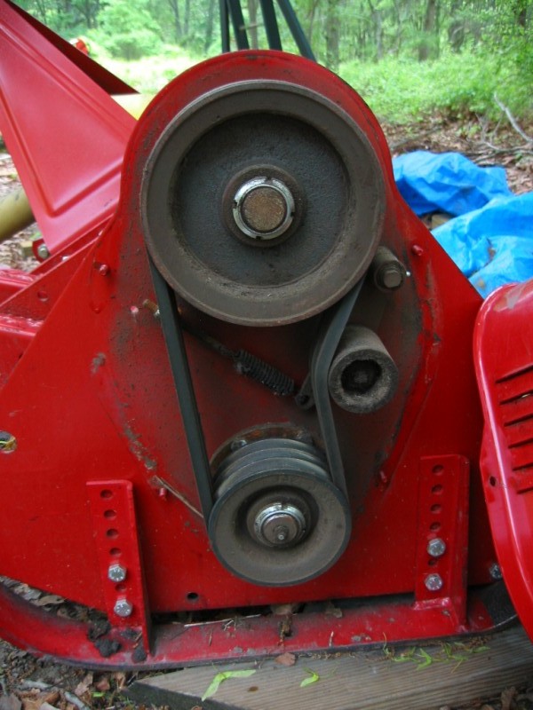

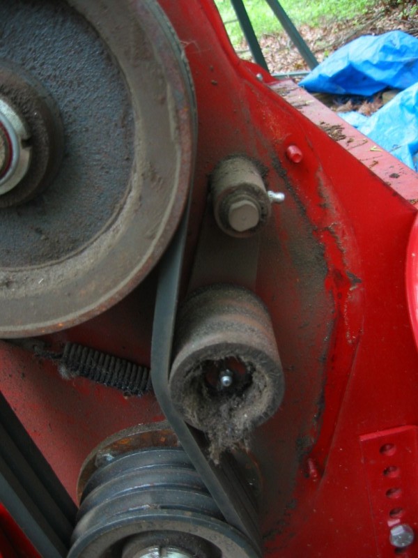

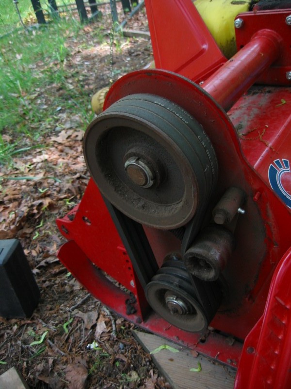

I used my TM1900 today for two mowing jobs. One was light, just mowed the grass around the house for 30 minutes and the other was tough, mowed about three acres of three foot grass and briar. I checked the heat of the belt cover after mowing around the house and I could keep my hand on the cover for about 5 seconds before it was too uncomfortable. After the tougher mowing job I could only keep my hand on the cover for a couple of seconds. The bearing cover on the other side of the mower (non powered side) was barely warm after the big job.
I haven't rechecked the belt tensioner but will do so tomorrow and see if IronHorse's idea is practical (for me).
